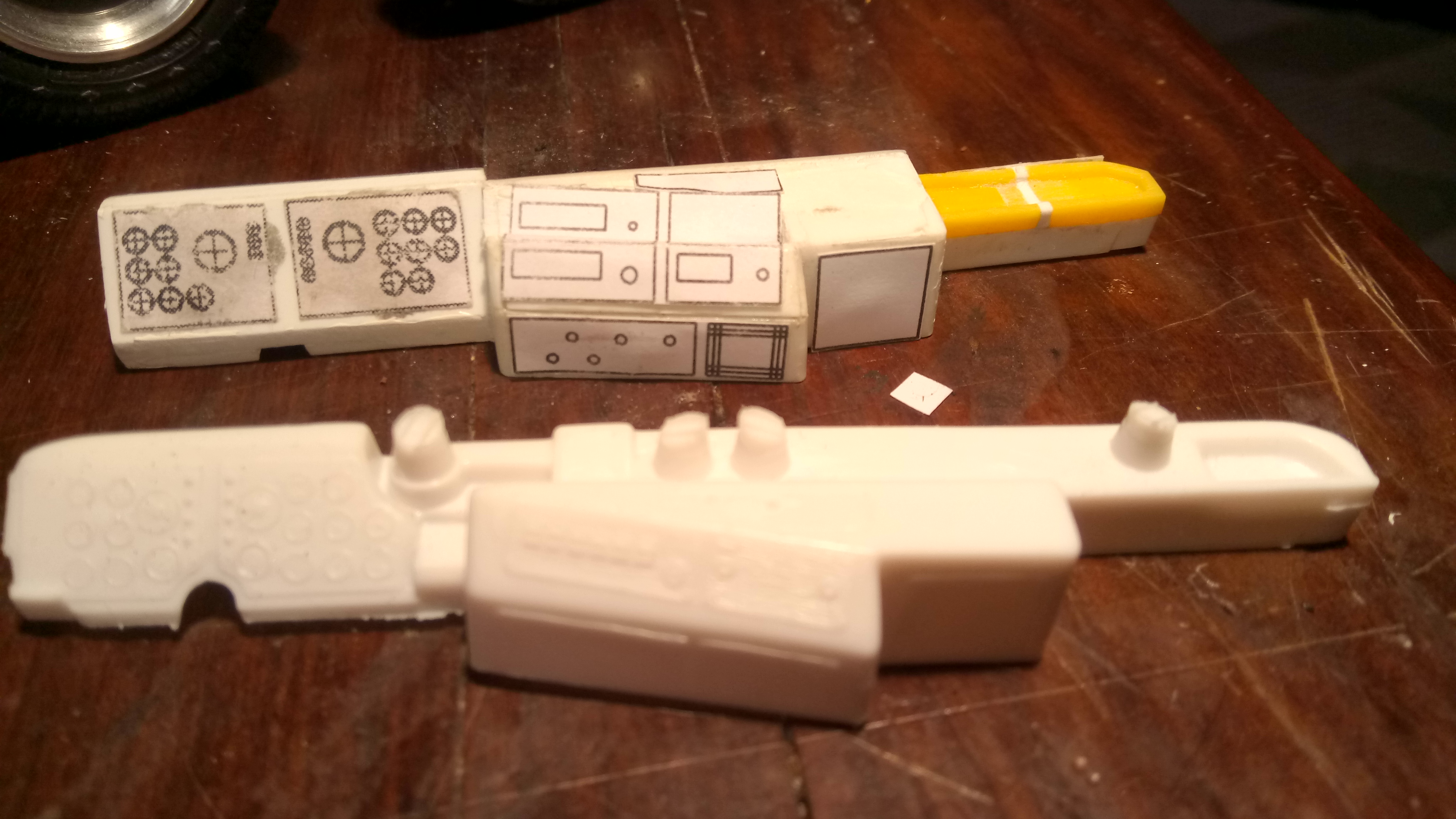

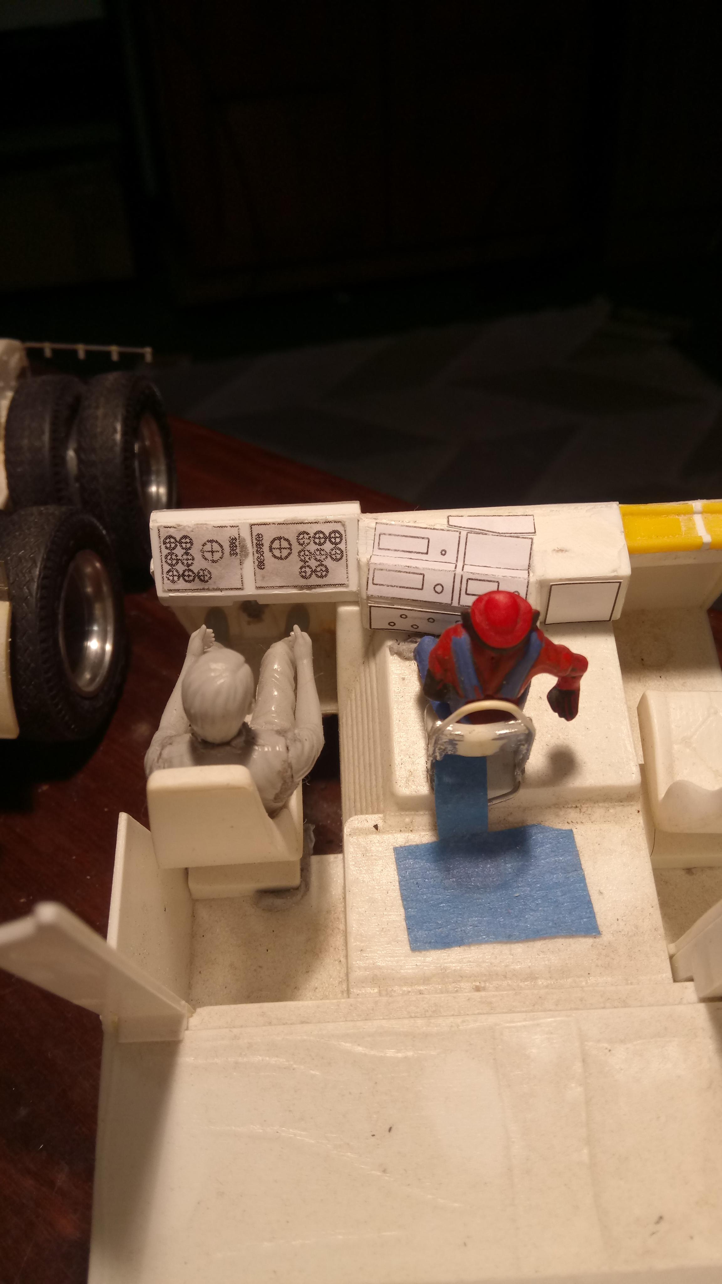

Small update. My friend Peter cad designed all the instrument panels for the dash, he also machined the mirrors, headlight surrounds, grill & bumper. He showed me how to make the spotlights on the lathe. I have contacted Jan @ CTM to see if he will do the instrument panels, I hoping. The dash is available to be cast by? The only kit chrome left is the roof lights so if anyone knows where I might acquire some metal/aluminium lights from, please let me know or I may have to learn to cast them myself. Yes, this is the AMT kit & I have opened the doors & I now have to rebuild the interior. I may get this finished yet.
Just had the panels cad designed, next glue them onto some aluminium sheet then onto cutting up a couple of CTM instrument panels for the switches, ignition switch, etc, this is where it gets expensive, hopefully Jan will contact me be I start cutting & hacking & tell me that he's going to go ahead & make the needed panels.

So many excellent ideas. Thank you all very much. Unfortunately measurements are not available at present. 3D printing would certainly be easier if I had the patience & know how. Brass is the way I have thought of, photo etch top on a block would also work but alias, no photo etch making skills. I have a friend who is able to cad design the instrument panels which I was going to glue to aluminium plate & cut & drill, add wood grain decal & Scale Production "O's" for instrument bezels. Need to get the instruments reduced to scale also. I have sent a email to Jan @ CTM this evening to see if he may now be interested in doing the instrument panels now that someone is doing a dash, we'll what happens, he may be able to do photo etch airvent faces. This is where I'm up to at present. & this is my entire model collection these days so there's not much to savage parts from. -
A teaser Got to get hold of my friend to cad the rest of the panels, they'll be glued to aluminium plate & cut & drilled. Just got a whole bunch of "O's" from scale productions to do the instrument bezels. Then it's a case of cutting up CTM's panels to get the need switches & such for the rest of the panels.
