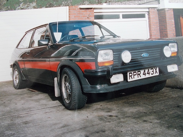

dublin boy Posted March 27, 2015 Posted March 27, 2015 I had a Supersport Fiesta back in the day, 1300 Kent engine. It was a teaser for the XR2 which you guys didn't get either.

Ace-Garageguy Posted March 27, 2015 Posted March 27, 2015 I had a Supersport Fiesta back in the day, 1300 Kent engine. It was a teaser for the XR2 which you guys didn't get either. The XR2 was a new one on me. I just looked it up...cool little car. I had no idea. You know, now I think about it, what a fine pair of sleepers you could build with a Pinto and a Fiesta.
dublin boy Posted March 27, 2015 Posted March 27, 2015 (edited) I had about 95 hp in the Supersport, it was a bit of an animal for a bored out 1300, lumpy camshaft, twin 40's, much faster than a 1600 XR2. 130hp in a Mk1 Fiesta would be wild, they weigh about 700 and something kg I've seen one converted to RWD, it's the only way to get a Pinto in it! The later CVH engine has been used in them from more modern Turbo versions of the Escort with a five speed box that means cutting the chassis rails which is difficult. Edited March 27, 2015 by dublin boy

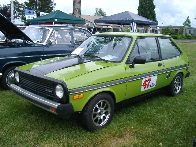

Mike_G Posted March 28, 2015 Posted March 28, 2015 Most excellent. I sold a not-too-bad Fiesta I'd bought for $100 (sold for $250) a few years back, had been thinking of much the same thing. Seemed like it would be fun to smoke some of the fart-can boys with a ratty old Fiesta. Should make a great little autocrosser too. Mine is all set up for autocrossing with Bilsteins, heavier 20mm lowering springs, urethane bushings, lowered motor, 19mm rear swaybar, XR2 gears in 3rd and 4th (closer ratio) XR2 front tie-bar brackets, Bosch distributor, Formula Ford head, Tri-Y header, XR2 intake and carb, lightened rods, heavy duty clutch, oil windage tray and baffled oil pan to avoid oil starvation on hard left turns, battery relocated to the right rear- lotsa tricks! It did real well in local autocross events, I took 3rd for the season my second year against a bunch of much newer, more powerful cars.
Mike_G Posted March 28, 2015 Posted March 28, 2015 I had a Supersport Fiesta back in the day, 1300 Kent engine. It was a teaser for the XR2 which you guys didn't get either. Nice car, I love those supersport wheels. Needs round headlights Here's my '80 "Sport" at the same Ford meet as the Escort photo was taken at:
