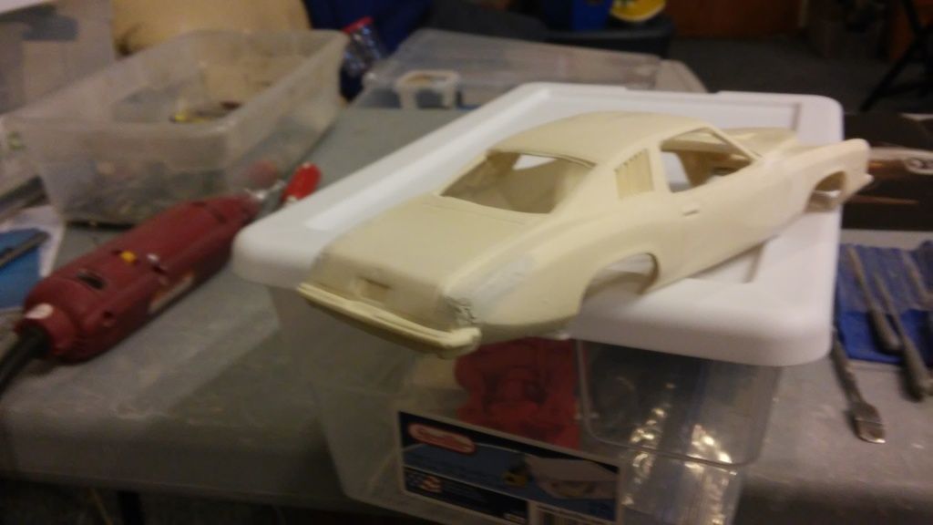

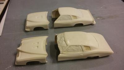

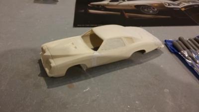

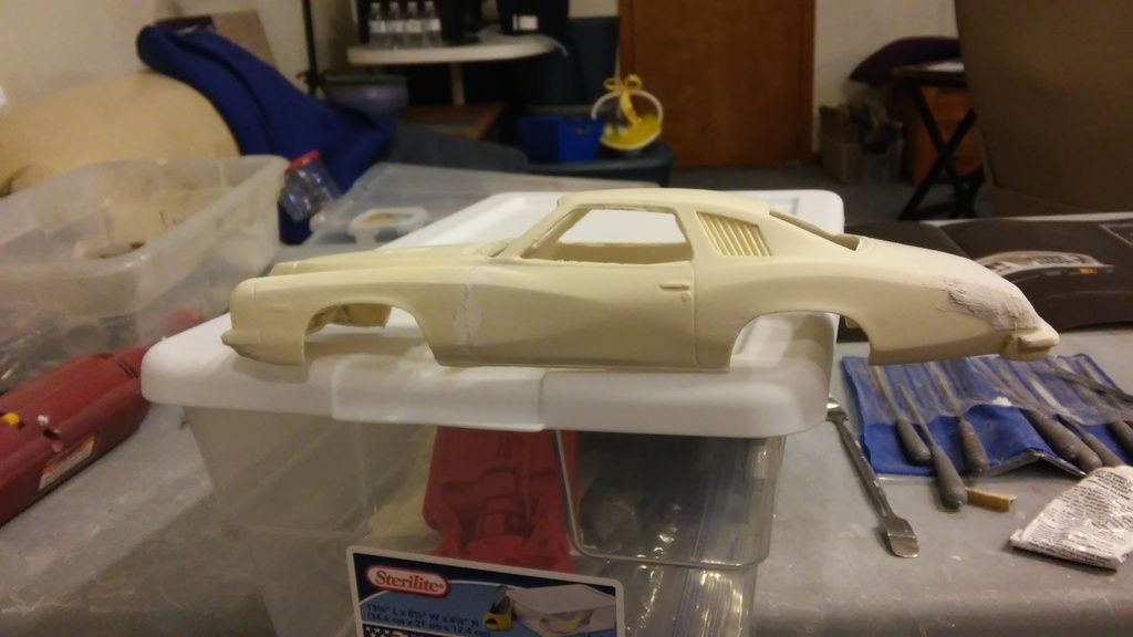

DoctorLarry Posted April 10, 2015 Posted April 10, 2015 After completing a 1973 Grand Am and GTO front end, I took that basic master and created a 1977 Pontiac Can Am. With nothing to do at the moment, I thought I would take both of those and create a 1974/5 Grand Am. The later Grand Am's had a different quarter panel and a trunk that was more raised; this was the same basic rear body shape as the Can Am. However, the upper nose was similar to the 73 Grand Am with the exception of six grille "gills" rather than three per side. The grille bars also ran horizontally rather than vertically in the 74/75. The lower valence in the front was also different, being more like the lower front bumper of the Can Am. I took two of my own castings and cut them up. I then glued the 73 front end to the 77 rear end and cut the Can Am spoiler off. I filled in the Can Am tail lights with putty and will cut off the lower valance and replace it with the lower bumper off the Can Am. After that, I need to create a new grille area and tail lights and I will be done. Then make a mold and cast away!

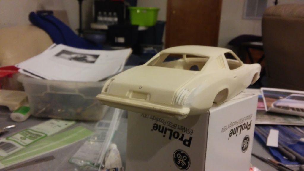

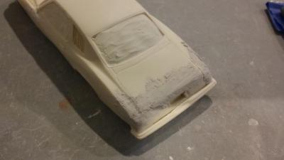

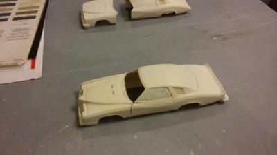

DoctorLarry Posted April 11, 2015 Author Posted April 11, 2015 Came home today and added the lower valance and worked on the back end. I also removed the old grille area. Tail lights and grille and I'm almost done.

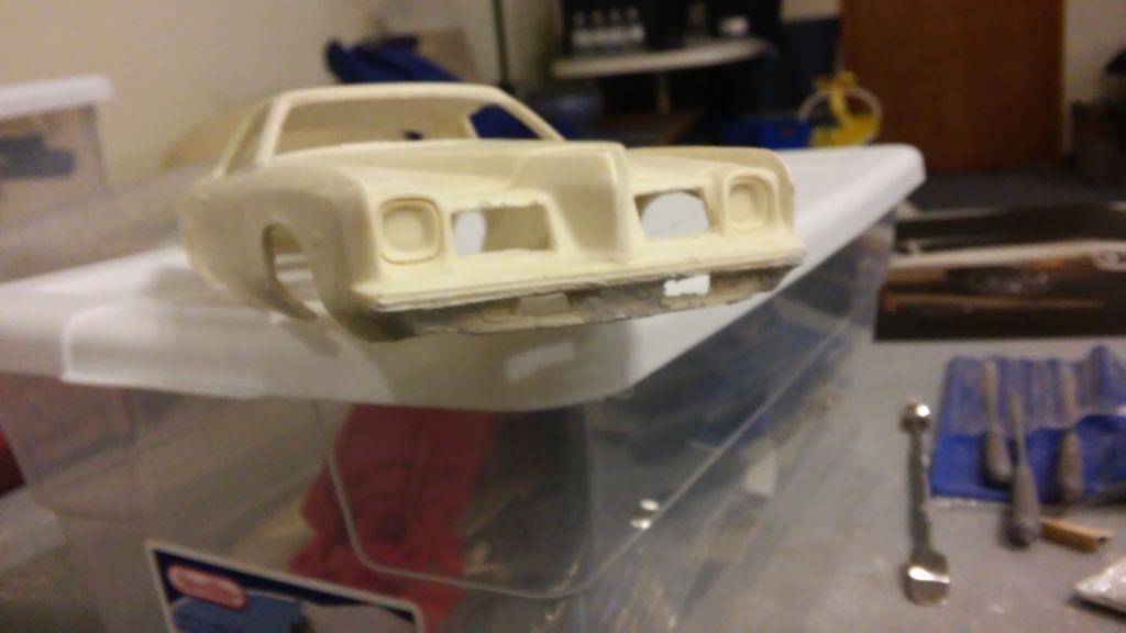

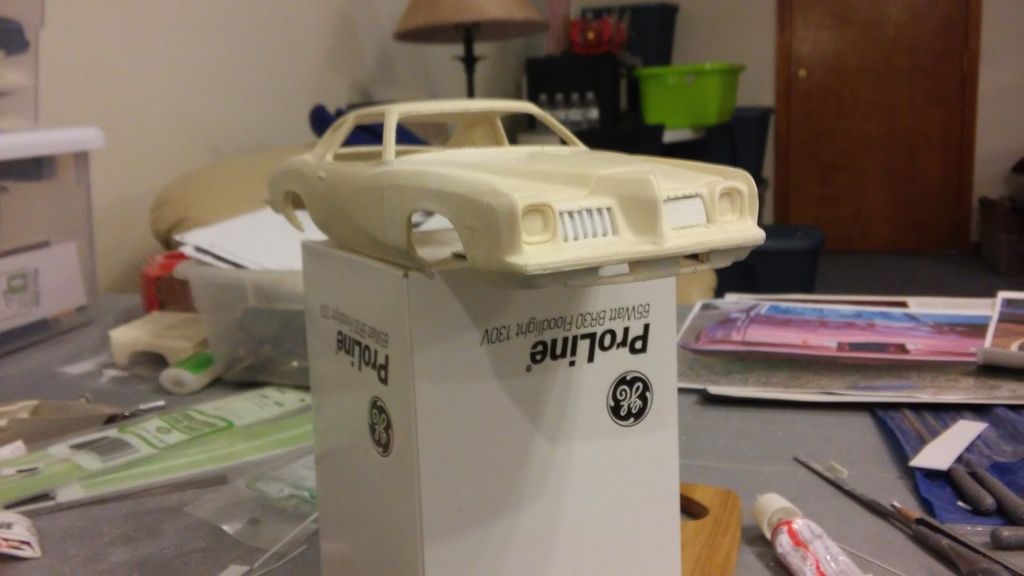

DoctorLarry Posted April 12, 2015 Author Posted April 12, 2015 Began work on the grilles and tail lights. Trunk lid is pretty much done. I still need to finish the front valence as well.

DoctorLarry Posted April 12, 2015 Author Posted April 12, 2015 I will probably make a mold and cast a few of these, if nothing else than to build one for myself!

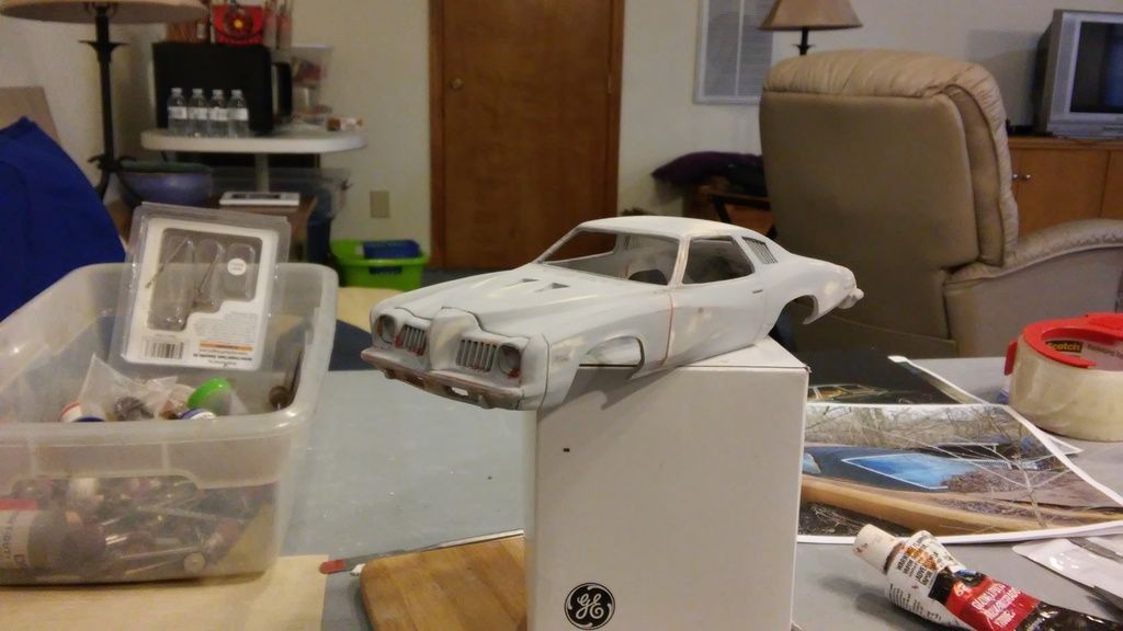

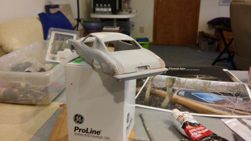

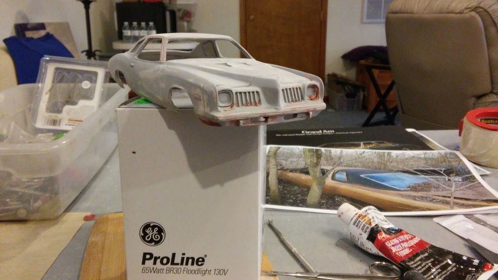

DoctorLarry Posted April 28, 2015 Author Posted April 28, 2015 More progress. I have done two primer coats and am fixing body zits right now. I will make the mold this week and hopefully cast some bodies this week end.
