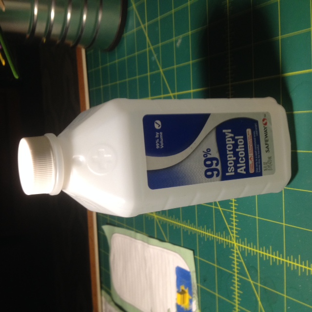

fseva Posted April 27, 2015 Posted April 27, 2015 99% Rubbing Alcohol and then do about 3-4 layers for a nice outcome. Sorry to go off-topic here, but the best I've found (and it's really cheap at the local drug store) is 91% - where do you get your 99%?
aurfalien Posted April 27, 2015 Author Posted April 27, 2015 Hi fseva, I find it at Vons and will post a pic later tonight. I think it runs me ~$3 for 16oz.

aurfalien Posted April 28, 2015 Author Posted April 28, 2015 Hi fseva, Here is the bottle, SafeWay brand.

fseva Posted April 29, 2015 Posted April 29, 2015 Hi fseva, Here is the bottle, SafeWay brand. Hmmm... no Safeway in the area... but I did see it was available at Amazon, and CVS. So, I should be all set! Thanks!
