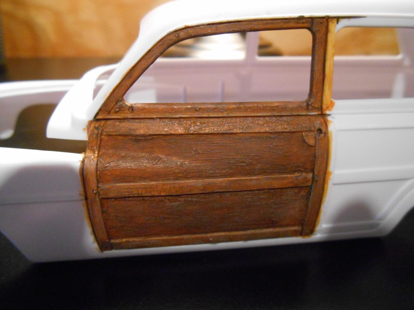

SpeedShift Posted March 19, 2017 Posted March 19, 2017 (edited) Lots of woody kits out there now.....Anybody find any good methods for simulating wood recently? Paint and texture appliques? This weathered aged cracked wood technique by bpletcher55 - posted by Foxer is really nice:http://www.modelcarsmag.com/forums/topic/90111-weathered-wood/ - Used the folkart paints then distress crackle paint, then some light gray and flat black - ,colors are raw sienna on the large panels ,cinnamon on the trim , Edited March 19, 2017 by SpeedShift 1
MAGIC MUFFLER Posted March 19, 2017 Posted March 19, 2017 That weathered wood look is outstanding..!!! That looks so realistic.

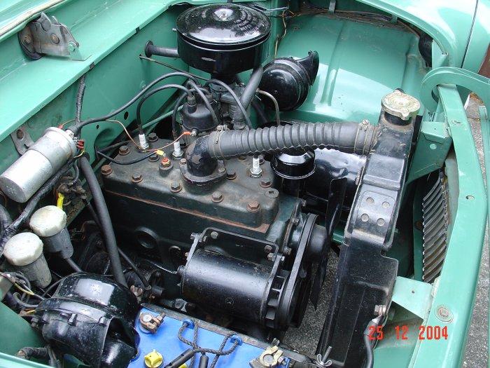

tedd60 Posted March 19, 2017 Posted March 19, 2017 I believe the engine used was a 1172 cc Ford 10 hp side-valve engine. There are some differences, but the 4 cyl. from the Model A wouldn't be a bad place to start. Although the engine in the picture is a very late engine, note where the upper radiator hose connects to the head in the attached picture. A search on the 'net should get you the pictures you'd need. https://en.wikipedia.org/wiki/Ford_Sidevalve_engine

PatW Posted March 25, 2017 Posted March 25, 2017 I believe the engine used was a 1172 cc Ford 10 hp side-valve engine. There are some differences, but the 4 cyl. from the Model A wouldn't be a bad place to start. Although the engine in the picture is a very late engine, note where the upper radiator hose connects to the head in the attached picture. A search on the 'net should get you the pictures you'd need. https://en.wikipedia.org/wiki/Ford_Sidevalve_engine Wow I remember that engine. My wife had the Ford 100E Popular when we got married in 1968, with that beast under the bonnet. Yes it was as said all 1172cc, three speed manual box with exhaust intake powered windscreen wipers, the faster you went (up to the maximum of 45 miles per hour) the slower they went! Heres a pic of one in the same colour..........
dodgefever Posted March 25, 2017 Posted March 25, 2017 The OP hasn't been on here in nearly two years...Still, for the record, the model A four banger isn't a good subsitute for a stock Anglia/Thames engine. The 1172cc British Ford is only about a third of the displacement of the model A engine - the bore is only 2.5", so it's tiny in comparison.
tedd60 Posted March 26, 2017 Posted March 26, 2017 (edited) The OP hasn't been on here in nearly two years... Still, for the record, the model A four banger isn't a good subsitute for a stock Anglia/Thames engine. The 1172cc British Ford is only about a third of the displacement of the model A engine - the bore is only 2.5", so it's tiny in comparison. And the carb and exhaust are on the wrong side. About the external dimensions, I don't know for sure, but, as I backed checked the info I found on Wikipedia, it indicated that the engine was developed from the Model A engine. It is not an unfair assumption to think the outside dimensions and appearance of the engine block could/would be the same despite a large difference in displacement. Since we're discussing British makes, I would cite the Austin A40. I did manage to locate another view of this little Ford engine. Perhaps, when the op gets back, he would like to scale it up, and check the external measurements against that of a flat-head 4 cyl. from the Model A, and then decide to go on with what ever mods it would need. I still think is still a pretty good place to start. T Edited March 26, 2017 by tedd60

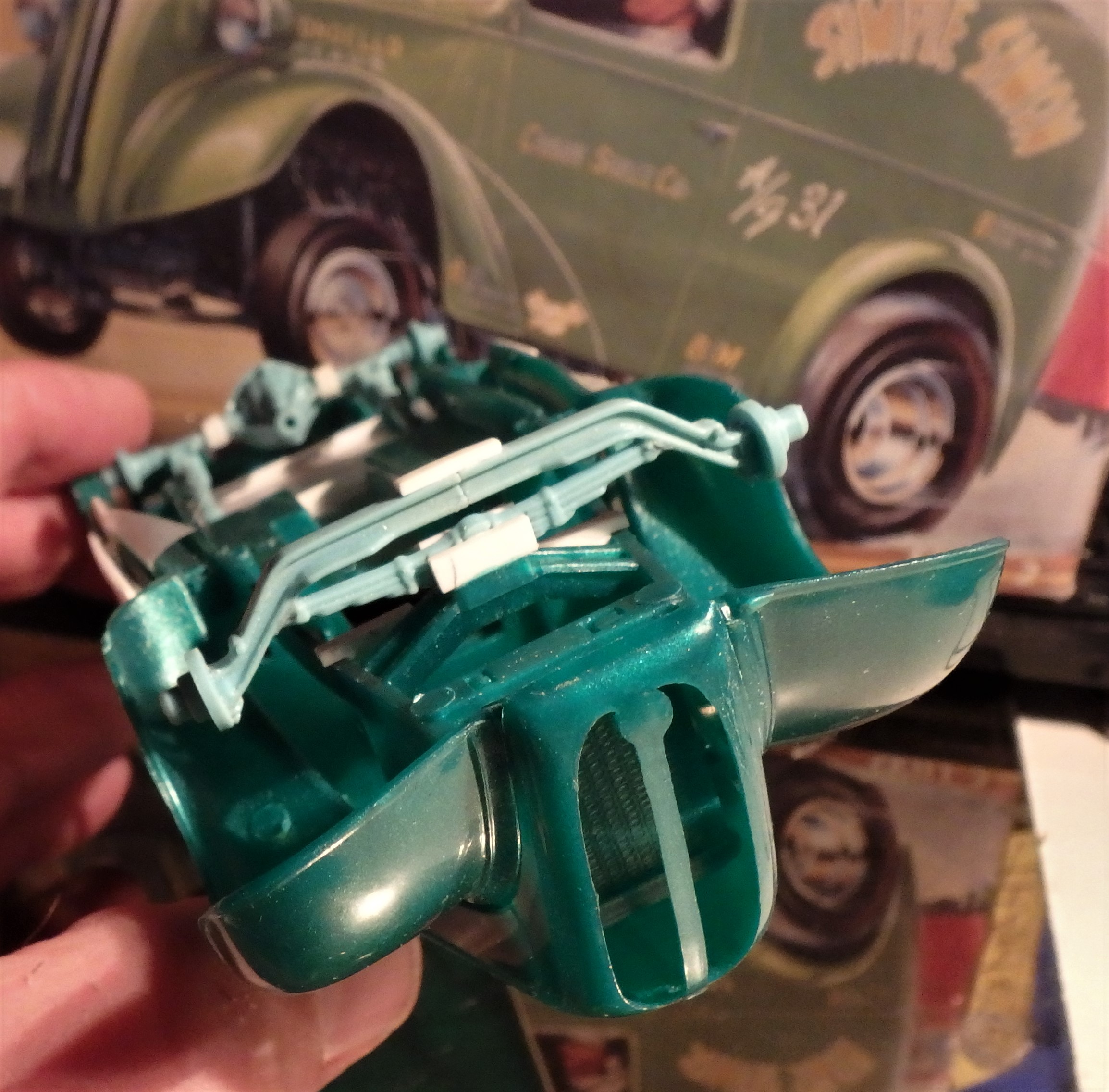

maltsr Posted March 26, 2017 Posted March 26, 2017 Hi Jim. What a great project! Good to have you back on the forum and digging out this old build. What did you use for front suspension? It seems narrower and lower than the kit setup.
SpeedShift Posted March 26, 2017 Posted March 26, 2017 Hi Jim. What a great project! Good to have you back on the forum and digging out this old build. What did you use for front suspension? It seems narrower and lower than the kit setup. The front axle in the kit is a unit that raises the front end for weight distribution - typical of dragsters of the time. I'll need to check a kit box deep in the closet, - but I'm pretty sure both the front dropped axle and the rear axle are from the Old AMT 1929 Model "A" roadster - kit #6572 or a variant.
maltsr Posted March 26, 2017 Posted March 26, 2017 The front axle in the kit is a unit that raises the front end for weight distribution - typical of dragsters of the time.I'll need to check a kit box deep in the closet, - but I'm pretty sure both the front dropped axle and the rear axle are from the Old AMT 1929 Model "A" roadster - kit #6572 or a variant.Thanks Jim - I see you narrowed it! I've been unable to find one of the right width without resorting to the same solution.
SpeedShift Posted March 26, 2017 Posted March 26, 2017 (edited) Hi Jim. What a great project! Good to have you back on the forum and digging out this old build. What did you use for front suspension? It seems narrower and lower than the kit setup. The front axle in the kit is a unit that raises the front end for weight distribution - typical of dragsters of the time. I'll need to check a kit box deep in the closet, - but I'm pretty sure both the front dropped axle and the rear axle are from the old AMT 1929 Model "A" roadster - kit #6572 or a variant. ------------------------------------------------------------------------------------------------------------------------------------- Pretty sure the tires and steelie wheels are form the 1950 Ford pickup Edited March 26, 2017 by SpeedShift

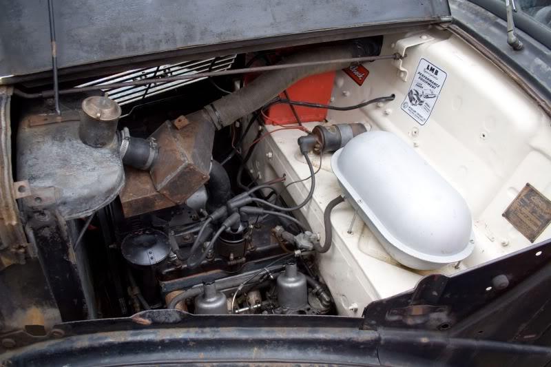

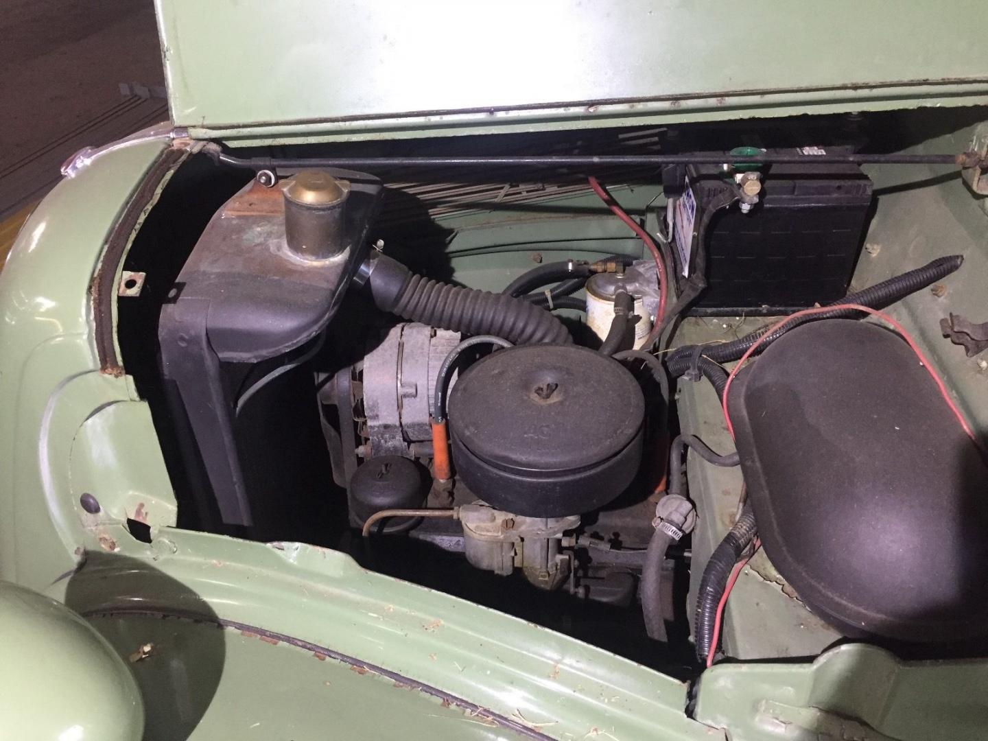

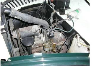

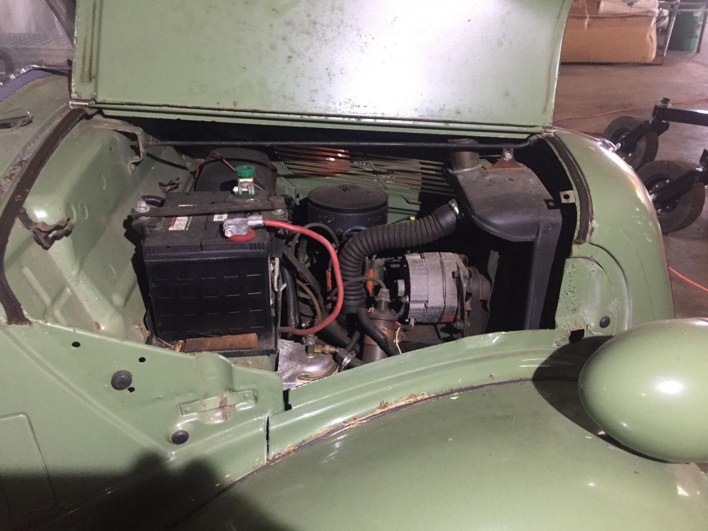

SpeedShift Posted March 26, 2017 Posted March 26, 2017 Ok, I searched my file and found pictures related to stock Anglia engines previous discussion - Battery looks bigger than the engine in some of these pictures.....LOL
dodgefever Posted March 26, 2017 Posted March 26, 2017 Yep...it has been awhile - but I am the OP - and I tried to get my password reset several times and all my messages went unanswered. So, I gave up on that - and reintroduced myself recently in the introductions section - but I had to use an entirely new user name to log on to do it. Nonetheless, I thought I'd pick up this thread were I left off. Hey Dodge - If you have a better suggestion I'm all ears...I don't know if it makes sense to try and replicate a stock Anglia/Thames motor at this point - if it can be done, I'll give it a try. it sounds like the 1172cc British Ford is much smaller than the Ford A - 4cylinder...so it is not equivalent. But it sounds like the Ford A -4 cyl. is more engine than needed? I would think since hot rod versions of Anglias and Thames have used everything from f.i. small blocks up to a supercharged Rat motor, - everything is fair game if I consider an engine swap. Doing a woody and not a dragster, I'm looking at less . Thanks for the posts everyone. I want to finish this but the engine is a decision that needs to be made. Aha, I didn't twig you were the OP., it was late and I'd only skimmed the thread From what I can find online, the model A block is 19 5/16" x 7 13/16" in plan. The British sidevalve is about 13" x 5 1/2", so about 2/3 the size of the A engine. I haven't been able to find anything on the height of the British Ford engine, but obviously it'll be smaller in that dimension as well. Then, as mentioned, the inlet and exhaust are on the opposite side... seems is would be as easy to start from scratch.

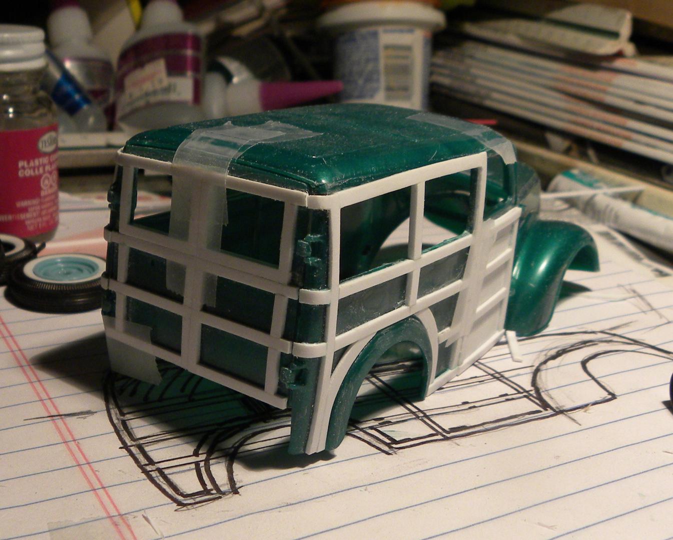

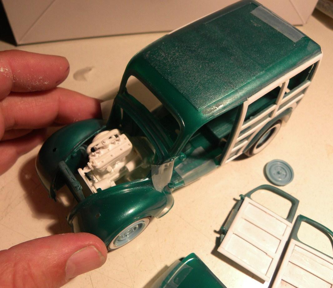

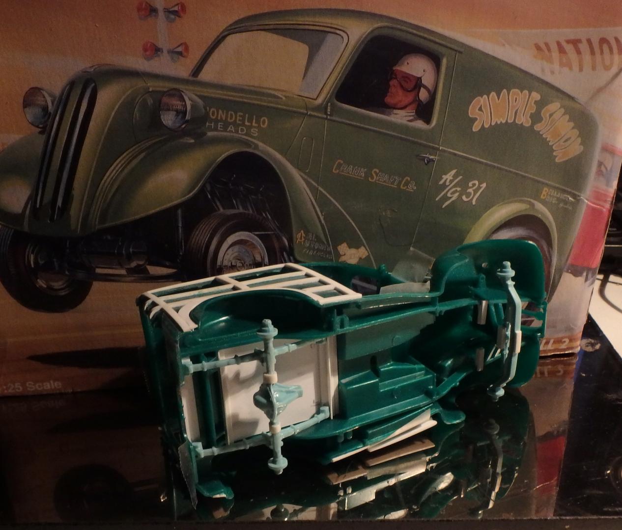

SpeedShift Posted November 13, 2020 Posted November 13, 2020 (edited) Put it in primer (Tamiya Mr. Surfacer) this morning. Working the interior and 4 banger engine. Also considering wood paneling techniques. Edited November 13, 2020 by SpeedShift
