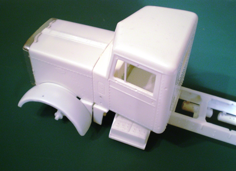

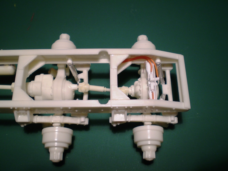

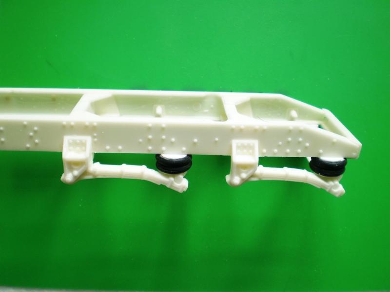

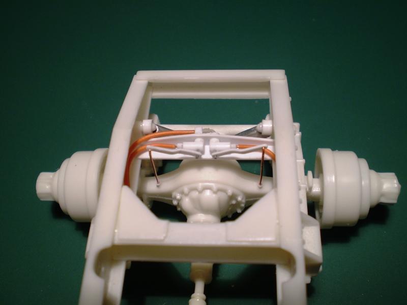

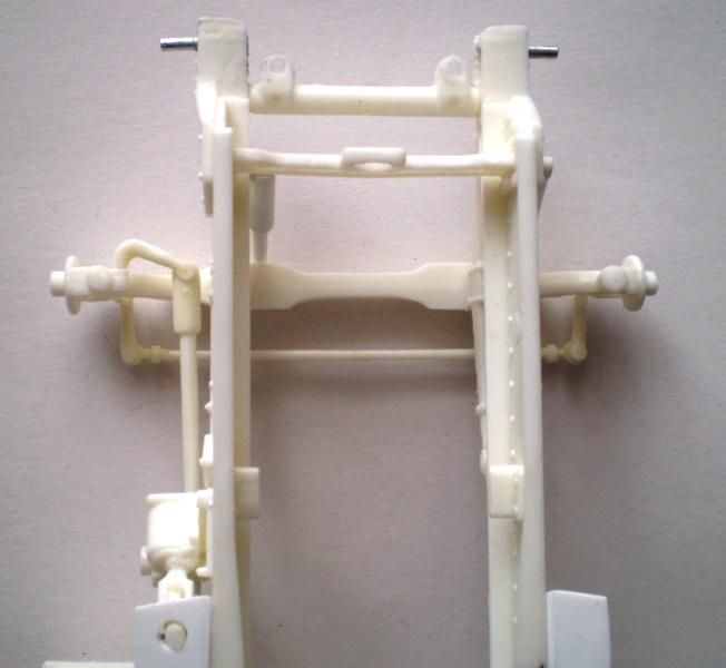

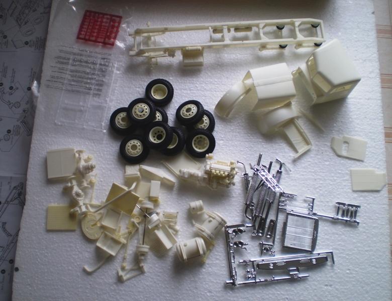

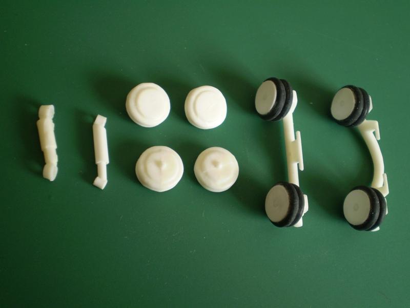

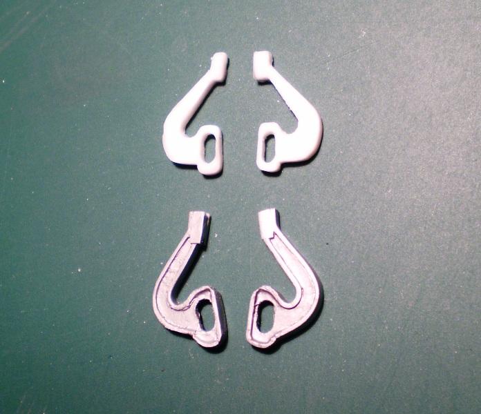

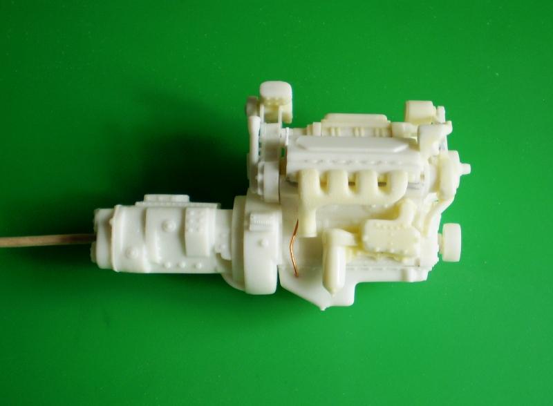

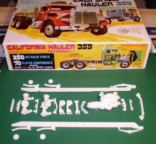

truckabilly Posted May 3, 2015 Posted May 3, 2015 (edited) With the reissue of Peterbilt 359 California Hauler came the early version of the truck with unilite cab, two-bar grille, single breather, roof-mounted AC and stabiliaire suspension. The features that vanished in time. It´s great to have it back. First I wanted to build a stock box but then I found that some parts have to be replaced. Like the shock absorbers or the double donut air bags. They are of really bad shape. The interior tube is also out of question. So, I left the idea of stock box and went on my usual way of modifying some parts and replacing the others. I stripped the chrome layer off the parts that I want to paint with a different color. This is the color combo that I would like to replicate. Starting out with a parts pile… I assembled the screaming Jimmy… And went on to frame parts… The engine will be white just as the frame. I will do all I can to make it look not as boring as it sounds. Here is the comparison between the original kit parts my replacement. I had to change the location of the height valve cross member due to space reasons. The valves are linked straight to the axle which is not right but I couldn´t find a better way. That´s it for the start. Up next- the hood. Edited July 19, 2017 by truckabilly

gatorincebu Posted May 4, 2015 Posted May 4, 2015 Jarda, looking good thus far! I like the use of the rubber O-rings for the airbags. great idea! be Well Gator

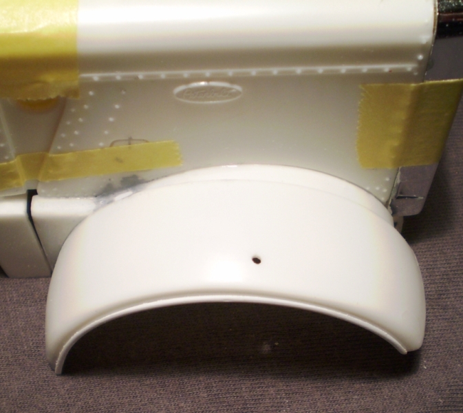

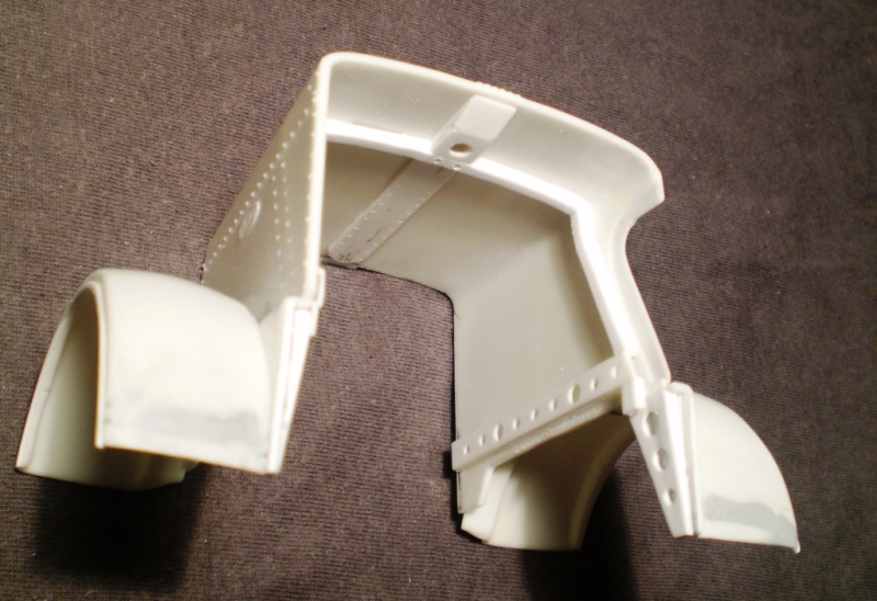

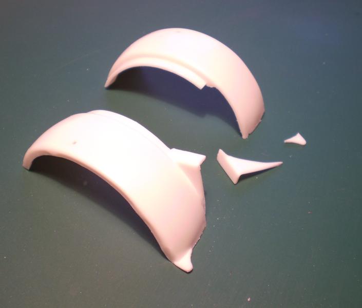

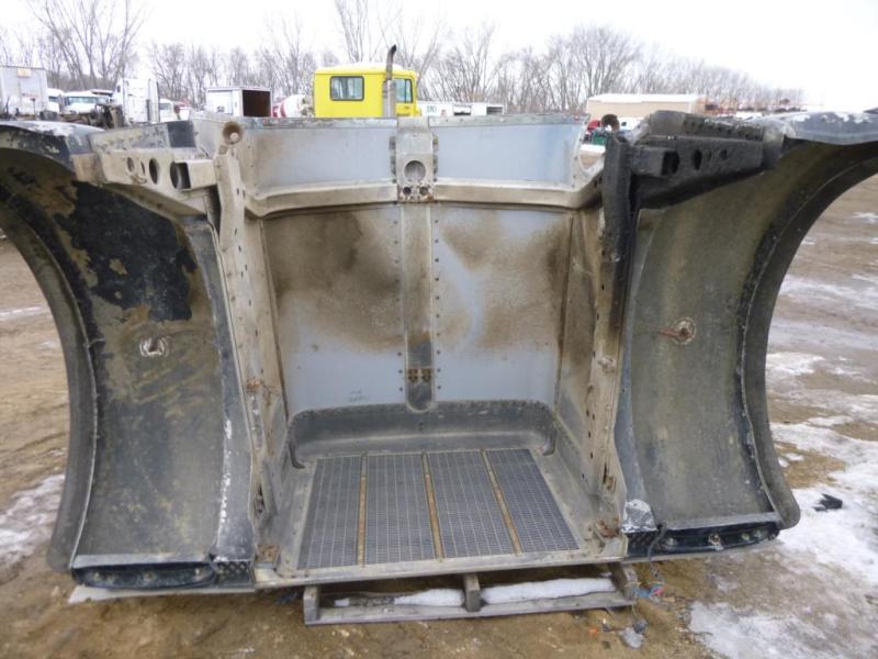

truckabilly Posted May 5, 2015 Author Posted May 5, 2015 (edited) And for the grill, if you cut the moulded in screen out and let the radiator shutters show itll be just like the 1:1. That´s my plan. The hood of the original AMT edition had no hinges and the recent reissue hasn´t them either. I copied a pair of hinges from RoG kit. If they won´t work, I´ll make another, then another untill it sets right. The pins are also ready. Every hood has some inside details but the kits have none. How could I go without something like this? Here is my added structure. Not 100% accurate but still better than nothing. I also corrected the fenders using Tim´s idea (I think he´s the author). To erase the gap between fenders front edge and bumper it is necessary to either add some material to the front of the fender or turn them forwards and add some material to the back. The latter requires more complex reshaping. I chose the more coplicated way to avoid the risk of a failure right in front of the truck. If something goes wrong, let it be hidden in the back. First I cut off the tooth and step in the back of the fenders. I glued the fenders to the sides of the hood turned slightly forwards so that the the bottom edge of the grill and front edges of the fenders were even. Then I glued back the cut off tooth, slightly reshaped so that it would fit okay. The picture shows a hole but that´s filled with a piece of plastic now. I used the mud flap part to extend the material in the back of the fender. It took some putty to hide the joint. The last modification of the fenders is the added lip made of Evergreen rod. I also repositioned the hole for the turn signal light (or is just clearance light?) so that it was on very top of the fender. Till next time... Edited July 19, 2017 by truckabilly
bandit1 Posted May 8, 2015 Posted May 8, 2015 cool... what are you doing to correct the airbags if I may ask?...
Truck parts Posted May 9, 2015 Posted May 9, 2015 Great looking build so far.What size of o-ring did you use?
guitarsam326 Posted May 9, 2015 Posted May 9, 2015 Jarda, everything looks great so far (as expected), but I have to ask, where do the air line fittings come from?
Superpeterbilt Posted May 9, 2015 Posted May 9, 2015 The under-hood structure is great work Jarda. I've thought about doing that also, but you beat me to it! Great job man.
truckabilly Posted May 9, 2015 Author Posted May 9, 2015 Great looking build so far.What size of o-ring did you use? I bought a set with different sizes and used the one that was closest to original parts. The O-rings are 12 mm (0,472") of outter diameter and bout 2 mm (0,072) thick. Jarda, everything looks great so far (as expected), but I have to ask, where do the air line fittings come from? If you mean the one between the height valves, I bought a set of those parts years ago from someone at one of the local contests. If it is a straight line, I use hexagonal channel drilled in the middle and sliced in short pieces.
tbill Posted May 10, 2015 Posted May 10, 2015 fantastic as usual, really like the o-ring trick, I will have to remember that.
