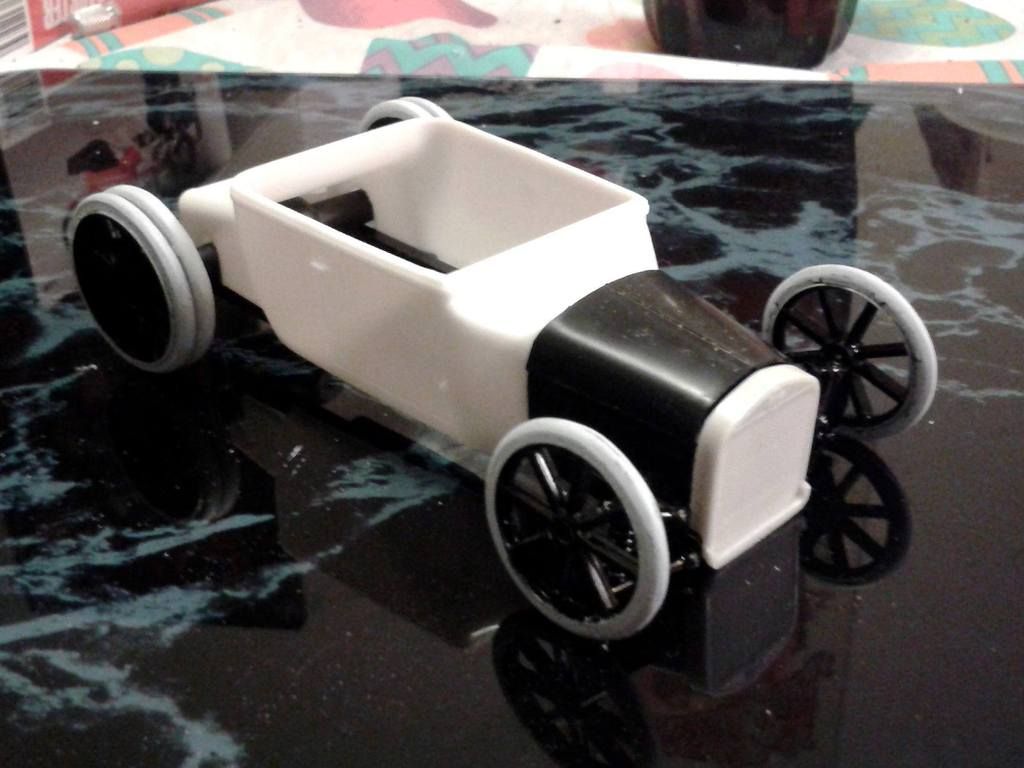

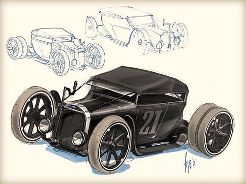

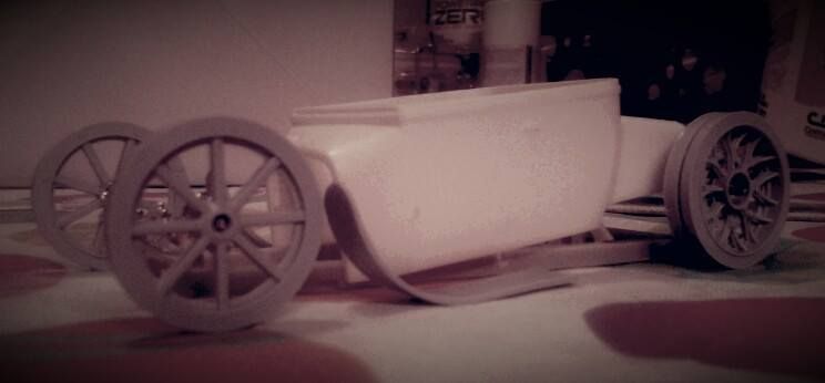

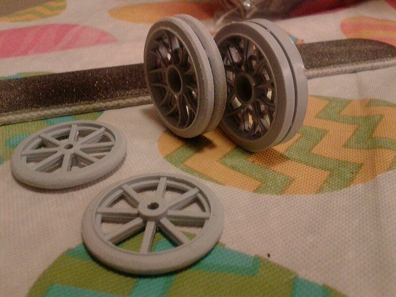

Dirty Dave Posted May 12, 2015 Share Posted May 12, 2015 Browsing around Tumblr, I stumbled upon this concept by John Frye: It looked more like a coupe with the roof removed than the standard roadster body, so I sourced a Chopped AMT body, and got to chopping: Wheel/tire assemblies were pilfered from a 1:32 scale Airfix omnibus kit, as were the fenders. An emory board contoured the tires to look more pneumatic. And after I sprayed them black, I removed the paint from the tires to reveal their original light gray color. Powerplant will be a stock-ish Model A banger, though I intend to display this one as a curbside. I teched it up a bit in the front, opting for IFS, just because I wanted it to represent a modern take on a very vintage look. That's not set in stone, though. With the right drop axle, I could build a new frame pretty quickly. Quote Link to comment Share on other sites More sharing options...

misterNNL Posted May 14, 2015 Share Posted May 14, 2015 (edited) For anyone who has not followed the blue John Frye link at the beginning,be sure you take time to do that.There a some really amazing digital drawings and several more links to folow that are very impressive. Edited May 14, 2015 by misterNNL Quote Link to comment Share on other sites More sharing options...

Ace-Garageguy Posted May 16, 2015 Share Posted May 16, 2015 Definitely capital-C cool. Only thing I'd consider changing is to pull the front wheels just a tad forward...put the front-axle centerline even with the grille shell. Neat little machine, either way. Quote Link to comment Share on other sites More sharing options...
Taxdude Posted May 16, 2015 Share Posted May 16, 2015 Very cool. Front wheels could come forward somewhat Quote Link to comment Share on other sites More sharing options...
Dirty Dave Posted May 17, 2015 Author Share Posted May 17, 2015 Definitely capital-C cool. Only thing I'd consider changing is to pull the front wheels just a tad forward...put the front-axle centerline even with the grille shell. Neat little machine, either way. Very cool. Front wheels could come forward somewhat While normally I would agree with you, that just doesn't really work mechanically with this double-wishbone setup; to have a realistically-proportioned radiator at the hoodline height that I'm looking for, it has to sit in front of the crossmember. It's one of the reasons that I was considering building an entirely new frame, and finding a drop axle that will work. Quote Link to comment Share on other sites More sharing options...
James2 Posted May 17, 2015 Share Posted May 17, 2015 Inspiration comes from many places and has driven many a modeler into the deep end of our hobby. This is exactly what I love about models! And on a side note: The front wheels do appear to be forward some what, even ahead of the lights. Quote Link to comment Share on other sites More sharing options...
Dirty Dave Posted May 17, 2015 Author Share Posted May 17, 2015 I was looking at it, and I think I may be able to squeek the radiator back a scale inch or two with some judicious filing. Failing that, I'll work on building a drop axle, and see how far I get with that. Quote Link to comment Share on other sites More sharing options...
