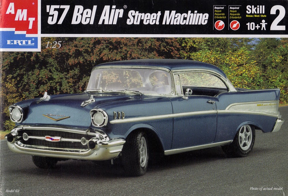

Fat Brian Posted May 13, 2015 Posted May 13, 2015 The best of the 1/24-1/25 57 Chevies is the new tool released by AMT in the early 2000's. There is a stock version with a picture of a pink car on the box and a street machine version with a blue model with Corvette wheels on the box. This is the hardtop version of the car that has become iconic unlike the new Revell kit that is the post window body style. There's nothing wrong with the 100th anniversary kit but it is dated and there are other kits to consider now.

randx0 Posted May 13, 2015 Posted May 13, 2015 The newer AMT 57 check also came as a street machine only. which if you're building stock it doesn't have those parts in it.

Greg Myers Posted May 14, 2015 Posted May 14, 2015 (edited) I think there may be some to confusion as to the fact that there were actually two AMT 1/25th '57 Chevy Bel Airs. The first issue, above with the blue and red cars being a 3 in 1 kit build able as stock, race and with many styled parts a custom. also many single version reissues, with and without the custom parts. Edited May 14, 2015 by Greg Myers
Greg Myers Posted May 14, 2015 Posted May 14, 2015 (edited) The second issue, often referred to as the "New Tool" version ( actually originally issued some time ago) had the open trunk. Identifying which you have can be daunting at times as they have both be reissued many times and overlapping. New tool Edited May 14, 2015 by Greg Myers
