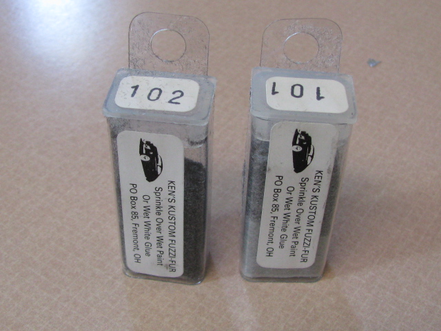

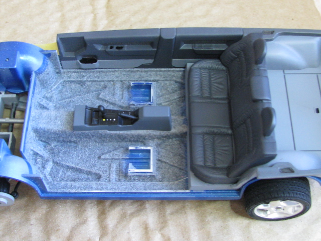

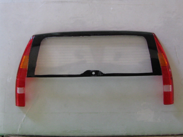

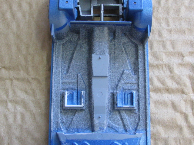

kelson Posted June 7, 2015 Author Posted June 7, 2015 Thanks Kennyboy and twokidsnosleep and Bennyg,Thanks also PatW for the pic of the taillight area! Ok,small update for today,I redid the interior floor with a mixture of light gray/dark gray flocking using Ken's Kustom fuzzi fur.

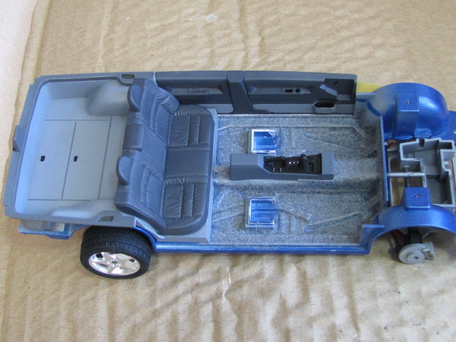

kelson Posted June 7, 2015 Author Posted June 7, 2015 I also have a few pics with the console attached and the door panels mocked for test fitting,which is the usual Tamiya fit ,i was able to put on my final pearl coat on the Volvo a couple days ago,so while it's drying i will start on the few parts left to paint.
Dominik Posted June 11, 2015 Posted June 11, 2015 (edited) one of the finest interiors i ever saw on a kit. realy nice molded. if i'm right, there is a carpet in the instruction to cover all the ups and downs on the floor. isn't it? in my mind as i built mine, i think, i put it in...and did the flocking afterwards. Edited June 11, 2015 by Dominik
kelson Posted June 11, 2015 Author Posted June 11, 2015 You're correct Dominik,but the carpet is a tan color and since I went with a grey color it just wouldn't match,i'll save the carpet for another project.I should've covered the ups and downs on the floor,but the interior put together hides most of it.

Dominik Posted June 16, 2015 Posted June 16, 2015 (edited) Hmmm....Curtis, i thought, the carpet was grey. the one i built has a gray interior like yours. can't remember, that i used another "thing" for it. i really must take a look on mine... Edited June 16, 2015 by Dominik

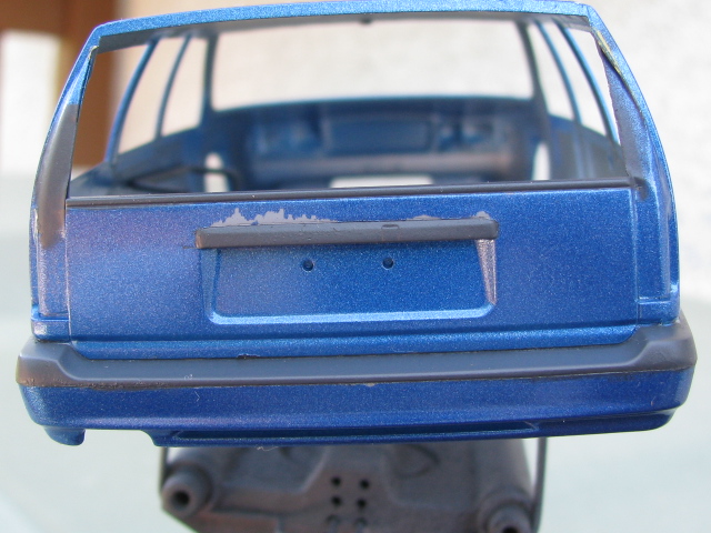

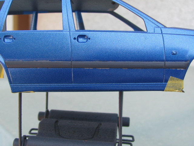

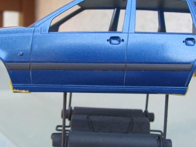

kelson Posted June 22, 2015 Author Posted June 22, 2015 Okay,back with a small update finally masked the body to paint the trim,and that's were the fun started,the bmf I used had lost it's stickiness,so it lifted in about 90% of the car so grabbed a other sheet and same result!,so tried with another sheet same deal!.Finally found a sheet that worked,painted the trim and went to remove the masking and the masking took off some of the paint! ,I think it's very fixable,but I'm just not feeling the grey trim on the body,so debating repainting it in black,even though I saw a 1:1 yesterday with grey trim.Anyone else have a thought or opinion on the trim?
Casey Posted June 23, 2015 Posted June 23, 2015 I'd vote for a semi-flat or matte lack for the trim. Looks good so far, though.
superbike-shaun Posted June 23, 2015 Posted June 23, 2015 Wow too bad about eurolovly Volvo.just kidding now you can build up some krazy Kars and use up some of your FRESH bmf or maybe someday you can have us come up and drive your superbadwagons on a proper track.and have a thrill or 10 " Superbike-shaun
Bennyg Posted June 23, 2015 Posted June 23, 2015 Paint is my Achilles heel as well. I think black trim is suitable. My mate has one of these. I'm pretty sure his has black trim. Ben
slusher Posted June 24, 2015 Posted June 24, 2015 Black or grey will work. When i mask just for trim on a painted surface i stick the Tamiya masking tape on my shirt once to lose some of stick because around molding is famous about pulling paint off..
Twokidsnosleep Posted June 24, 2015 Posted June 24, 2015 Black or grey will work. When i mask just for trim on a painted surface i stick the Tamiya masking tape on my shirt once to lose some of stick because around molding is famous about pulling paint off.. That is a good tip...just watch out for fuzzies lifting off your clothes or in my case dog fur
Bennyg Posted June 24, 2015 Posted June 24, 2015 That is a good tip...just watch out for fuzzies lifting off your clothes or in my case dog fur Use a clean surface to lessen the tackyness of the tape such as a tile or piece of glass that is clean and dry of course. Ben
charlie8575 Posted June 25, 2015 Posted June 25, 2015 The grey trim is usually semi-gloss black that faded. Most of these cars, as I remember, had black trim from the factory. Good luck with the paint. Charlie Larkin

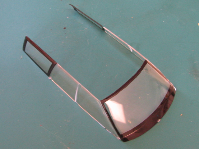

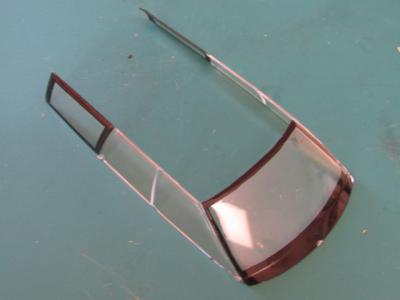

kelson Posted July 5, 2015 Author Posted July 5, 2015 Ok,I'm back with a small update,the front+ rear glass is finished,i repainted the body as well,but it fell off the paintstand onto the ground and more chips and debris got into the paint! .So I stripped the body,hope to have it back in primer this week,work has slowed things down a bit.
kelson Posted July 5, 2015 Author Posted July 5, 2015 You're right about the carpet color Dominik,I was looking at the backing all this time!
Bennyg Posted July 5, 2015 Posted July 5, 2015 Nice work on the clear parts. I had paint dramas as well. Ben

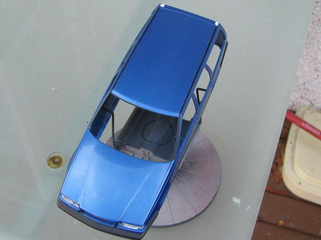

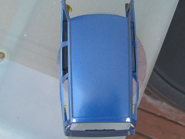

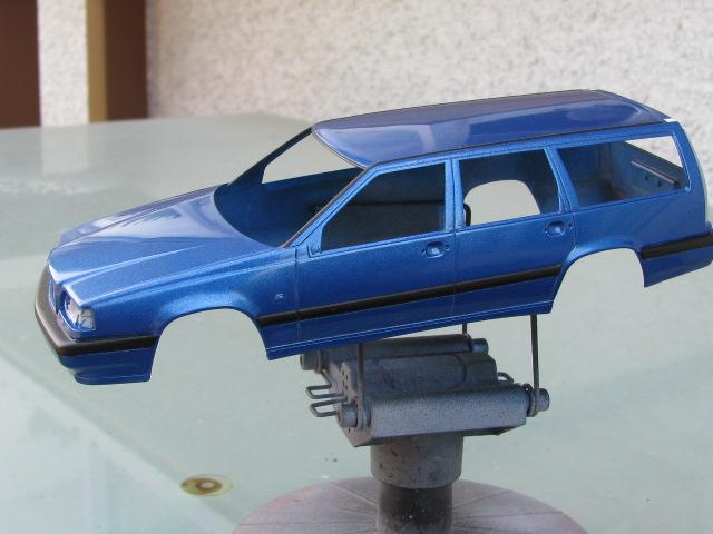

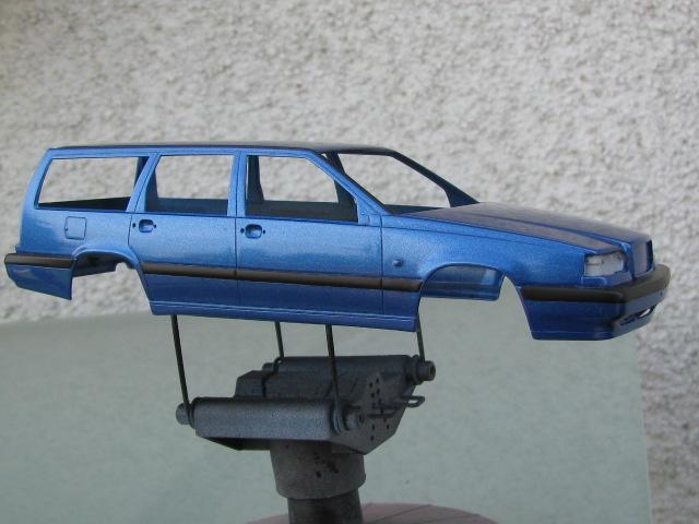

kelson Posted August 27, 2015 Author Posted August 27, 2015 Hey everyone,back with a update since my last update I repainted the Volvo but i had some sort of reaction with the paint and it cracked all over the hood and top of the car. So into the stripper again!.So this is the 3rd paint job and it's almost perfect even the masking turned out! so now on the backstretch with this one.
slusher Posted August 27, 2015 Posted August 27, 2015 Looks fantastic Curtis. Glad you stuck with it and it is paying off...
