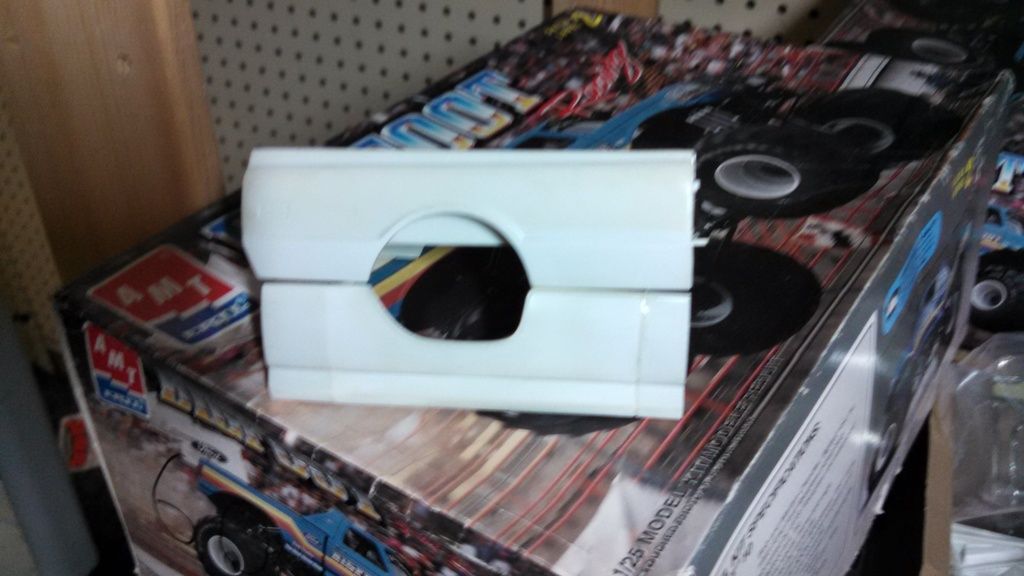

Fat Brian Posted May 20, 2015 Posted May 20, 2015 Chevy long beds are 8 feet long, they add one foot in between the cab and rear wheels and six inches after the rear wheels. I made one with one of the fleetside beds, I'll try to get pictures when I get home.

Fat Brian Posted May 20, 2015 Posted May 20, 2015 Here is a picture of the bed side I made compared to the 72 Chevy longbed. I think I needed to make the front about an 1/8 of inch longer but it's close, the rear will get about that much longer when the taillight panel is added.
72 Charger Posted May 20, 2015 Author Posted May 20, 2015 (edited) Thanks for that Brian . That does help a lot How many mm did you add to the front and then the rear ? Edited May 20, 2015 by Doobie

Fat Brian Posted May 20, 2015 Posted May 20, 2015 I'm not sure exactly, I just made it match the 72 bed.
72 Charger Posted May 20, 2015 Author Posted May 20, 2015 (edited) Ok Brian thanks anyway . I think I will just cut it up and see what I end up with lol Edited May 20, 2015 by Doobie

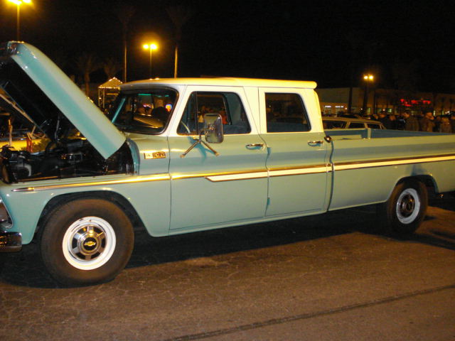

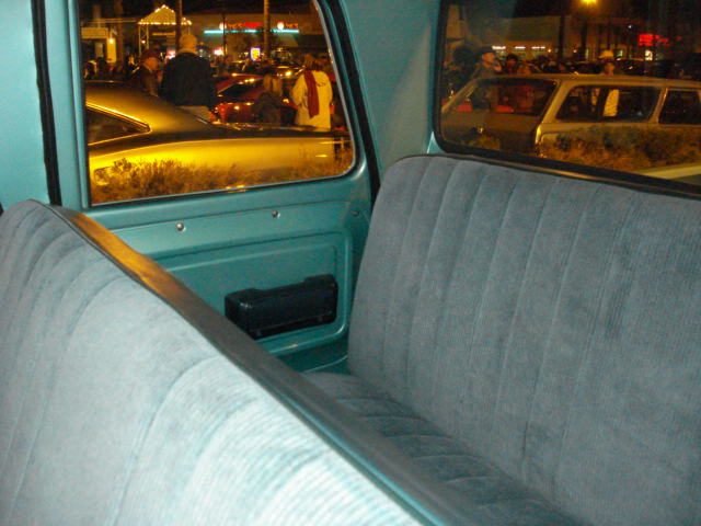

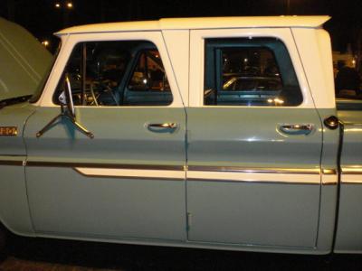

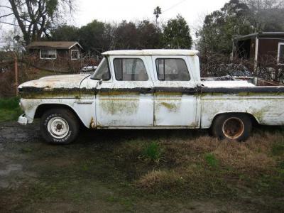

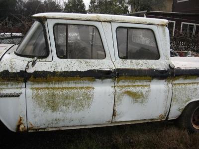

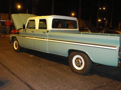

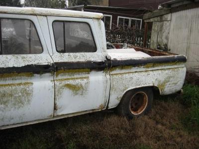

BTK Posted May 21, 2015 Posted May 21, 2015 (edited) No, GM Truck & Coach (who produced Chevrolet and GMC pickups) did not start making crew cabs until about 1973-74. FWIW, International Harvester was the first pickup manufacturer to catalog a crew cab, in the early-mid 1960's. Any Chevy crew cab built prior to the '73-'87 series pickups would have been done as an aftermarket unit--the early ones were built mainly by Proctor-Keefe in Detroit--then a major conversion company for all manner of truck cabs. Art Correct, most were made for Rail road companies. So technically, yes they made a crew cab 60' chevy. There are two running around my local car shows, but they're conversions using two Chevy/Fisher built 60' Chevy cabs. EDIT: Scrounged up some pics from the internet, hope this helps! Edited May 21, 2015 by BTK

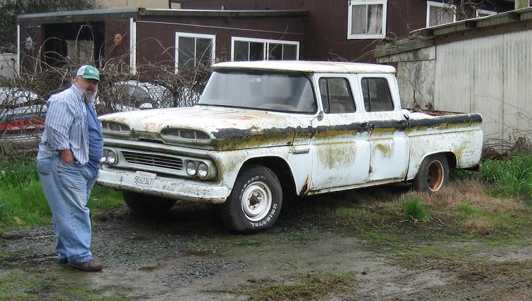

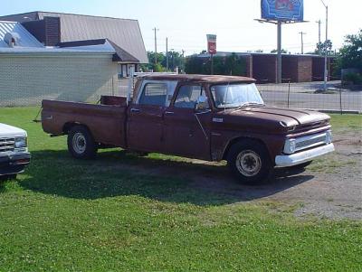

BTK Posted May 21, 2015 Posted May 21, 2015 According to the C10 forums, there may have been a handful but there aren't really any documented numbers. Most were built on the stock longbed frames and shortened the bed to fit. I scrounged a few pick up pictures. The rusty truck might be real, the blue is a conversion for sure. Sorry, I can't be of more help!
Longbox55 Posted May 21, 2015 Posted May 21, 2015 . The rusty truck might be real, the blue is a conversion for sure. Technically, they're all conversions. GM never produced a factory built crew cab until '73. Any crew cab you see was done by an outside upfitter.

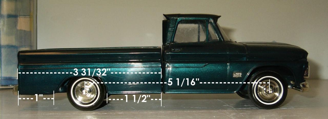

ChrisBcritter Posted May 21, 2015 Posted May 21, 2015 (edited) Hope this will help: I have a reissue promo '66 Chevy pickup with the fullsize bed; here are the measurements (click to enlarge): The box measurements are including the tail panel since it's molded in. Good luck with it! ETA: The model's 5 1/16" wheelbase scales up to 126.5625" - very close to the 127" listed in the '60 brochure. Edited May 21, 2015 by ChrisBcritter
BTK Posted May 21, 2015 Posted May 21, 2015 Technically, they're all conversions. GM never produced a factory built crew cab until '73. Any crew cab you see was done by an outside upfitter. Yep, I simply meant the blue one was built by an individual, not an aftermarket company.
