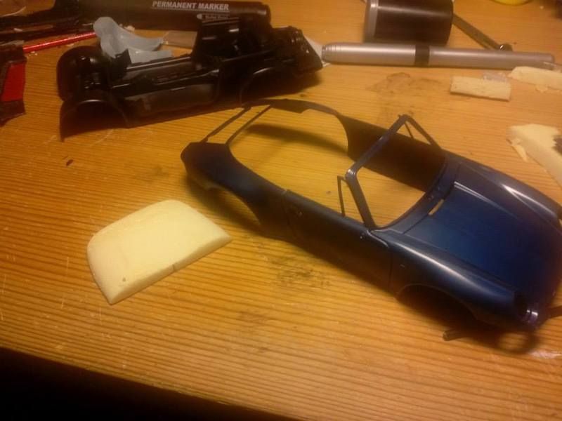

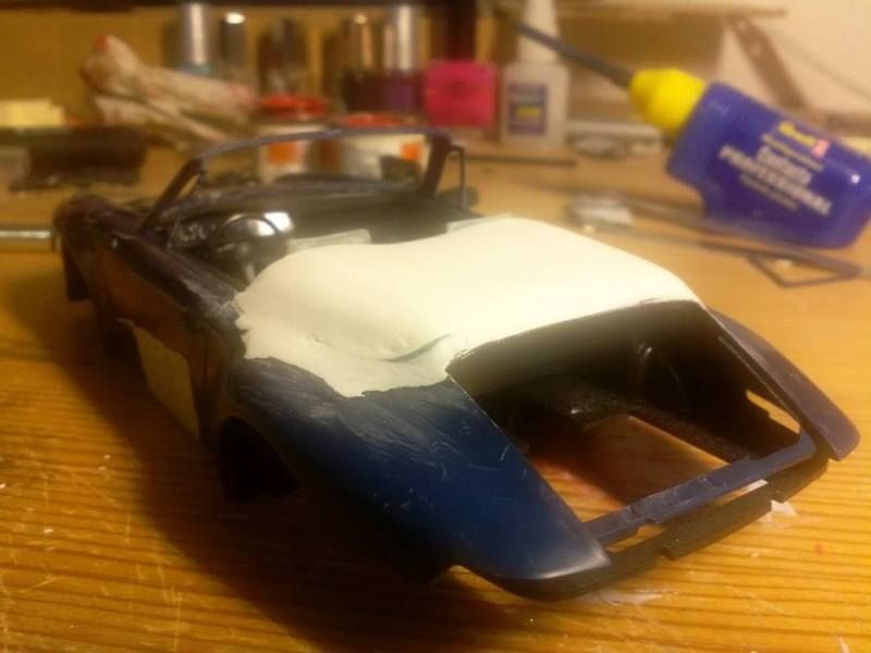

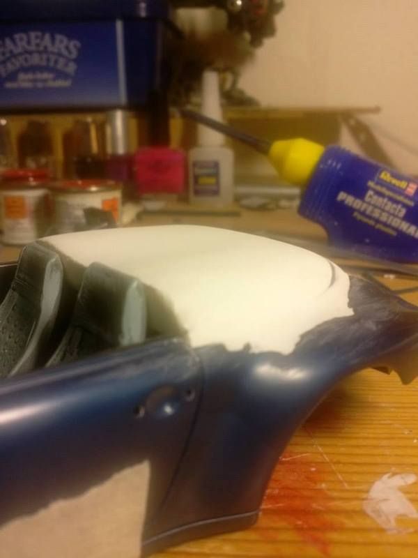

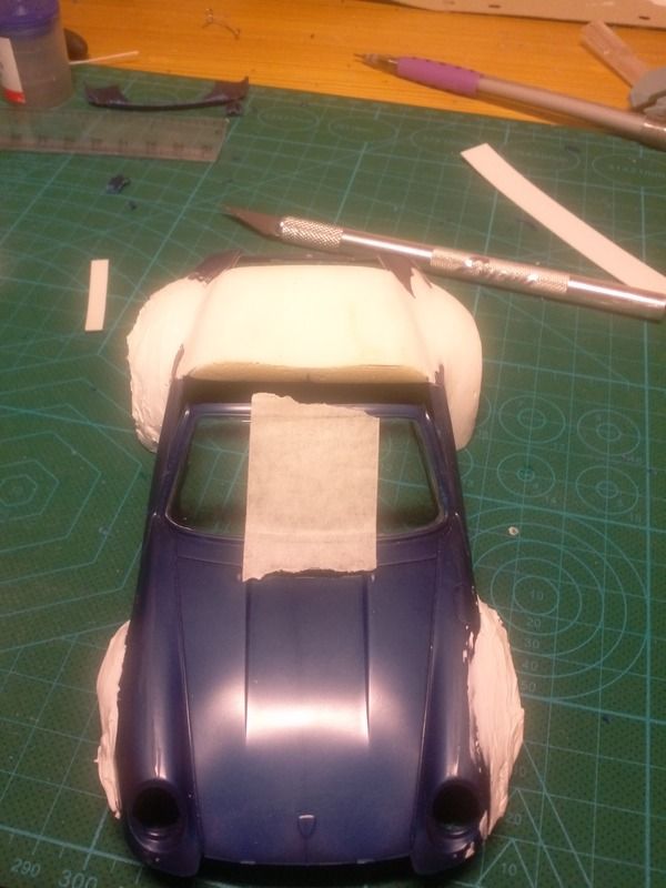

And to make the convertible body a Speedster body, I had to make a cover plate, so out came some modeling foam, which I sculpted to fit the body, using reference photos of the older and newer Speedster 911's. The 993 was never built from factory as a Speedster except for very few examples.
1526199_804045722970139_3708715891416979
10632876_809977955710249_123971601219419
10409220_809977959043582_580062971683253

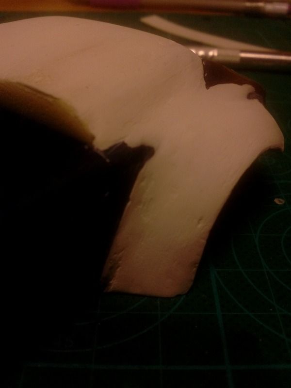

After the Speedster conversion was done, I started sculpting the new fenders and modify the rear bumper, there's a lot of work left on them though.

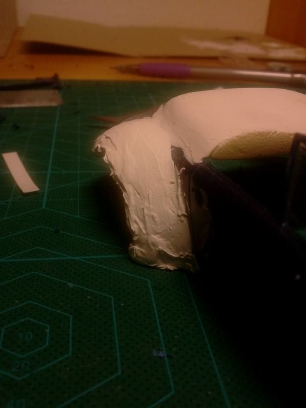

The left rear fender... This is almost completed, but as you can see, it still need some more work.
And here's the right rear fender. A lot more work to do here!
The rear fenders widen the body about 1 cm per side, which obviously would be about 24 cm in 1:1 scale.

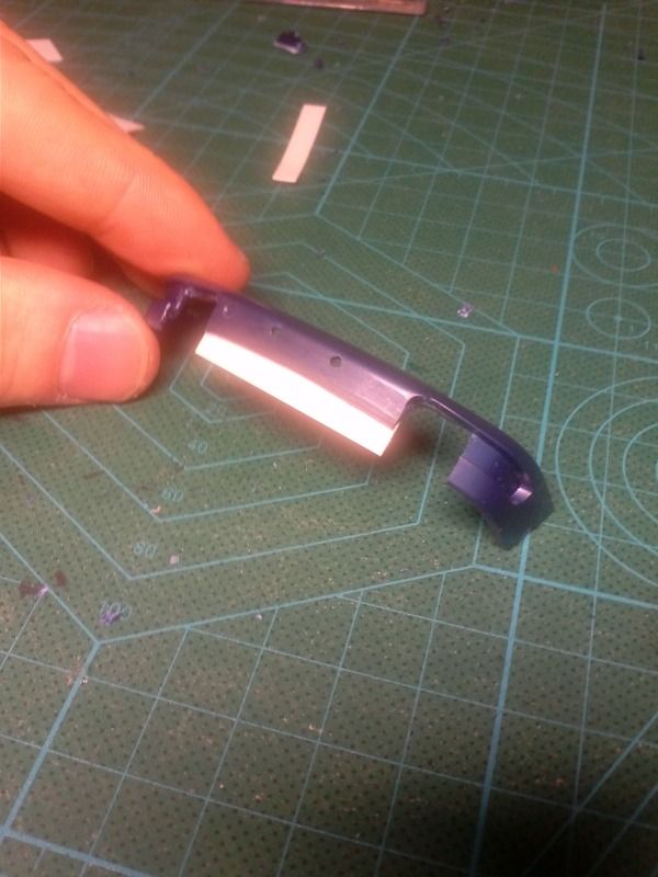

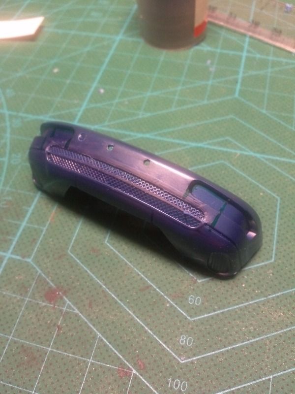

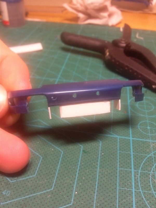

The front spoiler has to be modified quite a bit to fit the RWB style, so the lower part has been cut off, along with a few small parts to make an air intake.
Before...
And after. I've added a piece of styrene strip in the middle to help align the new lower part of the front.

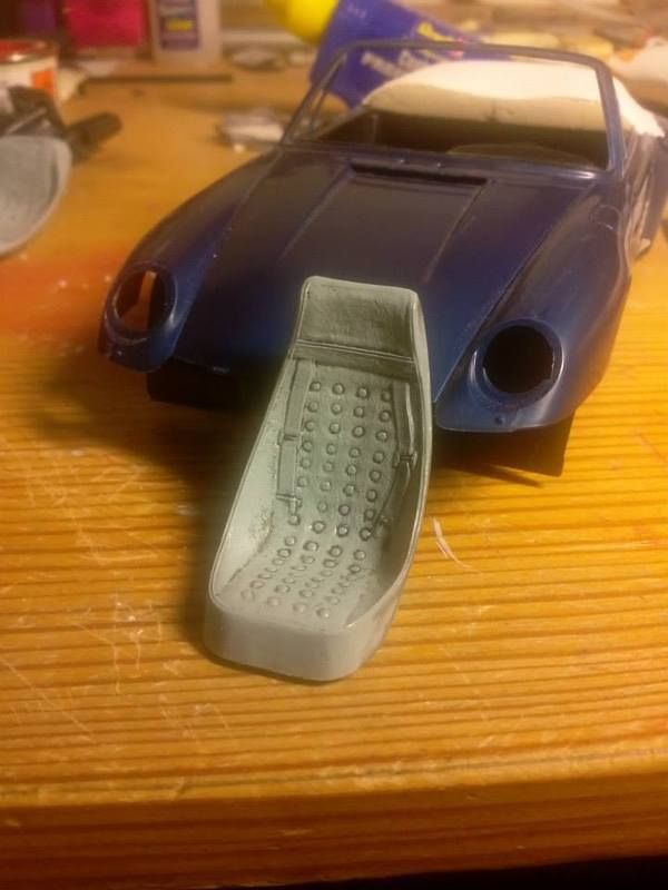

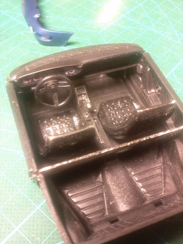

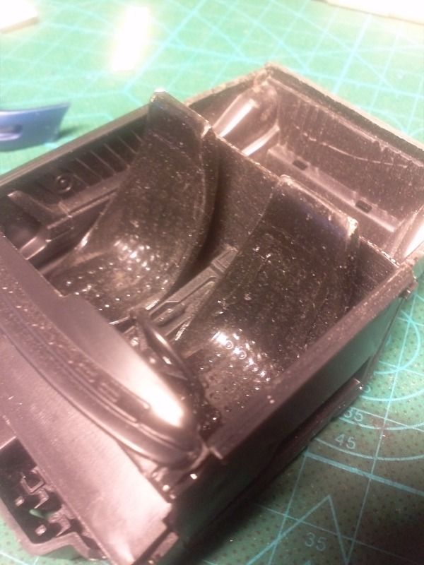

For the interior, I wanted a bit more classic style, so I went through the parts bin, and found these seats, which were painted black along with the rest of the interior.
10408953_809978025710242_197690485409949
I also changed the steering wheel, as the original looked like BLAH_BLAH_BLAH_BLAH and was way too big.

Thanks! Will work some more on the front bumper tomorrow, i'll add the lower part/rubber piece then :)
