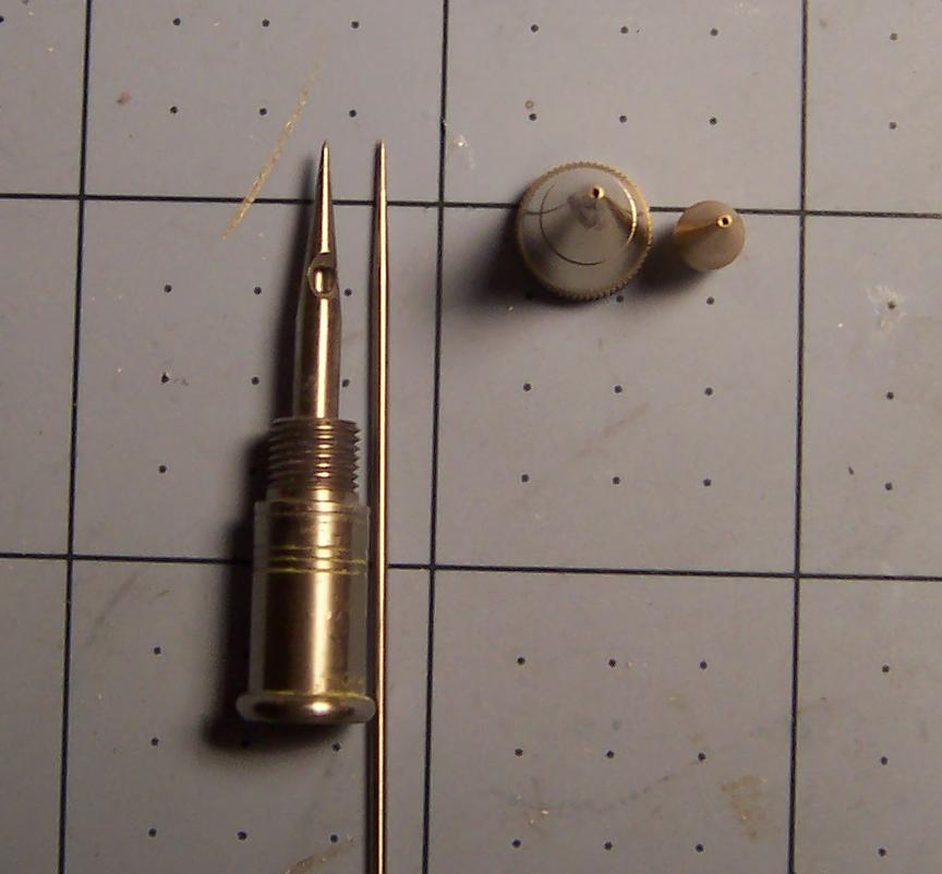

fseva Posted May 31, 2015 Posted May 31, 2015 3. The airbrush you use makes the biggest difference. Up until just recently I'd been using a Master dual action airbrush. It seemed like a real struggle to get the paint properly thinned and the pressure adjusted to the point where I'd get a good coat of paint. I finally gave up and bought a Paasche series H "external mix" single action airbrush. I decided on that one because I'd seen some very accomplished painters using it in their Youtube videos. The difference is like night and day. The Paasche is a pleasure to use. It has no trouble spraying whatever I've tried so far, and the results are much better and more consistent. I'll give you a dollar to a doughnut your Paasche simply has a larger needle/nozzle than the Master! That would make it easier to airbrush thicker paint!

Sidney Schwartz Posted May 31, 2015 Posted May 31, 2015 I'll give you a dollar to a doughnut your Paasche simply has a larger needle/nozzle than the Master! That would make it easier to airbrush thicker paint! Oooh...doughnut! Since the needle types are different I'm not sure you can do a direct comparison. In any case, the Master came with .3mm, .5mm and .8mm needles/nozzles, and I was using the .8mm...the smaller ones worked poorly or not at all. The Paasche came with .45mm, .64mm and 1.06mm needles/nozzles. I started with the 1.06mm, assuming I'd need the largest one for the craft paint. Turns out the 1.06mm sprayed too much paint and the .45mm works better, so that's what I'm using now. The Paasche also seems capable of spraying the craft paints without even having to thin them, although I'm still thinning them a bit so they'll self level nicely. Acrylics are working for me and clean up is very easy...all I use is water. They are also much less stinky and toxic. If I were to use laquer I'd probably have to have a painting booth with a vent, and that's a hassle and expense I don't need. Some of us don't have money to spend on whatever we would like to have. Let's please remember this is just a hobby. I'm not trying to convince anyone to change their mind. A question was asked and I related what my experience has been. If you're happy, I'm happy.
StevenGuthmiller Posted May 31, 2015 Posted May 31, 2015 Oooh...doughnut! Since the needle types are different I'm not sure you can do a direct comparison. In any case, the Master came with .3mm, .5mm and .8mm needles/nozzles, and I was using the .8mm...the smaller ones worked poorly or not at all. The Paasche came with .45mm, .64mm and 1.06mm needles/nozzles. I started with the 1.06mm, assuming I'd need the largest one for the craft paint. Turns out the 1.06mm sprayed too much paint and the .45mm works better, so that's what I'm using now. The Paasche also seems capable of spraying the craft paints without even having to thin them, although I'm still thinning them a bit so they'll self level nicely. Acrylics are working for me and clean up is very easy...all I use is water. They are also much less stinky and toxic. If I were to use laquer I'd probably have to have a painting booth with a vent, and that's a hassle and expense I don't need. Some of us don't have money to spend on whatever we would like to have. Let's please remember this is just a hobby. I'm not trying to convince anyone to change their mind. A question was asked and I related what my experience has been. If you're happy, I'm happy. I think we all understand Sidney. No one should try to change your mind. Everyone has their own way of operating & that's cool. Whenever a topic is started, you're going to get a myriad of advice & opinions & that's the whole point of a forum like this. Even when 90% of what others say may not appeal to you, there's always that 10% chance of nice little "nugget" popping up that could be very useful. You're right, Whenever you're using lacquers, it opens a whole new page on what's needed to operate. If the acrylics are working for you, why change it. Steve

fseva Posted June 1, 2015 Posted June 1, 2015 Oooh...doughnut! Since the needle types are different I'm not sure you can do a direct comparison. In any case, the Master came with .3mm, .5mm and .8mm needles/nozzles, and I was using the .8mm...the smaller ones worked poorly or not at all. The Paasche came with .45mm, .64mm and 1.06mm needles/nozzles. I started with the 1.06mm, assuming I'd need the largest one for the craft paint. Turns out the 1.06mm sprayed too much paint and the .45mm works better, so that's what I'm using now. The Paasche also seems capable of spraying the craft paints without even having to thin them, although I'm still thinning them a bit so they'll self level nicely. Acrylics are working for me and clean up is very easy...all I use is water. They are also much less stinky and toxic. If I were to use laquer I'd probably have to have a painting booth with a vent, and that's a hassle and expense I don't need. Some of us don't have money to spend on whatever we would like to have. Let's please remember this is just a hobby. I'm not trying to convince anyone to change their mind. A question was asked and I related what my experience has been. If you're happy, I'm happy. Sorry for offending you, Sidney... I didn't mean to sound contentious; I was just sure that I had the reason for the difference in airbrushes (not being the brushes themselves, but rather the tip sizes). I can see, now that you've given the sizes, it was surely not that, that makes the Paasche better at spraying craft paints. Especially if you're using a .45mm setup, which is just a bit finer than my Patriot. And you don't thin very much? What in your opinion makes the difference then? Is it that the paint is being atomized when it's already in the air?
Sidney Schwartz Posted June 1, 2015 Posted June 1, 2015 Sorry for offending you, Sidney... I didn't mean to sound contentious; You didn't offend me and I didn't think you were being contentious. I was trying to head off any potential conflict and should have just kept my big mouth shut. My apologies. As for why this airbrush works so much better, I'm very ignorant about the mechanics of all this. I think the two types of airbrushes are actually similar in that in both the air is blown past the tip of the needle, and that draws out and atomizes the paint. The instructions for the Paasche say to use 40psi for heavier paints, but I've been using 25-30psi and it works fine. Maybe one of the more experienced folk here know why one brush works better than the other.
fseva Posted June 1, 2015 Posted June 1, 2015 (edited) You didn't offend me and I didn't think you were being contentious. I was trying to head off any potential conflict and should have just kept my big mouth shut. My apologies. As for why this airbrush works so much better, I'm very ignorant about the mechanics of all this. I think the two types of airbrushes are actually similar in that in both the air is blown past the tip of the needle, and that draws out and atomizes the paint. The instructions for the Paasche say to use 40psi for heavier paints, but I've been using 25-30psi and it works fine. Maybe one of the more experienced folk here know why one brush works better than the other. No problem, Sidney! I appreciate our banter! In regard to the mechanics of airbrushes, could it be that the Paasche actually allows you to use the higher pressure? My airbrushes control the upper end of the air pressure my compressor can pump out - even if I have the compressor set to 40psi, the airbrush won't use more than 20psi. Consequently, my airbrushes can't spray the thicker paints that need 30-40psi to correctly atomize!? I remember trying Auto Air (they actually recommend higher air pressure), and not being able to apply them without thinning them to practically transparency - I thought my problem was tip size - I bought a Badger Crescendo with a 1.5mm tip. That did make it easier to airbrush them, and they didn't have to be thinned that much, but I still wasn't that impressed - maybe, like you said, it was blowing too much paint, and I felt like I was losing control... hmmm... could be. Maybe that's the main difference between single and double action, where the latter has to restrict air pressure because of the internal mix. Sure would like an expert to weigh in here right now... Edited June 1, 2015 by fseva

Miatatom Posted June 1, 2015 Author Posted June 1, 2015 I use a Badger Patriot 105 with a 0.5 needle and tip. http://www.chicagoairbrushsupply.com/bapaaise.html I'm thinking this is the wrong brush to try to spray this stuff. The Paasche H seems to be the preferred AB.

fseva Posted June 2, 2015 Posted June 2, 2015 I use a Badger Patriot 105 with a 0.5 needle and tip. http://www.chicagoairbrushsupply.com/bapaaise.html I'm thinking this is the wrong brush to try to spray this stuff. The Paasche H seems to be the preferred AB. I also use a Badger Patriot! I found that it was not really capable of airbrushing thick paints without thinning them into practical transparency. It would seem that if you're going to stay with the thicker paints, you'll probably have to go with some form of "external mix" airbrush (see my message to Sidney). The solution to my problem with acrylics (after having purchased an airbrush with a 1.5mm tip) was to use thinner viscosity paints - and that became... for me... lacquers. Granted, I do have to be concerned with fumes, but I always used a spray booth, and I added a Honeywell air purifier to the spray area, which I can turn on only when it's needed, and that works for me.
