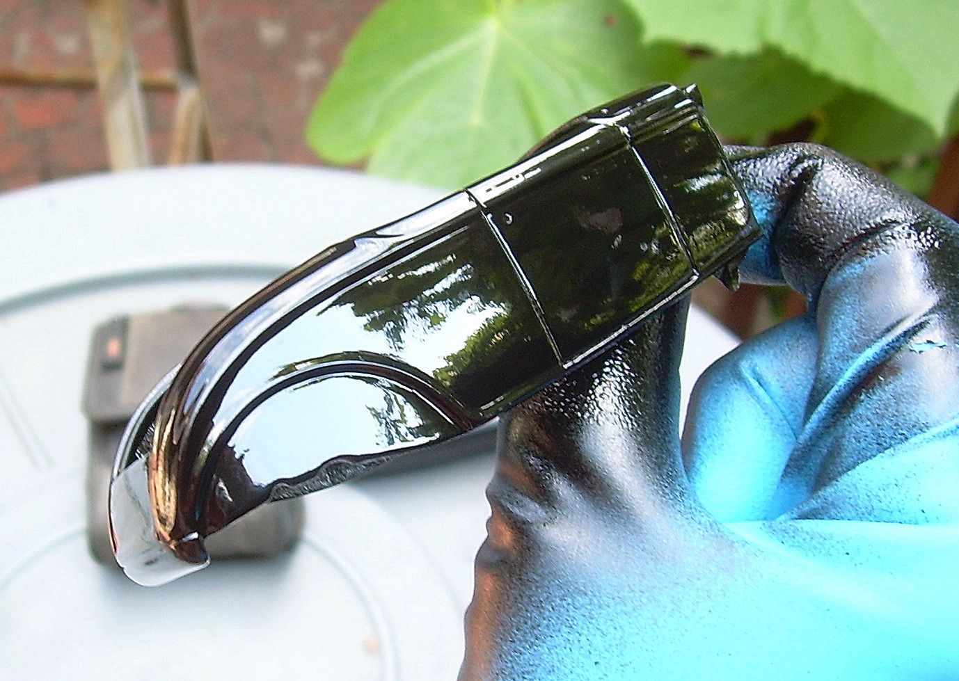

gtx6970 Posted June 13, 2015 Posted June 13, 2015 (edited) This is some cheap rattle can stuff I had laying around...I think it came from true value Edited June 13, 2015 by gtx6970
