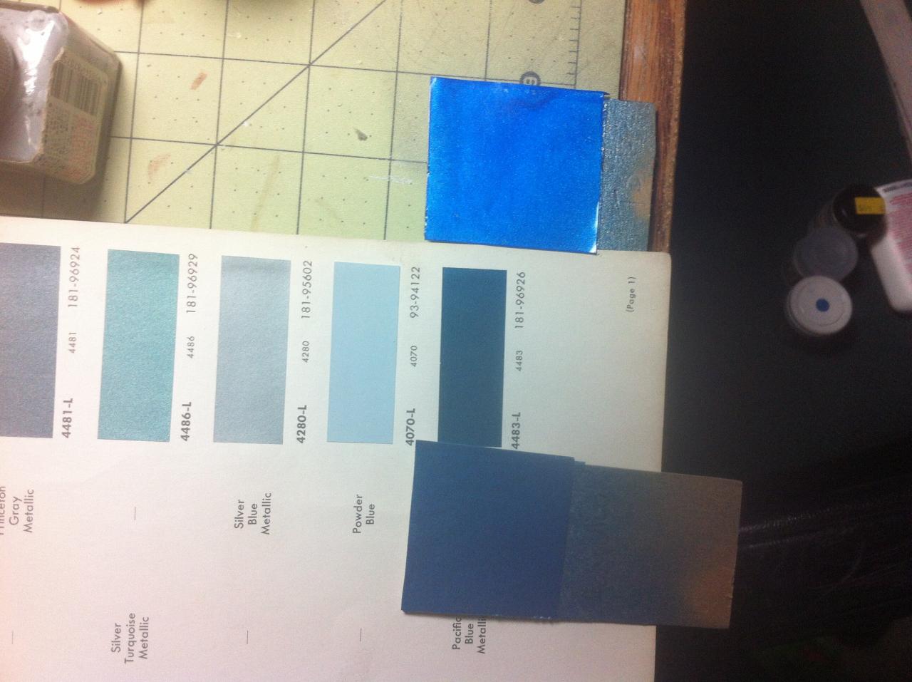

Brett Barrow Posted June 9, 2015 Posted June 9, 2015 I have a chip of Guardsman Blue, and it's very subdued like a steely blue. I think Tamiya and Model Master lacquers are all too vivid a blue.
Brett Barrow Posted June 9, 2015 Posted June 9, 2015 (edited) Actually Model Master Lacquer Ford Acapulco Blue is very, very close, just tested it out. Getting even better as it dries. They could label it as Guardsman Blue and I doubt anyone would complain. Tamiya TS-50 is too vivid. That's the only Tamiya medium met blue I have handy. Edited June 9, 2015 by Brett Barrow

Brett Barrow Posted June 9, 2015 Posted June 9, 2015 (edited) TS-51 you mean? Too dark, too blue. TS-19 is probably the closest in Tamiya. I dug out a can and sprayed a test, it's very similar to TS-50. Similar in shade, just a bit too vivid for Guardsman Blue. Edited June 9, 2015 by Brett Barrow

Brett Barrow Posted June 9, 2015 Posted June 9, 2015 (edited) That's the Acapulco Blue on the left and TS-19 on the right (or top if it flips my pic). TS-19 or TS-50 would probably be closer over a dark base like black or gunmetal, these are on white. TS-51 Is a bit darker than -19/50 but still very blue I thought I had a can, I know I've used it before. Scratch that, I think TS-51 over Gunmetal might be the way to go in Tamiya after checking out that link above. Edited June 10, 2015 by Brett Barrow
Brett Barrow Posted June 9, 2015 Posted June 9, 2015 or you could try TS-51 Racing blue over different base metallics, like this guy: http://zerofourgundam.blogspot.fr/2012/01/mg-qant-wip-tamiya-base-coats-and-blues.html (The TS-51 is at the right hand end in the pics) It looks very different over mica silver than it does over gunmetal or black. I'd try it with Polished Aluminium as well... bestest, M, Yeah, TS-51 over Gunmetal looks good, the middle spoon in that first pic. I might be remembering it darker than it really is, I just remember it being too dark for a Moto GP bike Tamiya recommended it in the instructions of.
