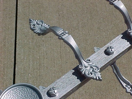

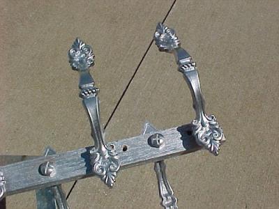

astroracer Posted June 15, 2015 Posted June 15, 2015 Get some CHROME look spray paint. Now wait... hear me out. Prep your parts and spray the paint. I will usually decant this stuff and use an airbrush as it comes out of the can very heavy. Once it sets up, (give it a day or two) shoot some clear on it. The clear mutes it down and what you end up with is a nice cast or brushed aluminum finish. Here are before and after pics of some cabinet handles I painted for a bench I built out of an old bathroom cabinet. The first one is the chrome paint and the second is after clearing. Of course you could always use the Alcad cast or brushed aluminum paint but that's too easy, right? Mark
