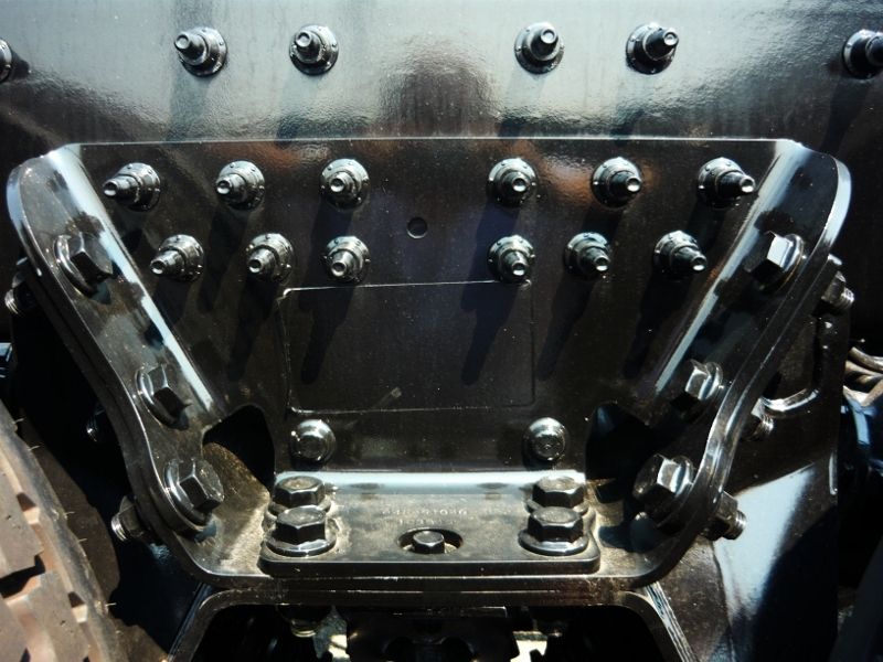

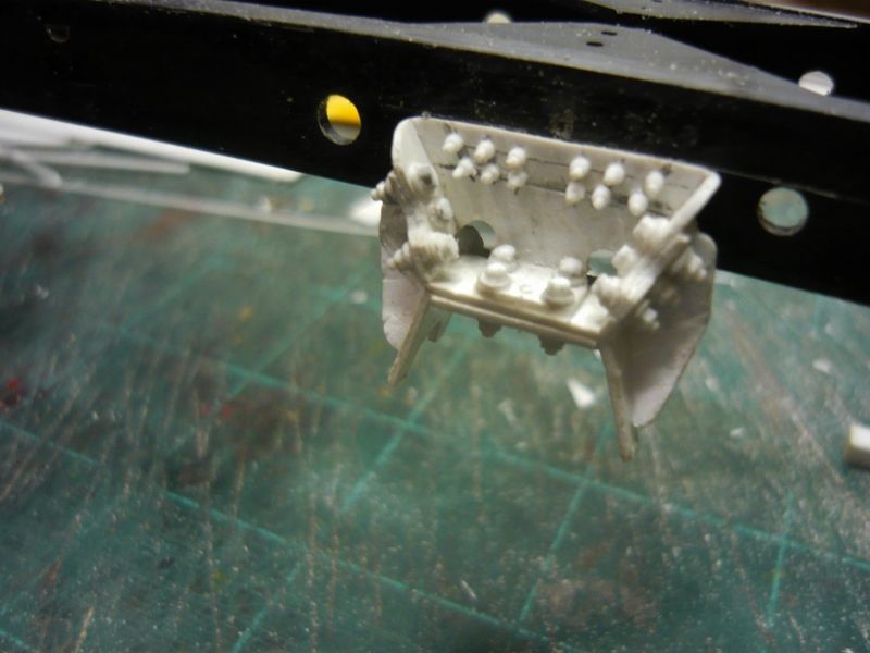

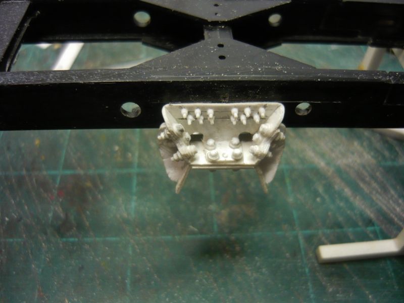

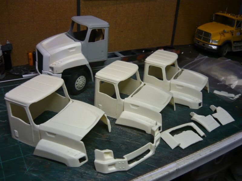

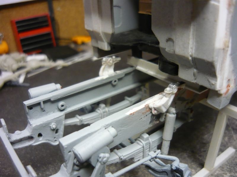

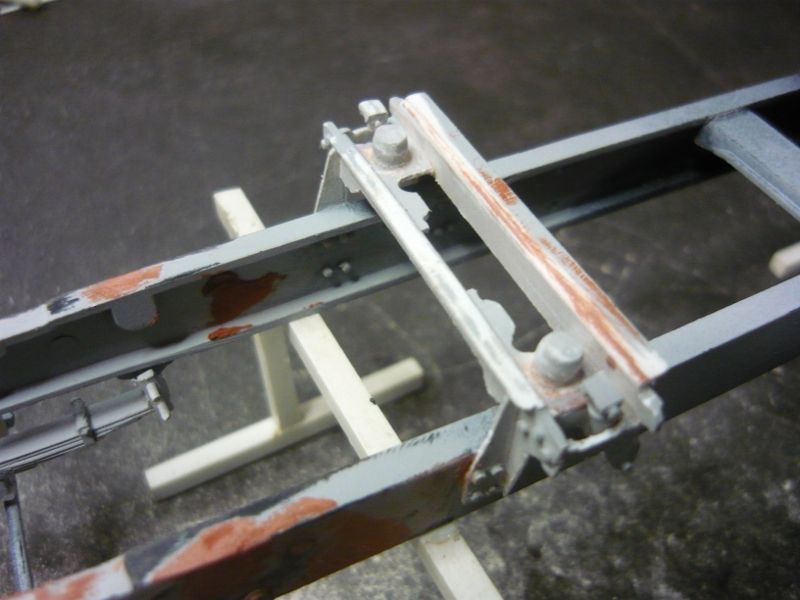

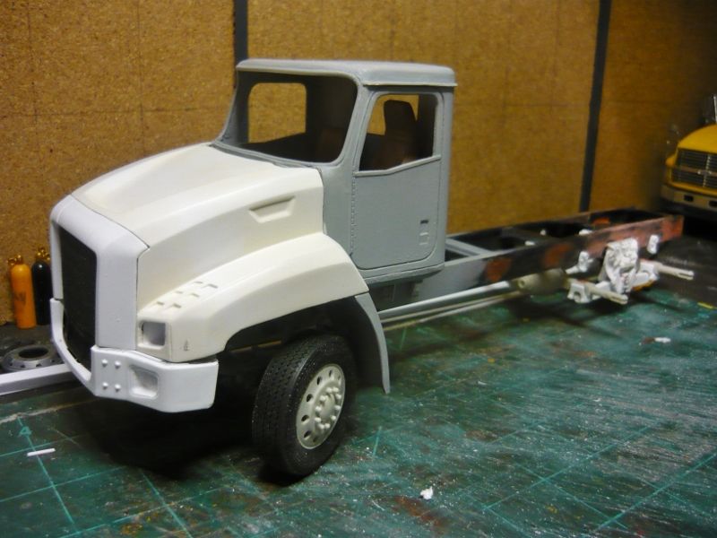

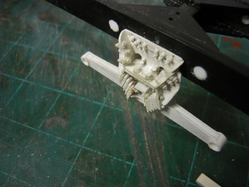

mackd Posted September 4, 2015 Author Posted September 4, 2015 (edited) Good the Hood went to the molding. I have completed another long step. It is one of the reasons why I do not intend to do a lot of this model. The cab supports are rather special. [ Edited September 8, 2015 by mackd
72 Charger Posted September 4, 2015 Posted September 4, 2015 Alain Will the cab n hood be sold as a kit ? If yes how much will it run at ?
gatorincebu Posted September 4, 2015 Posted September 4, 2015 Looking really good now Alain! Be Well Gator

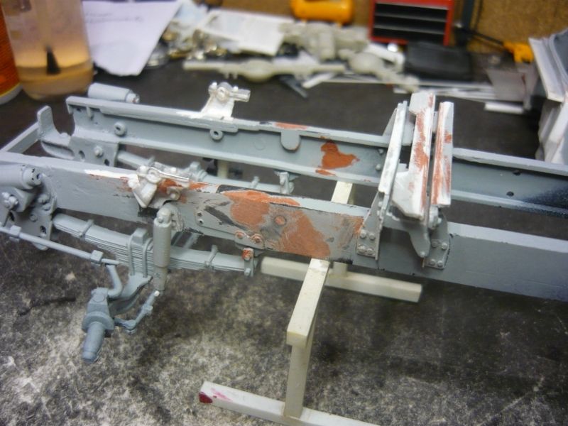

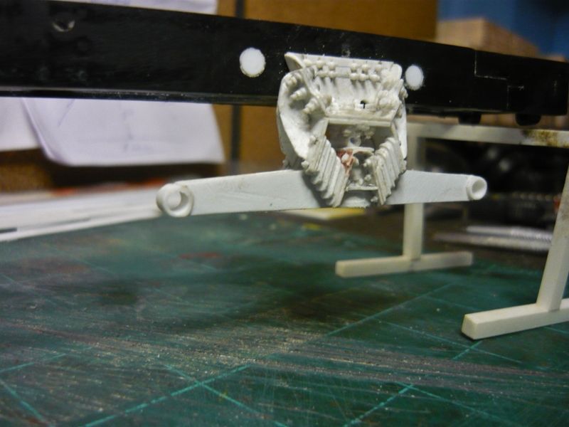

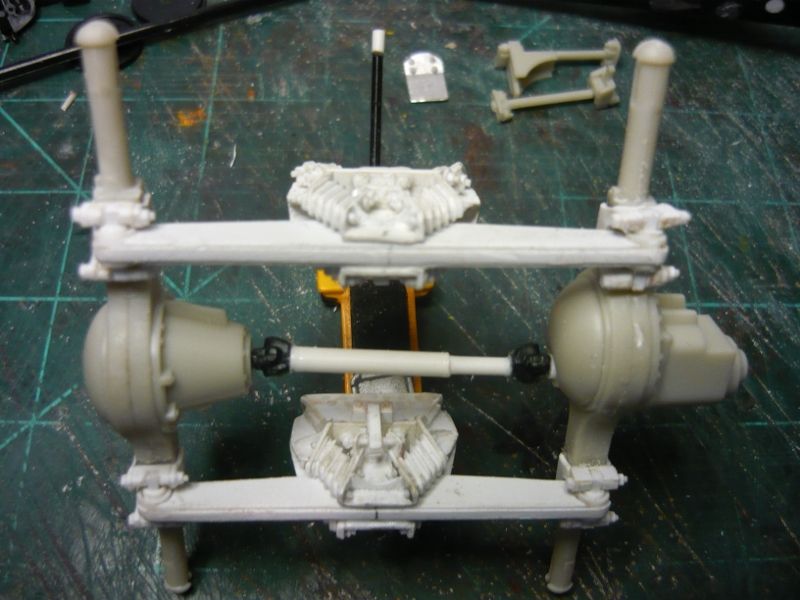

mackd Posted September 17, 2015 Author Posted September 17, 2015 (edited) I just finished the first part of my rear suspension for the CAT. I am not sure that I'll do another kit. It is too much work Edited September 17, 2015 by mackd

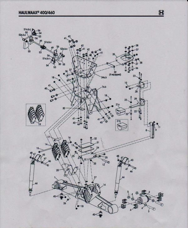

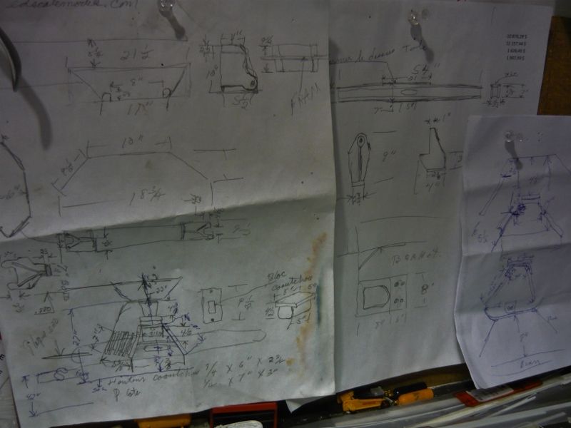

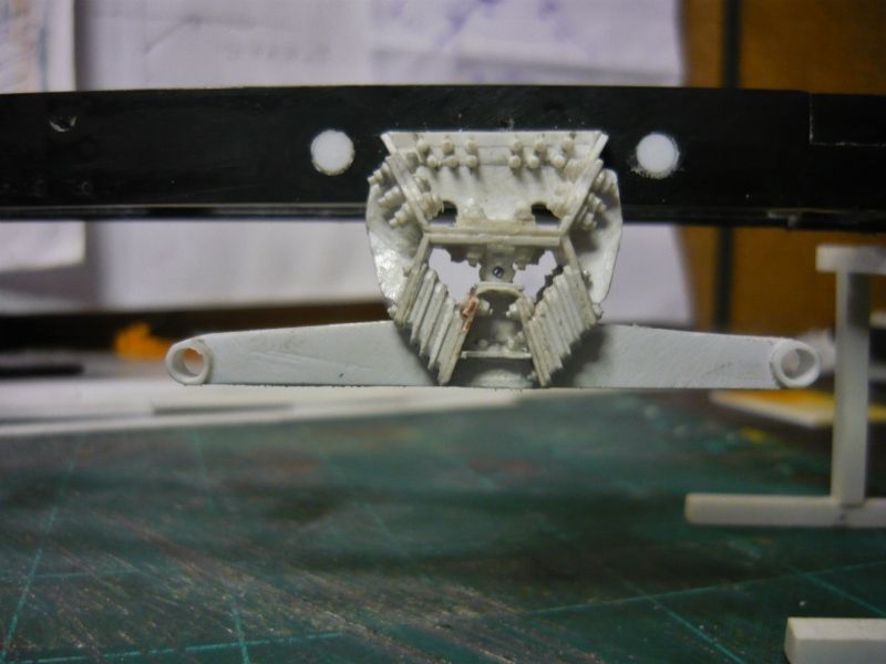

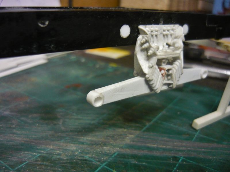

mackd Posted September 23, 2015 Author Posted September 23, 2015 (edited) Thank you: Brian,Marc,Dennis,Gordon,and Jaroslav, for your comments. Here is finish my proto type of suspension. Rest the two stoper after fram make, then make the copy for the entire kit. as I said previously it will be impossible to cast the entire piece, it is possible that I am a master mold in twelve parts, but without bolts. It is a possibility. My sketch of the suspension Edited September 23, 2015 by mackd

mackd Posted September 25, 2015 Author Posted September 25, 2015 (edited) There are three lengths. 54 "= 60" = 72 ". I have done a 60 "to see the suspension.Here in the normal Quebec is 54 " Edited September 25, 2015 by mackd

mackd Posted September 26, 2015 Author Posted September 26, 2015 Marc, I do not know yet if I'll sell this master. The reason is that it is impossible to mould the suspension assembled. The solution the moulding in twelve parts but without bolts. Two guys want the master now, I do not know if they will be interested without bolts. the other question, how much they will offer me for the kit? I do not sell my master, if I sell the kits made a hand. They may be more expensive but will be complete.Alain.

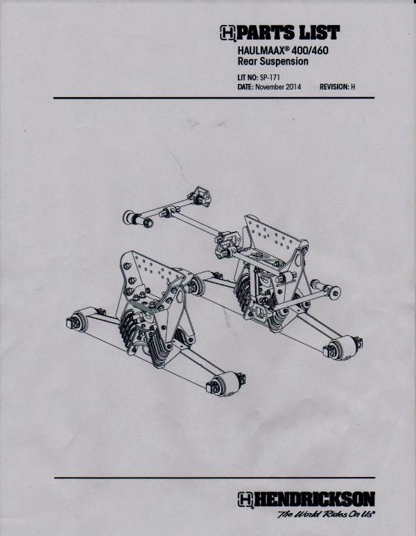

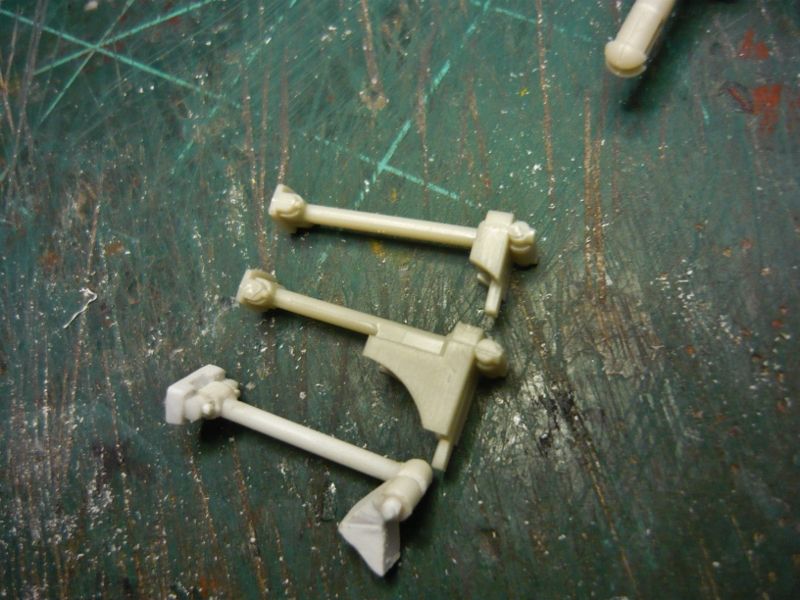

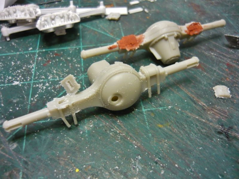

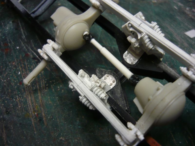

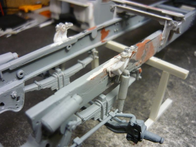

mackd Posted October 17, 2015 Author Posted October 17, 2015 For my suspension I used the rear axles of the Prostar. I made more realistic stabilisation bars. I placed in difficulty I had forgotten to do the safety straps. I received my first plays Dave Carey. Dave has done a great job of molding. It is a master of casting.
