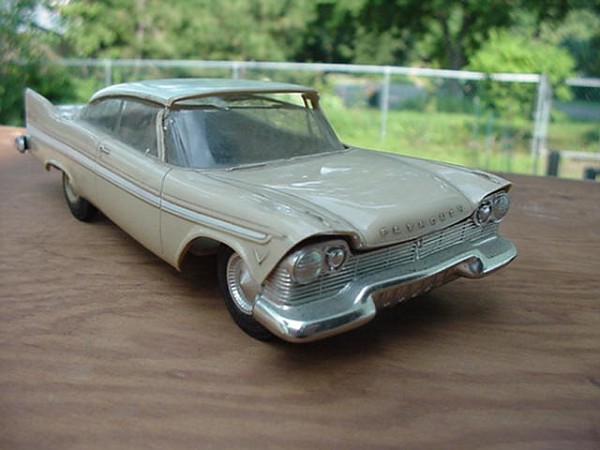

Tom Geiger Posted June 22, 2015 Posted June 22, 2015 Here's some examples I own that I got in a collection. As you can see, there's no saving them. This is the reason I don't collect old promos. The '57 Plymouth body is so warped that the top has popped off. And the remainders don't have a single straight panel!

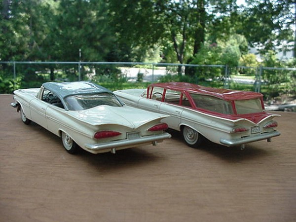

ranma Posted June 23, 2015 Posted June 23, 2015 Here's some examples I own that I got in a collection. As you can see, there's no saving them. This is the reason I don't collect old promos. The '57 Plymouth body is so warped that the top has popped off. And the remainders don't have a single straight panel! In the case of the 59 impala two door In all fairness It could be saved. I have done this on a warped 60 impala 4 dr. Take it completely apart carefully useing a flexable grill lighter , directly heat the warped area. Carefull around the the window edge and push warped area back down keeping even pressure untill cooled will help reove the warpage to a less noticeable look. same could be done to the wagons roof But again useing exstream care when doing so.
HotRodaSaurus Posted June 24, 2015 Author Posted June 24, 2015 Here's some examples I own that I got in a collection. As you can see, there's no saving them. This is the reason I don't collect old promos. The '57 Plymouth body is so warped that the top has popped off. And the remainders don't have a single straight panel! OOOOH, I would love that wagon as a kit
