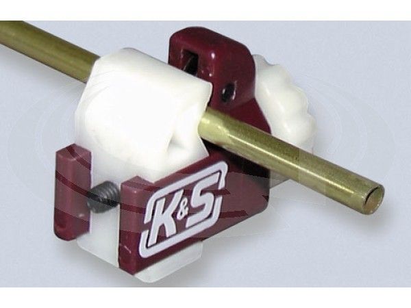

GeeBee Posted June 23, 2015 Posted June 23, 2015 Here's the K&S tool I have, don't use it that often, but when I do, it give a good cut, and of course the end is always true, so no filing is necessary
Ace-Garageguy Posted June 23, 2015 Posted June 23, 2015 Here's the K&S tool I have, don't use it that often, but when I do, it give a good cut, and of course the end is always true, so no filing is necessary Nice tool. I haven't seen that particular one before, but in function, it's a scaled-down version of the ones we use for fuel, brake and other metallic tubing in the real-car world. This type of cutter does tend to crimp the tube somewhat at the cut, so the inside of the tube may still need to be dressed.
BirdWatcher Posted June 23, 2015 Posted June 23, 2015 Nice tool. I haven't seen that particular one before, but in function, it's a scaled-down version of the ones we use for fuel, brake and other metallic tubing in the real-car world. This type of cutter does tend to crimp the tube somewhat at the cut, so the inside of the tube may still need to be dressed. This phenomena has reared it's ugly head more than once for me. Try a cut so you can see how much or how little the cut end rolls down, careful not to clean up the tube beyond the dimensions you require. Sometimes I use my Zona saw and a mitre box, just depends which cigar box is closest to me.
landman Posted June 23, 2015 Author Posted June 23, 2015 I have a little cutter like the one on the right but it doesn't work with anything under 1/8" and even that is tricky. I have used all the methods described above. My next move was going to be a cutting disc in the rotary tool but how do you hold the 1/16" end? I suppose you could put your short piece in the vise and cut flush to the vise.
Foxer Posted June 23, 2015 Posted June 23, 2015 I have used all the cutting methods mentioned and have just settled on using my finetooth razor saw in a holder I got from Micro Mark a number of years ago. I don't know what it was called or can find it in their current catalog. I have tried using the "roll xacto knife back and forth method" but find the knife easily slips off track for a 90 degree cut. I find this to be the least accurate method though I know many swear by it. I have the K&S tube cutter but have never used a tube large enough to try it. It does not work on the small tubes I mostly use. Without checking I'd say the smallest tube It will work on is about a quarter inch. Maybe someone can enlighten us on the smallest size. I do use my miter box and razor saw a lot, but the smallest tubes work very well in the tube holder. The end slides out and is clamped by a screw on the side to set length for repeat cuts. The top little lever flips away and then sit atop the tube in the vee and holds it in place. The saw goes into the narrow slot and is easy to keep straight as it's just slightly wider than my 32 tooth razor saw blade. I hold the handle and place it against my bench and saw away. Of course the ends need dressing like any saw cut.
