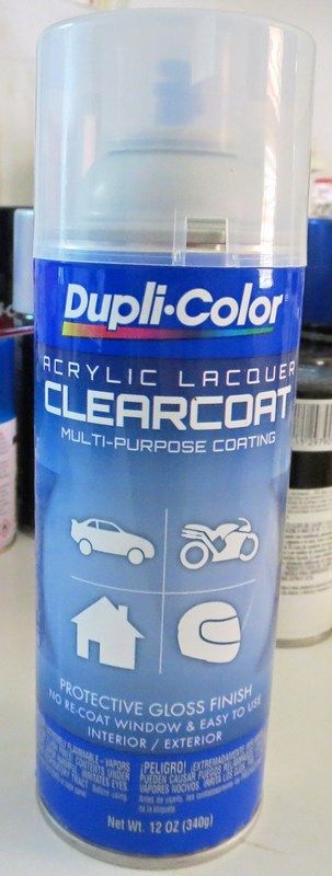

Speedfreak Posted June 24, 2015 Posted June 24, 2015 (edited) I applied this stuff 4-5 days ago over some Dupli-Color Color Match paint and it never did feel completely smooth (slick) to me, it was glossy but felt like a thin rubber coating to the touch. I wanted to show it to a friend today and wrapped it in some toilet paper so it wouldn't get scratched, upon arrival and taking it out of the box there were paper fibers all over it, so , I washed it off. For the journey back home i wrapped it in a paper towel and found upon my arrival there that the 'basket weave' pattern of the paper towel had attached itself to the surface along with more paper fibers. That was it, the body is in an alcohol bath. Does this stuff ever dry hard? If so, how long does it take? I've never used this stuff before, and , at this point I'll 'never' use it again. Edited June 24, 2015 by Speedfreak
Longbox55 Posted June 24, 2015 Posted June 24, 2015 How was the humidity in your area when you sprayed it? I recently ran into the same issues on a build from last week I was trying to get finished before a club meeting. didn't get fully dry until the day after the meeting (2 full days after last coat) after the humidy dropped a bit. I had never had problems with that clear before.
JollySipper Posted June 24, 2015 Posted June 24, 2015 I've ruined two WIPs by using that stuff..... That's been several months ago, and those bodies are still tacky......
Speedfreak Posted June 24, 2015 Author Posted June 24, 2015 (edited) Bill, the humidity was high when I applied the stuff, but , that was 4 days ago, and , since then the body has been inside my air conditioned home. So, you've used it before with success? I love Dupli-Color paints and am disappointed about this outcome. I'm tired of paying $7 for a 3oz can of Tamiya Clear! I've ruined two WIPs by using that stuff..... That's been several months ago, and those bodies are still tacky...... LOL! Yikes! Edited June 24, 2015 by Speedfreak

Ace-Garageguy Posted June 24, 2015 Posted June 24, 2015 You'll have better luck with the Duplicolor clear that's specifically designed to be used over their car colors. Testors lacquer clears work very very well too. Never any issues, ever. This is Testors over Duplicolor, not polished...exactly as sprayed.

Longbox55 Posted June 25, 2015 Posted June 25, 2015 You'll have better luck with the Duplicolor clear that's specifically designed to be used over their car colors. Testors lacquer clears work very very well too. Never any issues, ever. I agree with you, Bill. I only had the acrylic lacquer on hand for use on a different non-model project that I used their black acrylic lacquer on. I gave it a try on a body I painted with Perfect Match partially just to test it out, and it seemed to work fine. Used it on later build that needed a clear, but I didn't want to fool with getting the airbrush out to use my usual Paint Shop clear (which also works great with Perfect Match) without issue. Only thing I can think of that was different was the high humidity, and perhaps that I was rushing the job a bit. It did cure fine after an extra day of cure time. However, it will not be my "go-to" clear for sure. More like "last resort".
Speedfreak Posted June 25, 2015 Author Posted June 25, 2015 (edited) Bill, (Ace) , they didn't have the 'Perfect Match' clear at the O'reilly where I've been buying my Dupli-Color auto paint, soooooooo , I thought the stuff I got was all they (Dupli-Color) had. I'll have to change auto parts stores and look for the ' Perfect Match' clear, which 'is' what I wanted to begin with, thanks. James, whats the drying time on that Acrylic Enamel? Edited June 25, 2015 by Speedfreak

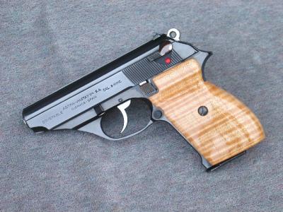

Mike_G Posted June 25, 2015 Posted June 25, 2015 (edited) BCLO125 is the part# you want The DAL1695 product actually works pretty well on wood, but yes it does take a long time to dry and even then it isn't super-hard but it does polish out okay I used it on these grips I made: Edited June 26, 2015 by Mike_G
