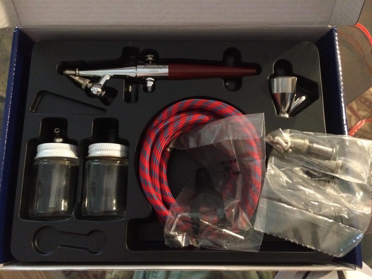

1hobby1 Posted June 30, 2015 Posted June 30, 2015 (edited) So today I pulled the trigger and bought the Paasche H Single Action Airbrush kit. I've read a lot of good reviews on this brush and it seems that as long as I take care of it properly I should be in the clear! I do have a few questions as a newbie to airbrushing. I have a portable booth I made using a bilge blower and while it works great for over spray, fumes from the spray cans stunk up the room even with the window open. How are the fumes from an airbrush compare to spray cans? Will the water based paints have less odor? I would love to be able to paint indoors without odors. Hoping this will solve my problem for rainy day and the winter months. Also I try to stay clear of harbor freight for most of the time depending on the purchase, but I've heard that they actually have a decent air compressor for an airbrush that is very reasonably priced. have any of you used it before? If so, how has it been treating you? Thanks guys! - Steve Edited June 30, 2015 by 1hobby1

Krazy Rick Posted June 30, 2015 Posted June 30, 2015 image.jpg So today I pulled the trigger and bought the Paasche H Single Action Airbrush kit. I've read a lot of good reviews on this brush and it seems that as long as I take care of it properly I should be in the clear! I do have a few questions as a newbie to airbrushing. I have a portable booth I made using a bilge blower and while it works great for over spray, fumes from the spray cans stunk up the room even with the window open. How are the fumes from an airbrush compare to spray cans? Will the water based paints have less odor? I would love to be able to paint indoors without odors. Hoping this will solve my problem for rainy day and the winter months. Also I try to stay clear of harbor freight for most of the time depending on the purchase, but I've heard that they actually have a decent air compressor for an airbrush that is very reasonably priced. have any of you used it before? If so, how has it been treating you? Thanks guys! - Steve Perfect choice. Wear a good respirator / charcoal mask when spraying & be sure to replace the cartridges on a regular basis as needed. try to seal an area off with sheet plastic ( from ceiling to floor - have a panel of the heavy plastic with a slit as doorway ) - Seal off any vents to avoid any fumes entering other areas of the house. The ideal set up - use one window for fan & adjacent window that can be opened ( 2-3 inches is fine ) - for cross ventilation. Despite low fumes with water based paint, do not asume it is safer than solvent based paint - they still are made of harmful pigments, although they may have a different carrier than solvent based; you don't want them in your system & your pores & skin will readily absorb them. Take your time learning, try to adjust the airbrush & pressure until you get the results you desire. Expect mistakes & learn by them - they are part of the learning curve. Distance & speed of your passes are very important & once you get the feel of it, will become second nature. If you need help feel free to message me.
