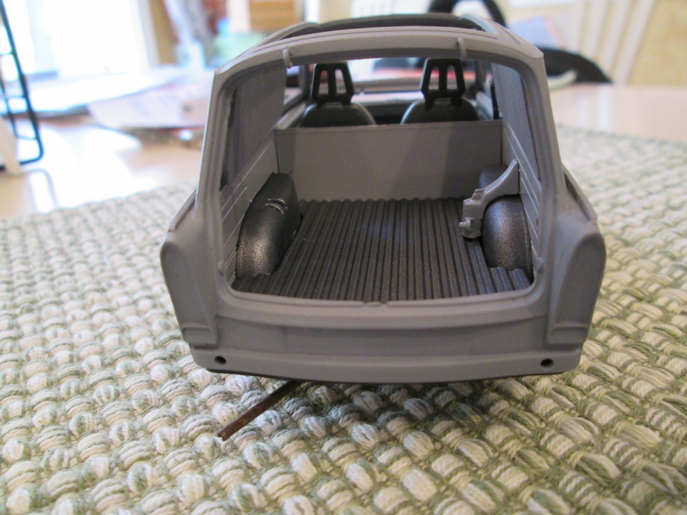

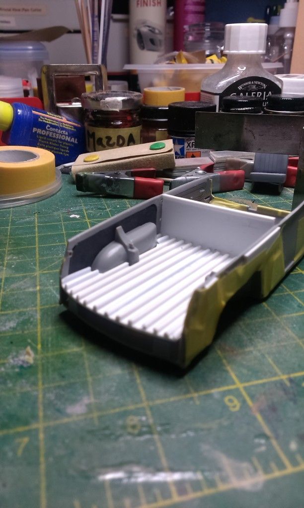

Tom Geiger Posted August 4, 2015 Posted August 4, 2015 Hosted on Fotki Geoff- Here's how I did the bed. As you said, I don't have any information and am assuming it would be a ribbed surface. I used an Evergreen pattern for this.

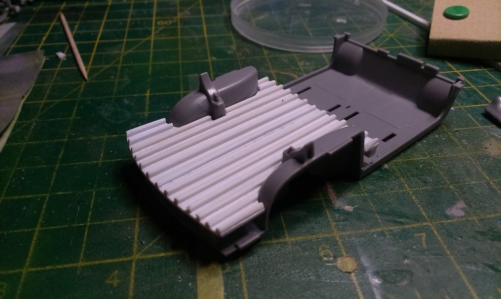

GeeBee Posted October 4, 2015 Author Posted October 4, 2015 Well a few weeks ago i popped into HobbyCraft, but they only sell styrene sheet these days, no strip or anything that would make the floor panel the easy way, so I bought some 40 thou' styrene sheet and ordered some 1.5mm strip on eBay, I spent this afternoon glueing and cutting strip to size, i will leave them to dry up before starting to sand their edges to take off the squareness of them, as I would imagine that being a pressed panel they wouldn't be square in profile, the centre rib has been already profiled

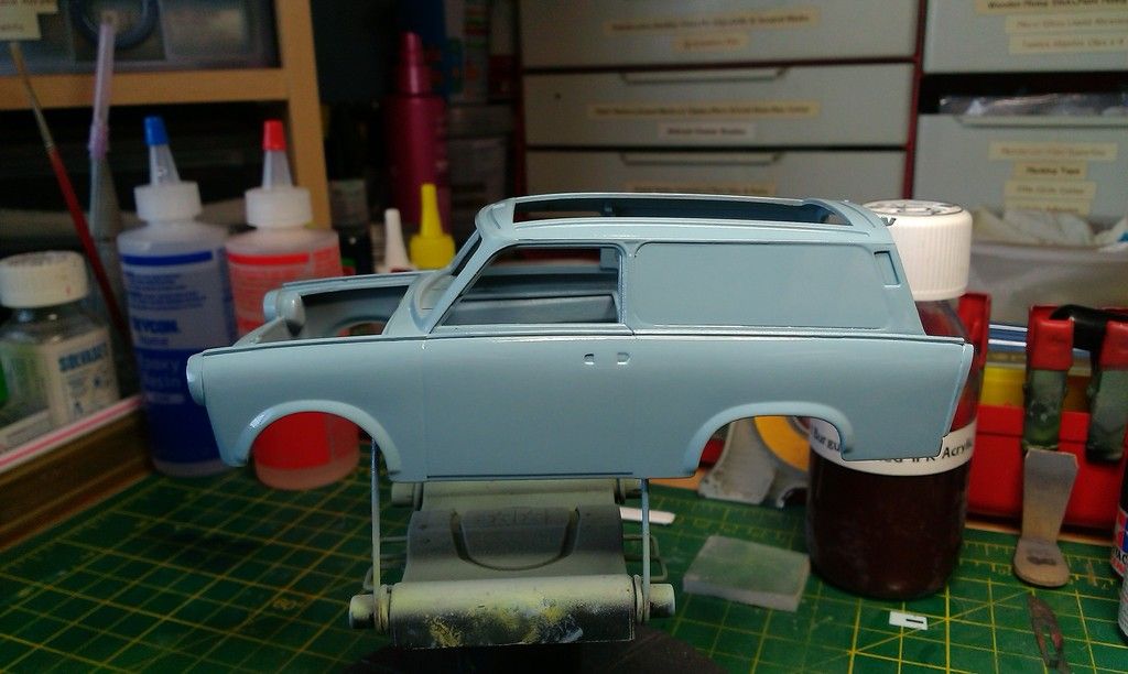

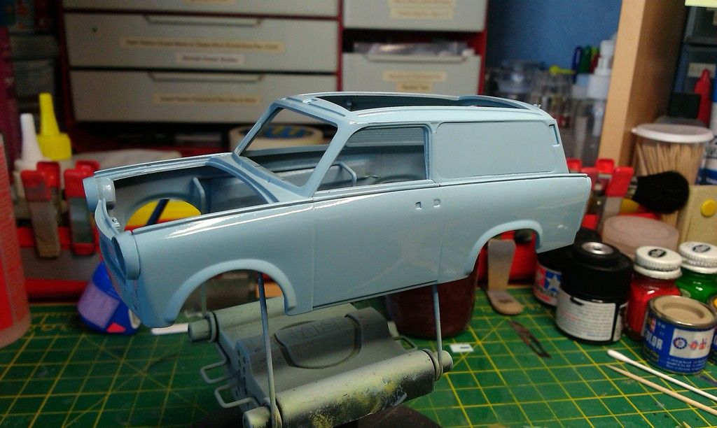

GeeBee Posted January 30, 2016 Author Posted January 30, 2016 (edited) Got a little paint on the body, it's genuine Trabant glacier blue, once all the body parts have been painted, they'll be put away until there dry, which can take a millennium, this is the only automotive paint I've used that you can thin and clean up using only white spirit, no a bad shine straight from the airbrush, but it will be a while until it's ready to be wet sanded and polished Edited February 2, 2016 by GeeBee

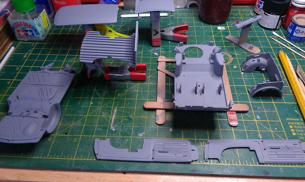

GeeBee Posted January 31, 2016 Author Posted January 31, 2016 Managed to get a few parts in primer this morning,
Ace-Garageguy Posted January 31, 2016 Posted January 31, 2016 Neat little car. I've been enjoying watching it come together. Paint looks great, too.
GeeBee Posted January 31, 2016 Author Posted January 31, 2016 Got all the parts that needed to be done in body colour painted and set aside to dry

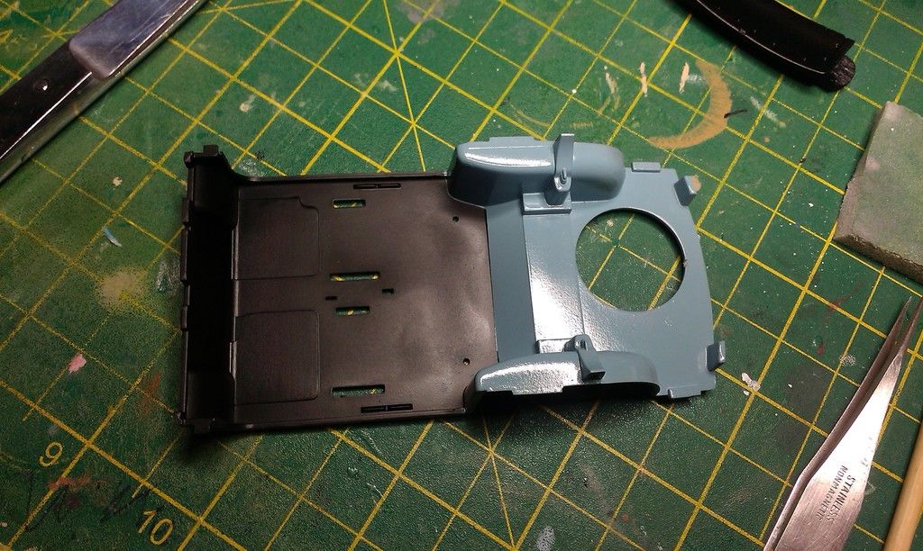

GeeBee Posted February 1, 2016 Author Posted February 1, 2016 I'm not sure if this paint, although made by the same people who originally made the paint for the real trabants, but this was airbrushed last night in body colour, and I managed to mask it up to paint the satin black floor, by this time, the blue had dried rock hard, and masking tape didn't peel any of the paint off, I had so much trouble early on with the Capri green Universal, I had to decant the paint into a glass bottle, as the valve had gone faulty, but the paint hasn't started to cure like the green and also the beige paint had started to do nearly straight after I had decanted it.
