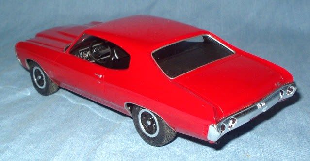

JTalmage Posted July 6, 2015 Posted July 6, 2015 (edited) I used Tamiya fine primer in light gray and it turned out great using their bright red. Took two coats to really cover everything without running it, but this is what it looks like... Edited July 6, 2015 by JTalmage

fseva Posted July 6, 2015 Author Posted July 6, 2015 I used Tamiya fine primer in light gray and it turned out great using their bright red. Took two coats to really cover everything without running it, but this is what it looks like... It's gorgeous! I'd use white primer then a coat of yellow before the TS-49 if I was going for the brightest red You're kidding? Why the yellow, and would it be a gloss or flat yellow... which yellow would you recommend?

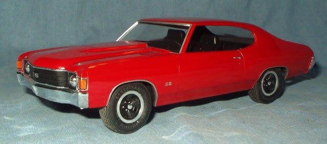

Snake45 Posted July 7, 2015 Posted July 7, 2015 You're kidding? Why the yellow, and would it be a gloss or flat yellow... which yellow would you recommend? I'd use Floquil Reefer Yellow (now discontinued, but I stashed up a few bottles) or Model Master Flat Insignia Yellow. I don't think the exact shade of yellow matters that much. (These are for airbrush, of course.) BTW, here's the last "bright red" paint job I did. I THINK I primed it with Model Master Rust, but there's a chance it was flat white--I can't recall for 100% certain. I DO remember that I laid just about an entire "little bottle" of Testor #3 Red on it--that's what it took to cover (with enough meat to polish it out).
Mike_G Posted July 7, 2015 Posted July 7, 2015 That's pretty bright alright- I think my rods and cones are oversaturated now
