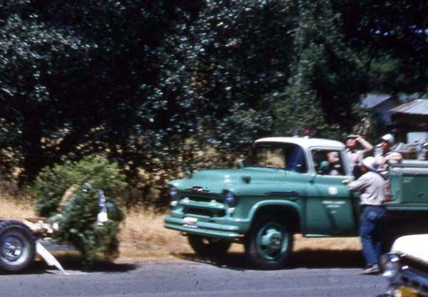

Aaronw Posted July 20, 2015 Author Posted July 20, 2015 (edited) I forgot about the grill. To further complicate things, I'm actually looking at a photo of a larger Chevy truck, a 1 1/4 or 1 1/2 ton which has an entirely different grill... Maybe this will be easier, can anyone identify the year of this truck? The US Forest Service switched from dark green to light green in the late 1950s. This is the oldest original truck (I'm not trusting modern restorations) that I've been able to find in the light green paint scheme. I have photos of 1954 / 1st series 55 Chevrolet trucks in the dark green paint scheme. Clearly the switch was made between 1955 and 1957, just trying to nail down the year. The photo says it was taken July 4th 1959 at a parade, so the truck is quite new in the photo and most likely delivered in that color. Photo is from USFS achieves, edited to better view the truck. Edited July 20, 2015 by Aaronw
mike 51 Posted July 20, 2015 Posted July 20, 2015 (edited) I'm pretty sure that's a '57. The hood emblem is your best (only?) clue. I found pics of two USFS pickups..a 57 and a 58-9 (Chevys) both light green with white roofs like in your pic.I also found pics of a 55 F100 panel with USFS markings but I kinda doubt it's legit.. Edited July 20, 2015 by mike 51
Aaronw Posted July 20, 2015 Author Posted July 20, 2015 It is weird I have a couple hundred vintage photos of USFS vehicles including dozens on either side of these three years, but I only have two period photos of vehicles from 1955-57, this one, and a Chevy flatbed (a side view so less helpful than the one I posted). Based on photos I know the change occurred after 1954 and no later than 1957, just looking for that elusive photo of a 1955 or 56 to find the exact year. I don't trust restorations for stuff like this, there are a few that have been really well done but most have minor to major accuracy issues. I'm pretty sure I know the '55 Panel truck you mentioned, not the most accurate restoration / clone out there... Thanks

Longbox55 Posted July 30, 2015 Posted July 30, 2015 It's a '56. Here's the clues that identify it. One, the flat hood. All '57 Chevrolet and GMC trucks have the twin "bullets" on the hood, whether they have the gunsight trim or not. The other giveaway clue is the side trim. That spear, which is 2 piece, is unique to the '56. The '55 2nds have a similar one peice side trim piece mounted lower on the fender, but only on the 1/2 through 1 ton pickups. Big truck, 1 1/2 and 2 ton only have the series number designation in chrome numbers on the fender. '56 got the spear on all trucks, 1/2 through 2 1/2 ton. The '57s have a different side trim, more of an elongated egg shape, with an oval towards the rear of the emblem with the series designation. It mounts in the same location as the '56, though. A third item is the hood emblem. Only used on '56 and '57, the giveaway is the color scheme, '56 is black with a red Bowtie, '57 is reversed, red with a black bowtie. http://www.stovebolt.com/gallery/ensrud_grant_1956.htmlhttp://www.stovebolt.com/gallery/droege_matt_1956.htm

Aaronw Posted July 31, 2015 Author Posted July 31, 2015 Thanks, so '56. I did find a photo that claims to be a '56 IH in the dark green, and another photo of a Chevy 4400 flatbed in the light green that appears to be a 1956 based on the hood and side emblems (also a NAPCO badge), although possibly the same truck with the pumper unit removed. They were designed to allow relatively easy conversion between a flatbed truck and fire engine as needed.I think it is fairly safe to say the change in paint happened at some point in 1956.
Longbox55 Posted July 31, 2015 Posted July 31, 2015 You have probably seen this before, right?http://www.shorpy.com/node/14005?size=_originalIt says August 59 but I belive that truck could be a 58.That one is a '59. The hood emblem and what you can see of the fender badge is the giveaway. Thanks, so '56. I did find a photo that claims to be a '56 IH in the dark green, and another photo of a Chevy 4400 flatbed in the light green that appears to be a 1956 based on the hood and side emblems (also a NAPCO badge), although possibly the same truck with the pumper unit removed. They were designed to allow relatively easy conversion between a flatbed truck and fire engine as needed.I think it is fairly safe to say the change in paint happened at some point in 1956.I don't think they are the same truck. The one you posted is not a Napco, but a standard 4000/6000 truck. The badge on this one that is below the model emblem is a V8 badge. Somewhat odd for a government vehicle.
