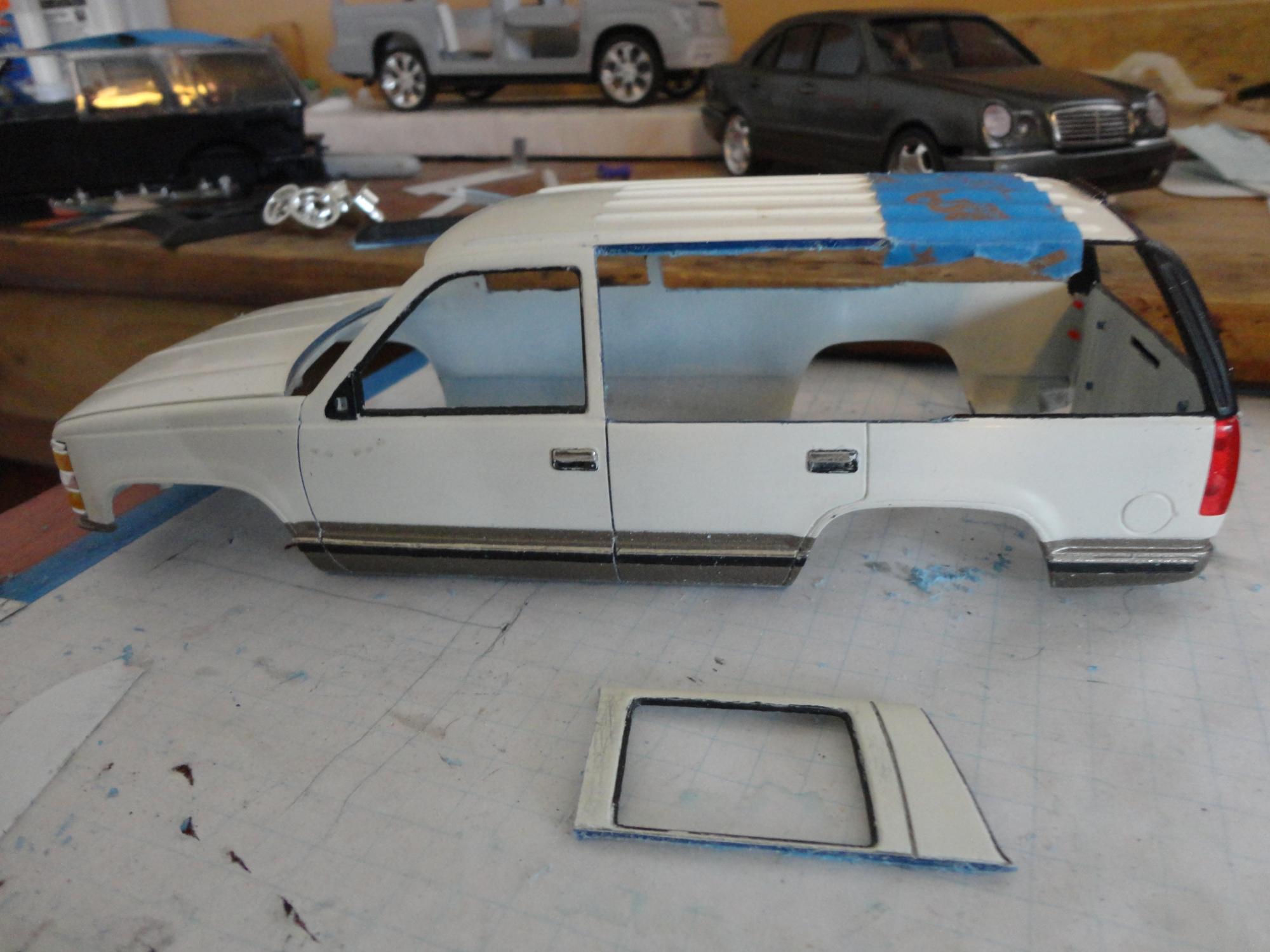

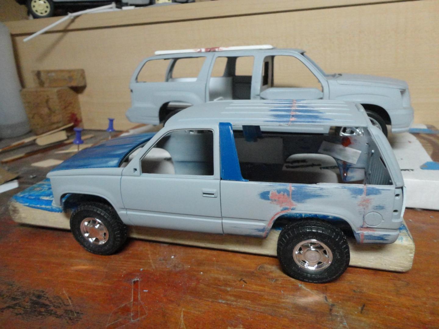

Perspect Scale Modelworks Posted July 26, 2015 Posted July 26, 2015 Here's my latest project. Hopefully I'll finish it before the A.D.D. kicks in. Taking the AMT 96 Chevy Tahoe Snap kit & converting it to the 2 door version. I've seen a couple of people here do this in the past Here's what I started with and where I am so far. I removed the step below the doors and cut the b-pillars just behind the front doors back to the c-pillars. I'll move the c-pillars up to the front doors then cut about 6 scale inches vertically from the rear doors and about 5 scale inches vertically between the rear wheel openings and the taillights. The leading edge of the blue tape is where I plan to cut the 11 inches out of the roof & move it forward. Once the body's done I'll focus on the interior tub & chassis.

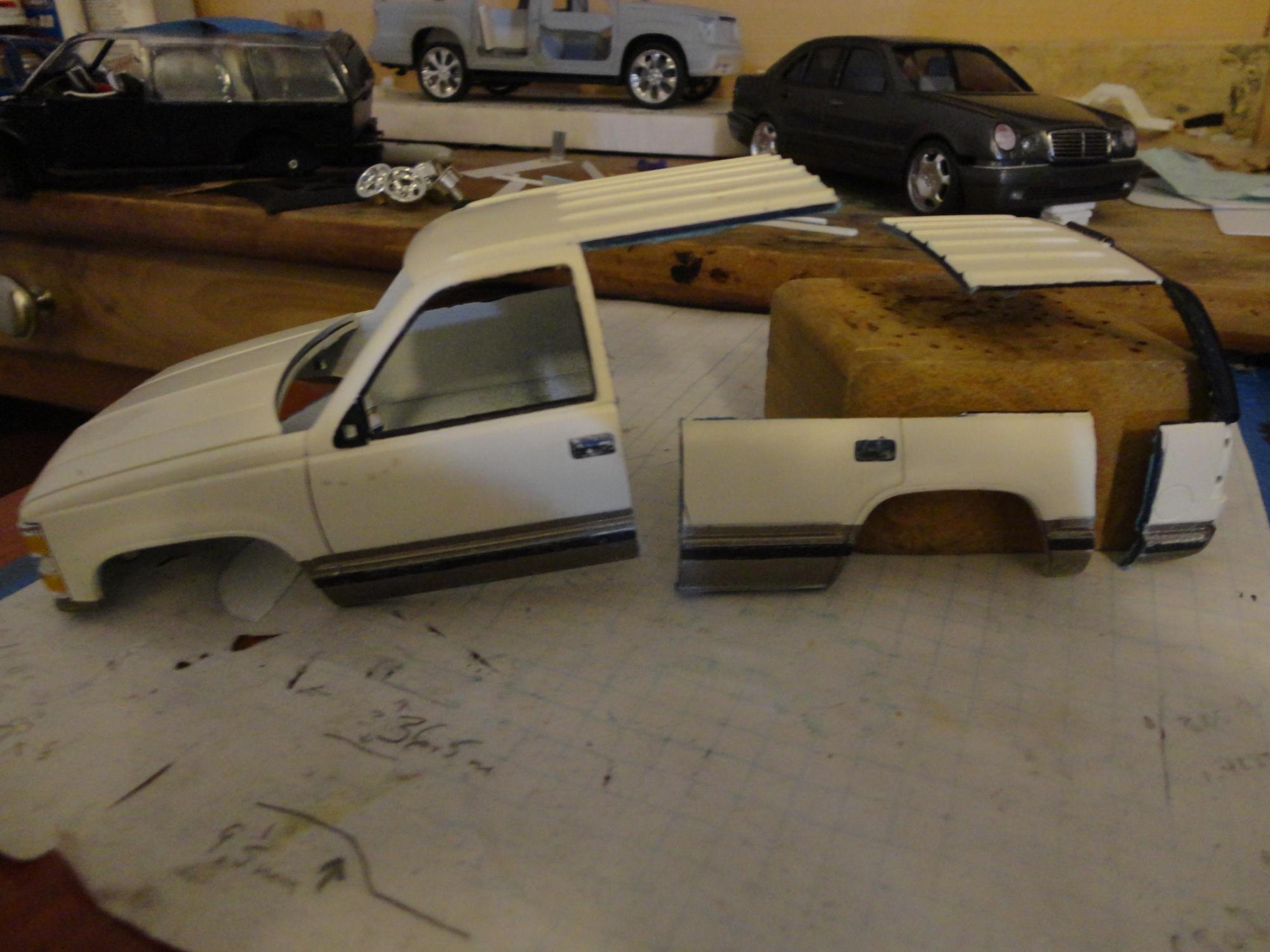

Perspect Scale Modelworks Posted July 27, 2015 Author Posted July 27, 2015 Thanks guys. It's actually going smoother than I thought. Dissected! Now to remove the extra inches from the roof, rear doors & behind the wheel openings. As long as I remember to measure (at least) twice & cut once, I should be OK. Thanks for tuning in. Keeps me inspired.

Perspect Scale Modelworks Posted August 2, 2015 Author Posted August 2, 2015 Thanks guys! Just a quick update. Soaked in Purple Power and removed the lower body side moldings. Next is to even up the cuts, glue it together, primer, filler and sanding.

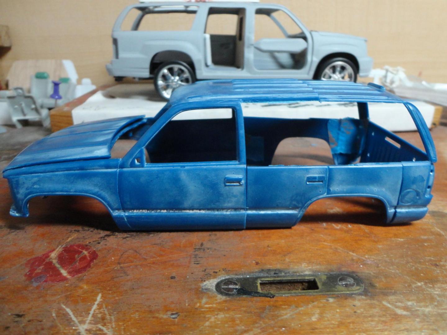

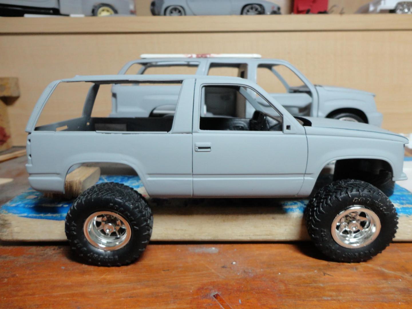

Perspect Scale Modelworks Posted August 7, 2015 Author Posted August 7, 2015 (edited) nice chop Jay! you going to have to make your own 3/4 windows? Thanks Dan and yeah, those windows are going to be a challenge with the curve at the roof line. I'm sure I'll go through a lot of clear plastic to get 'em right. Still a few spots to clean up but this is where we are. The wheels and tires are not what I'll be using, just trying to get an idea of the stance. I sent an email to Alan at Ma's Resin a few days ago but haven't heard back yet. I'm open to suggestions on the wheels & tires. Edited August 7, 2015 by Perspective Customs

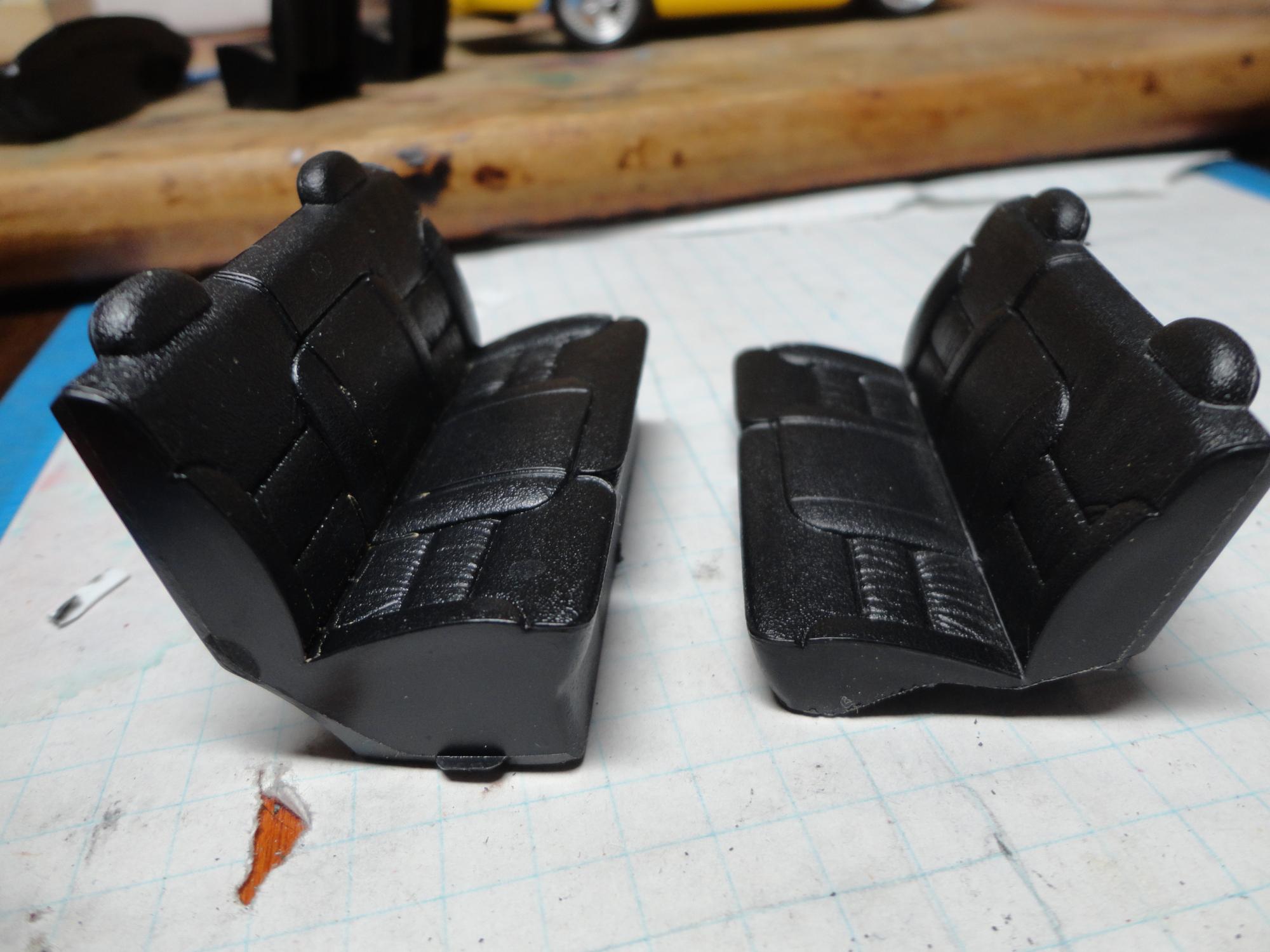

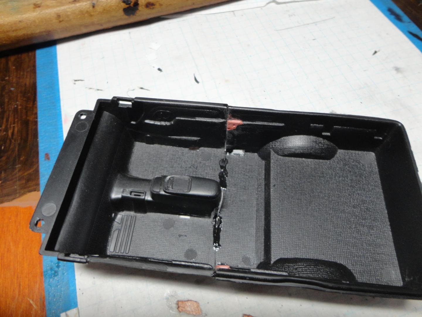

Perspect Scale Modelworks Posted August 9, 2015 Author Posted August 9, 2015 Starting on the interior. Not going to put too much detail into it since I plan on tinting the windows. I just cut a section out of the tub and chopped the rear seat down a bit.
