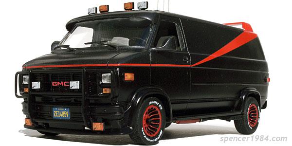

spencer1984 Posted August 3, 2015 Posted August 3, 2015 (edited) For the wheels on my A-Team van, I stripped the chrome, painted them flat black, painted the spokes flat red with a toothpick, and then clearcoated them to give them a glossy finish. The flat paints are thinner but layer better than gloss paints, and painting them wasn't nearly the headache I expected it to be. Edited August 3, 2015 by spencer1984

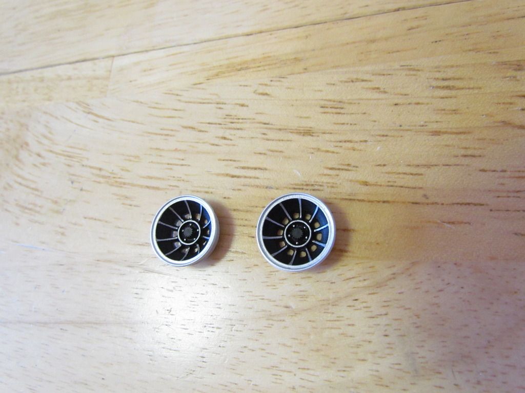

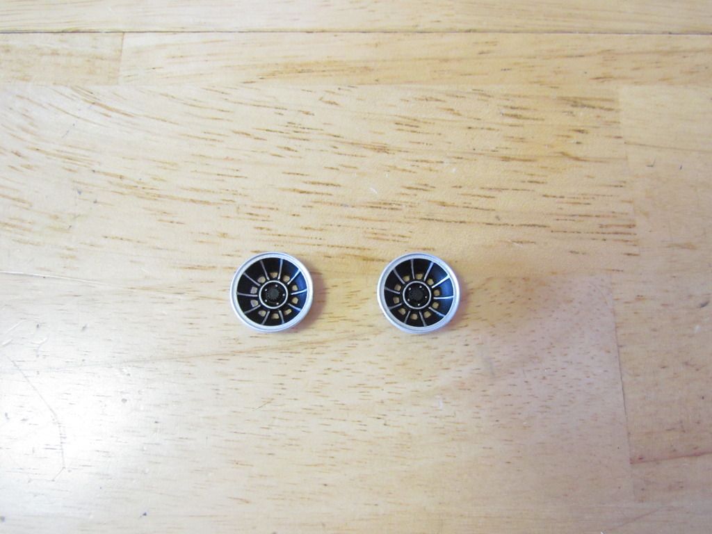

crowe-t Posted November 4, 2015 Posted November 4, 2015 (edited) I tried this technique in the video above and it works real nice. I first painted a set of AMT 69 Riviera 1/25 Vectors using Testors MM Acryl Silver. Then I waited one day and sprayed on some Tamiya acrylic flat black. I used Testors Acryl since Windex doesn't affect it. The Tamiya acrylic wipes off with Windex. After the black was dry I used a Q-Tip moistened with Windex and wiped off the black around the outer edge. Since they are 1/25 wheels I had to use toothpicks dipped in Windex to remove the black paint off the spokes. Here are pictures of the results. Edited November 4, 2015 by crowe-t
