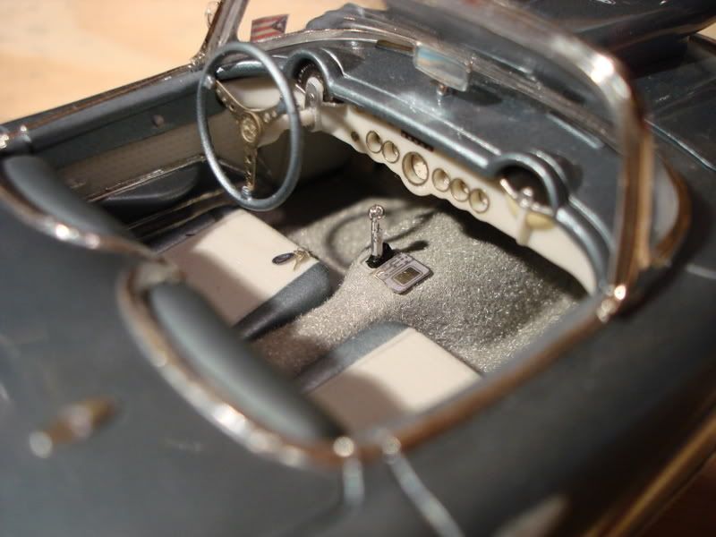

Ron L Posted March 5, 2008 Posted March 5, 2008 Toothpick method works "good enough" especially if the car has a roof. A bunch of random blobs and dots is all it takes to make it seem more detailed than it really is. Don't forget to add red to the over-rev portion of the tach, heater buttons, fuel gauge, etc. This dash had no engraving on the main gauges, I just guesstimated the placement of the gauge numbers using a toothpick. Blunt the end of the toothpick so it will hold a very small drop of paint at the tip, then transfer the dot onto the gauge. You aren't painting with the toothpick, but rather dabbing on the paint.
