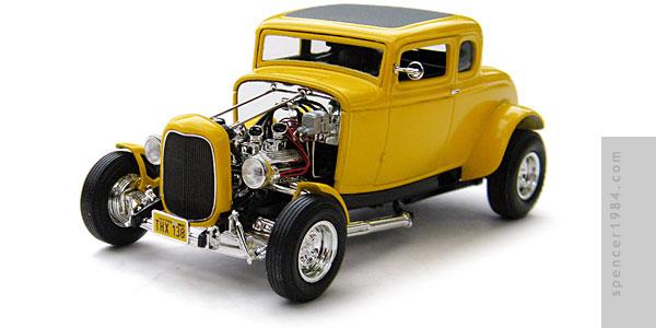

spencer1984 Posted August 7, 2015 Posted August 7, 2015 Revell's kits of the deuce, '55, and T-bird were all pretty good. I kind of wish they had been able to continue the line and include more of the cars

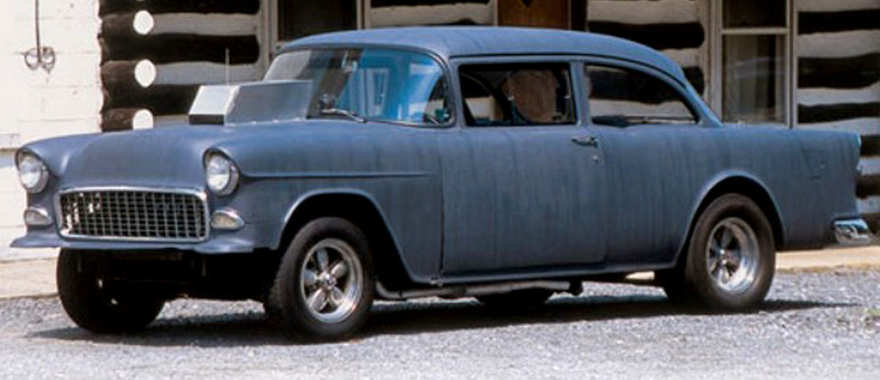

FordRodnKustom Posted August 7, 2015 Posted August 7, 2015 (edited) Falfa's 55 started it's movie career as one of three built for the movie Two Lane Blacktop. Edited August 8, 2015 by FordRodnKustom

Force Posted August 9, 2015 Posted August 9, 2015 (edited) The Edsel Corsair and Citation are Mercury based and are quite far from the smaller Ford based Ranger and Pacer and I don't know if any 57-8-9 Mercury has been made as a model, so the Laurie Edsel are a bit hard to do..but if you want it enough it can most likely be done.The Milner 32 Ford has been made by Revell as an pre painted unassembled diecast kit, and MPC did a quite wrong plastic kit reissued by AMT a few years ago, MPC also did the Milner dragster from More American Graffiti, not a good one as with the 32 coupe but they did one anyway.The Falfa 55 Chevy was also made by Revell as a diecast kit and you can for sure convert the AMT 55 Sedan to resemble the movie car, or take a Revell 55 and graft on the roof from their 56 Del Ray to do a 2 door post.The Steve/Toad 58 Impala isn't that hard to do from either the AMT kit or the Revell kit.The Pharao's 51 Mercury, a 51 Mercury hasn't been done as a model kit and the 51 differs quite a bit from the available 49 Mercury's, the rear quarters are longer and the rear window opening is wider and has a different shape than the 49-50, the dash board are also different in the 50-51 so the 49 dash is wrong.The 56 Thunderbird driven by Susanne Sommers has been done by AMT as mentioned and Revell also did a pre painted diecast kit of the car.The Curt Henderson Citroën 2CV can most likely be done as Revell, Heller and Tamiya has done 2CV's, I don't know if they are the right year but there are not that much that differs.Holstein's 61 Galaxie Police car can maybe be done from the old AMT Styline kit Edited August 9, 2015 by Force

Nova-ss Posted August 30, 2016 Posted August 30, 2016 I never built the mpc 32 ford of milner's.what is wrong with it.sense I don't have one I can't compare it to pictures.I'm thinkin of building my own from that kit.is there a better kit to start from? thank you all.....Chris
Reegs Posted August 30, 2016 Posted August 30, 2016 I never built the mpc 32 ford of milner's.what is wrong with it. If memory serves, the 1:1 car had that crazy Man-A-Fre 4-corner manifold while the kit had your standard one (or two?) 4-bbl set-up.That's IF memory serves ...
Greg Myers Posted August 30, 2016 Posted August 30, 2016 The MPC kit is a spin off of their old "Switchers" series. As for the "crazy Man-A-Fre 4-corner manifold", the kit did indeed have an inline dual four barrel set up. If you want the Man-A-Fre all you need is the bottom manifold of an early ('63-'67) Corvette fuel injection ( looks quite convincing) with the appropriate two bbl carbs. The Man-A-Fre was a direct port induction, with the carb openings right above the intake ports in the head much the same as the Corvette FI. Just turn the carbs front to back.
