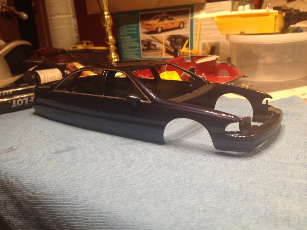

still making progress...glass trim (this is black marker in the photo, but I hit it again with black acrylic to get better coverage).
glass.thumb.jpg.665a54acda6eb7ec312aa580
glued the side mirrors on
side_mirror.thumb.jpg.b1533105bf598d6d4f

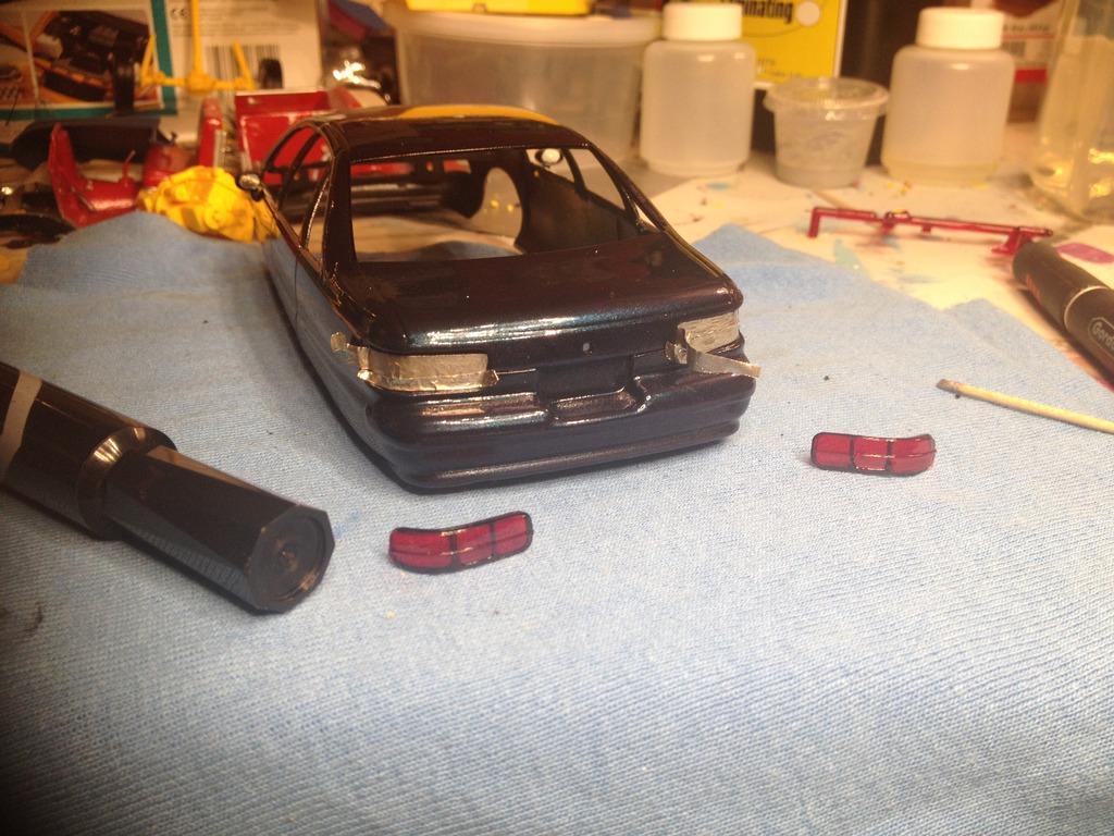

...& worked on the tail lights ( I highlights the raised ribs on the back of the lenses & added bare metal foil to the body behind them.
tail_1.thumb.jpg.a763e3ca5492fd3ca893609
I also added some BMF to that center strip, too. (Looks a little too 'bold' / out of scale...but I might just leave it.....

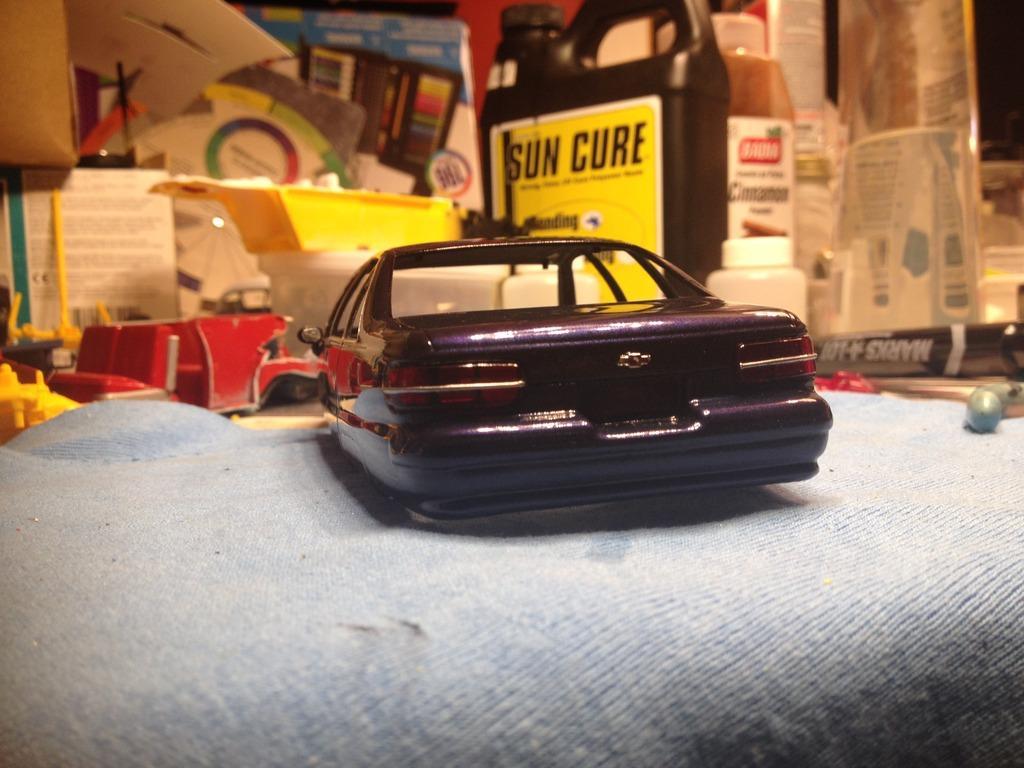

As a matter of fact, I had to throw yet another coat on tonight. This was after I marked the (still soft , un cured!) roof surface while using clothespins to help hold the glass in yesterday  :-(
...and to fix that, i thought I could mask just the roof area...which I did, & it came out fine...BUT the windshield & rear windows fogged with a craze reaction of some sort (grrr!)
(2 steps back, 1 step forward?!?!?? This thing is gonna bump up a few scale sizes with all the clear layered on it !!!! lol. no surprise it was still soft. )
The body is looking better

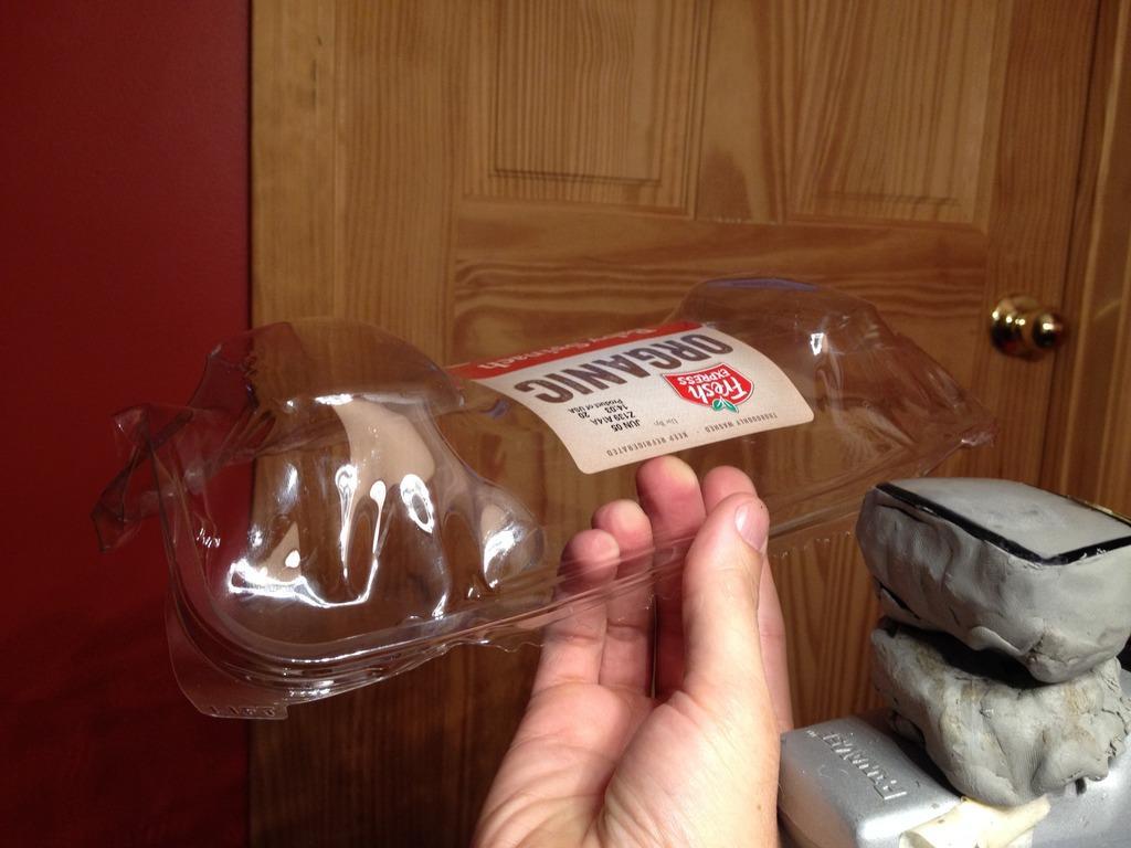

Now I'm making new windows out of clear plastic vegetable container lids. (Back window done...I'll try and photo my technique when I get to the windshield).

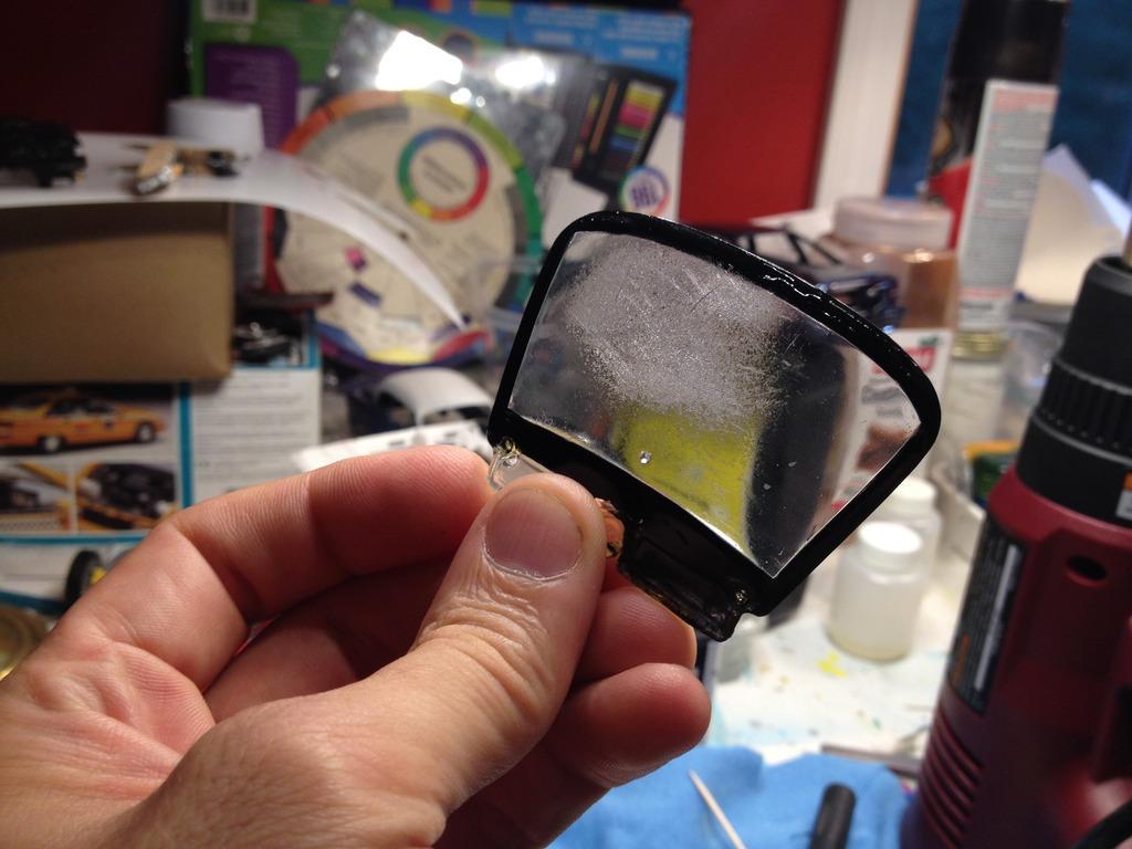

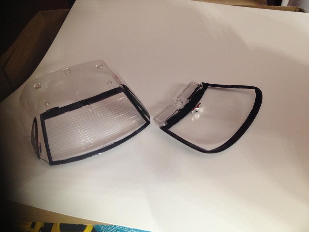

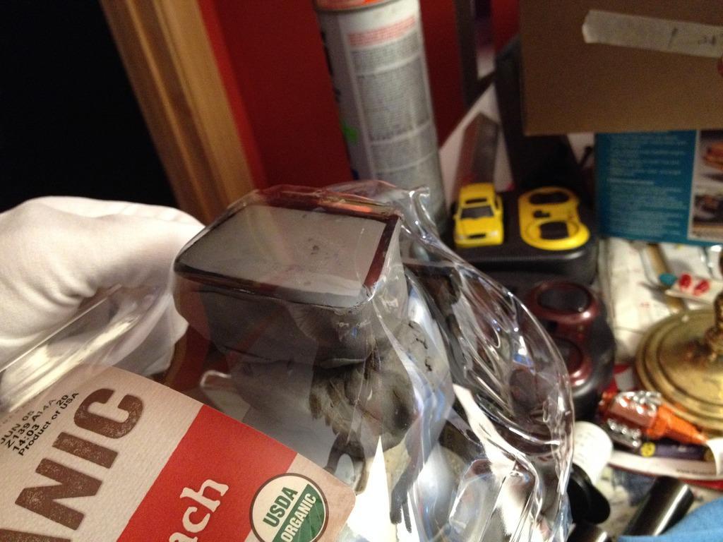

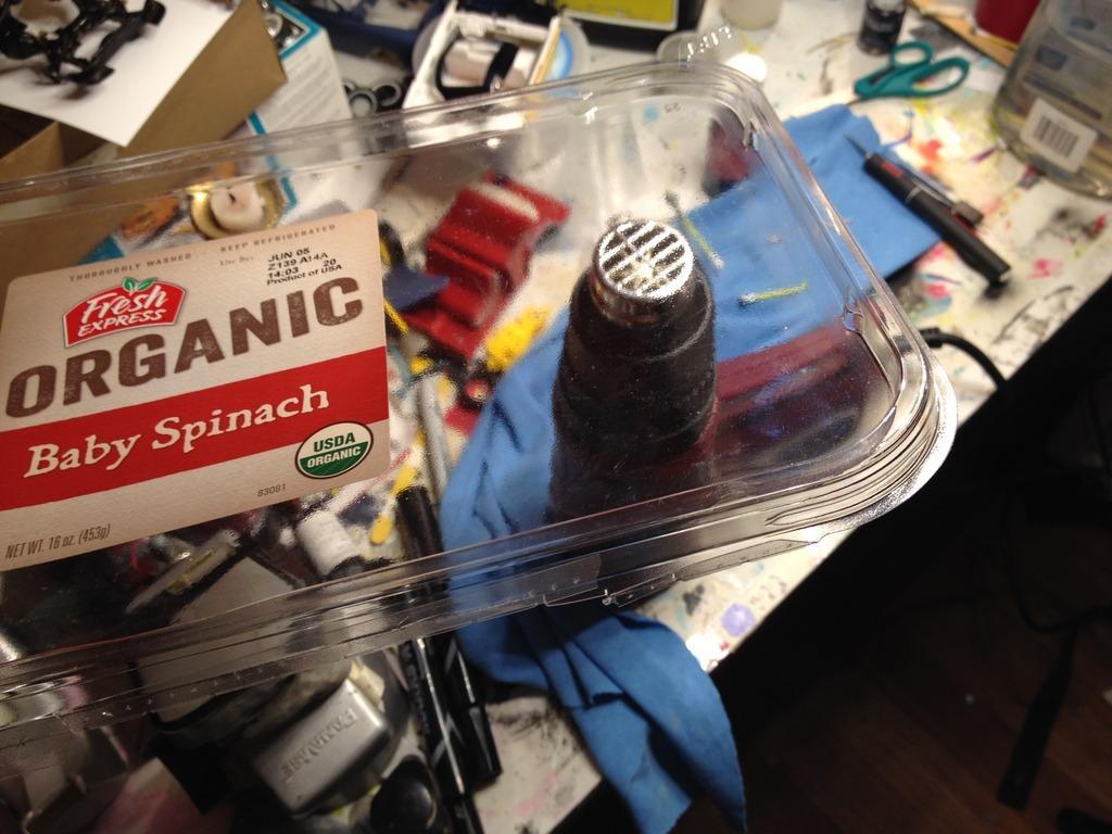

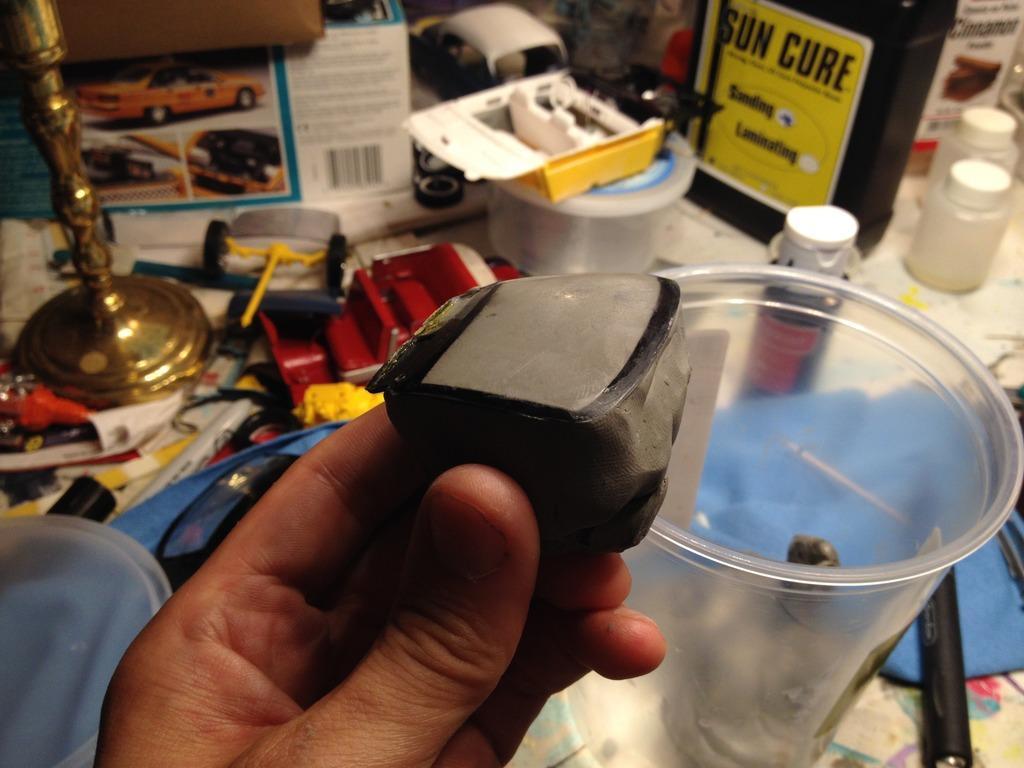

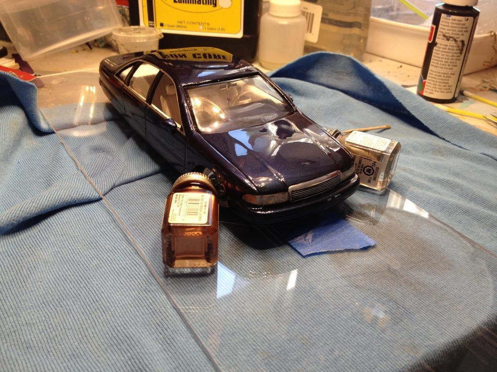

I got around to making new glass....here's how I did it.
(You can see the craZed kit glass from my paint touch up fiasco...
crazed_glass.thumb.jpg.d45e08dbf5c20485e

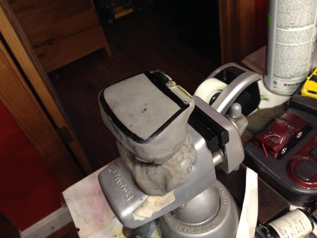

First, I backed up the glass with some modelling clay. The clay is meant to evenly support the glass to act as a form / buck. Put it on an elevated base so you have room to 'stretch beyond'....
on_base.thumb.jpg.9475a564103c40447818bf
I used my heat gun to heat the plastic lid up. This is Time & temperature dependent (I think I set my heat gun to ~750°F for about 10 seconds @about 12" away....your results may vary. I experimented a few times...you want the plastic to be somewhat stretchy, but not too much heat or it could blister & bubble.
heat_it_up.thumb.jpg.01ed8182c09d132fd64
I held the lids with gloves when I heated it...then quickly brought it over to the glass & stretched the lid over the glass. Carerful..Firm pressure & keep it steady for a few seconds until it cools.
stretch.thumb.jpg.88da076bf78cd98bf3a81c
I did it again on the other end of the lid...you know, just in case ;)

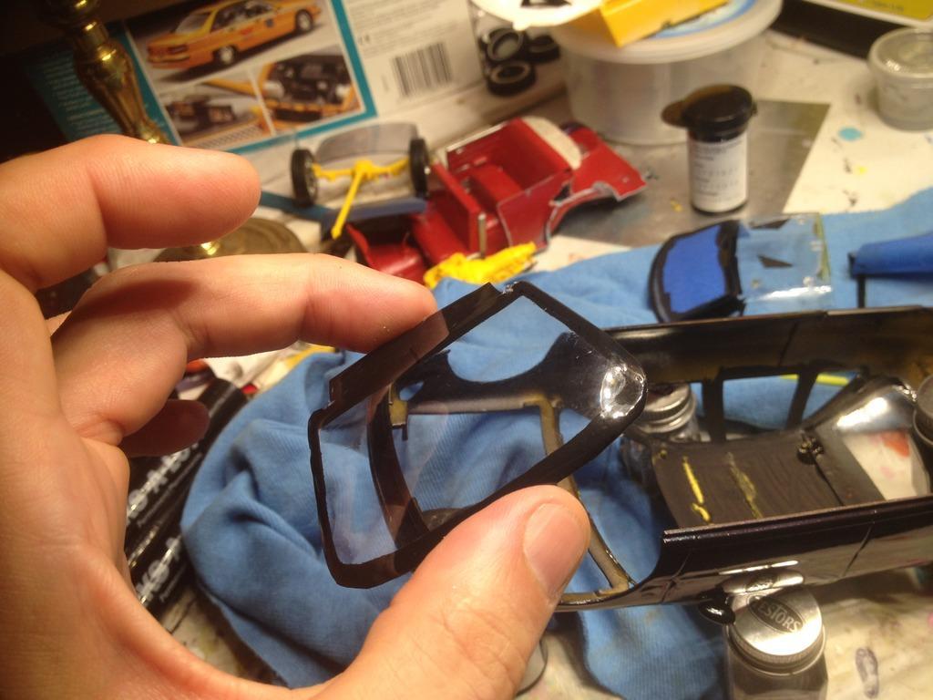

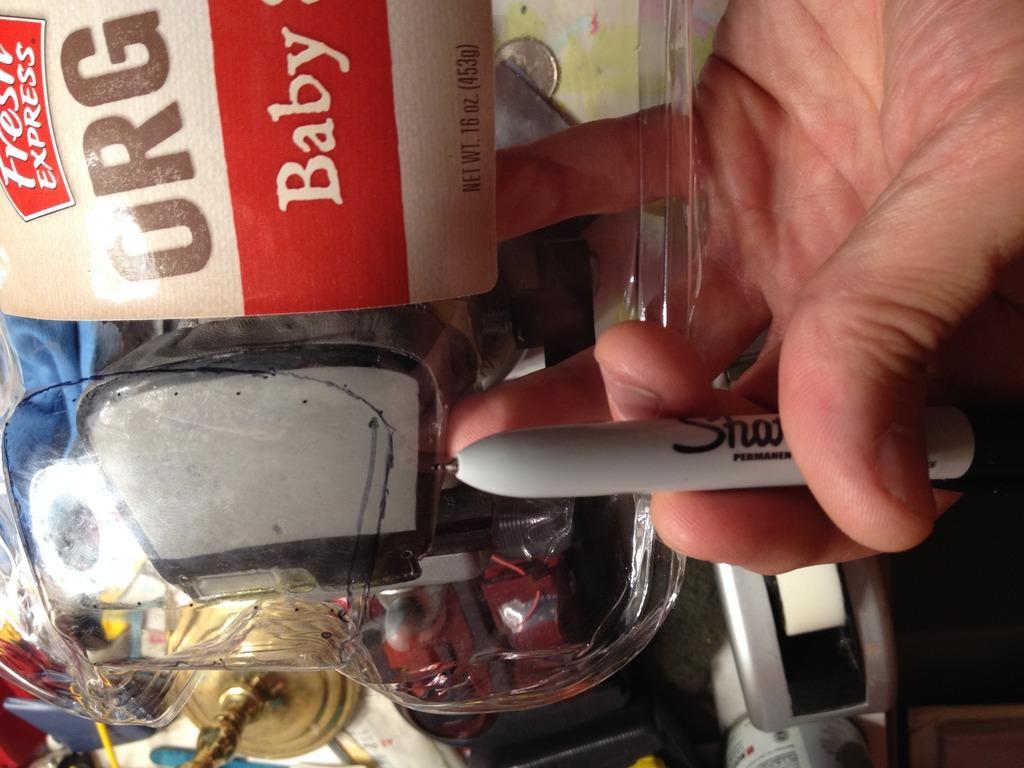

Hold the glass inside & trace to give some cut lines, (I had the black surround, so I traced that to give me a positioning for the mask...
trace.thumb.jpg.a40ba4eed60c4e9b75a80b97
After some trimming & masking & needing my backup ( <_< )....& a quick shower with some Future Floow Shine, I ended up with this!
done_windshield.thumb.jpg.e38fff39c936de
Better than bad! (I remember all those finger print-y glass installs I did in my youth (ugh  :wacko: )....if I had only known then what I know now (Ha!)

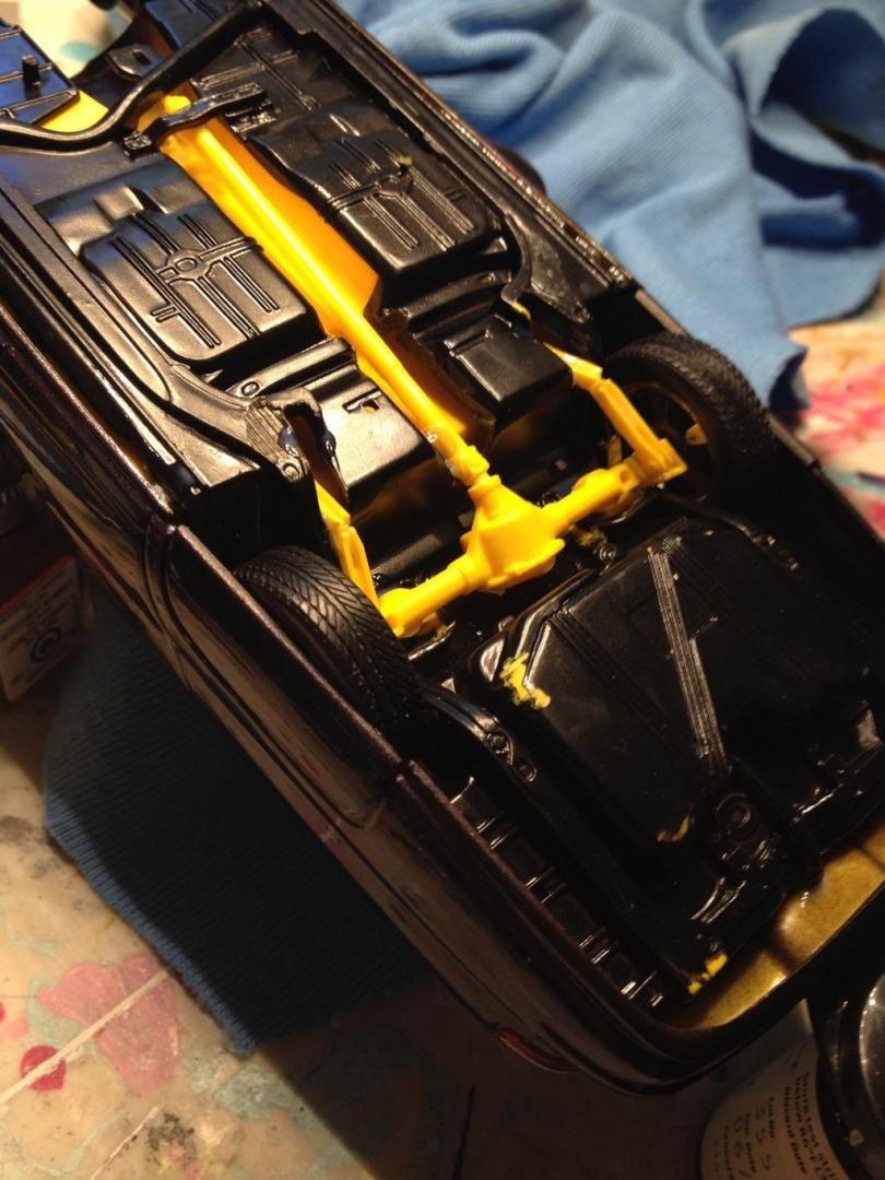

Here's a gory detail of the rear suspension (remember, I'm building this as a low stress shelf model, so engineering realism (or paint on the ground scraping underside!) isn't where it's at. ;)

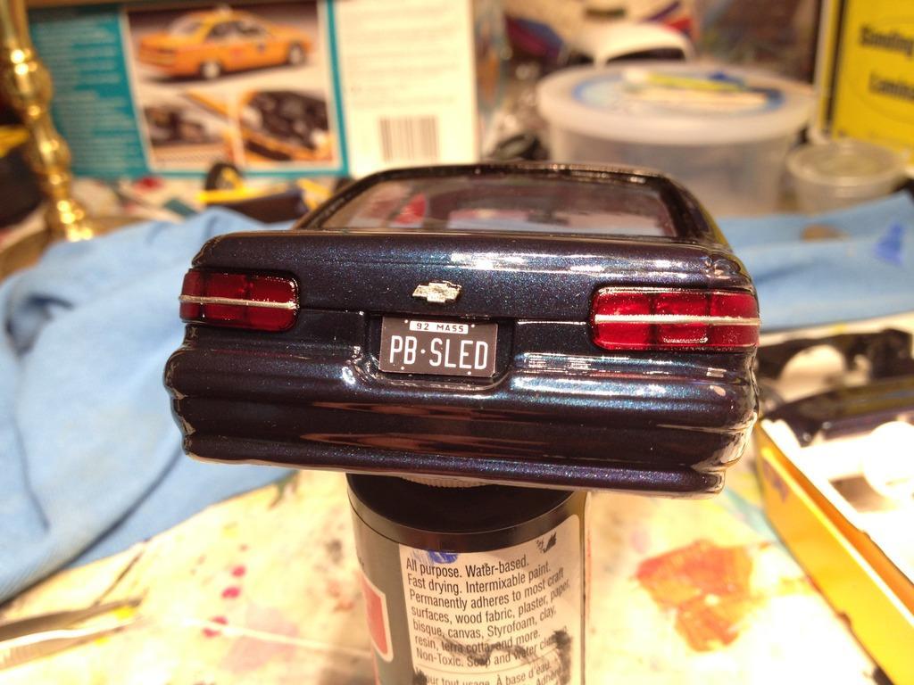

A little tip to the past vintage look vanity license plate (I used this website ( http://www.licenseplates.tv/license-plates.html?= ). Screen grab + a little photo manipulation for the year :) Printed on photo paper & glued in place.
PB_SLED.thumb.jpg.b5e00804829fa26cb54919
