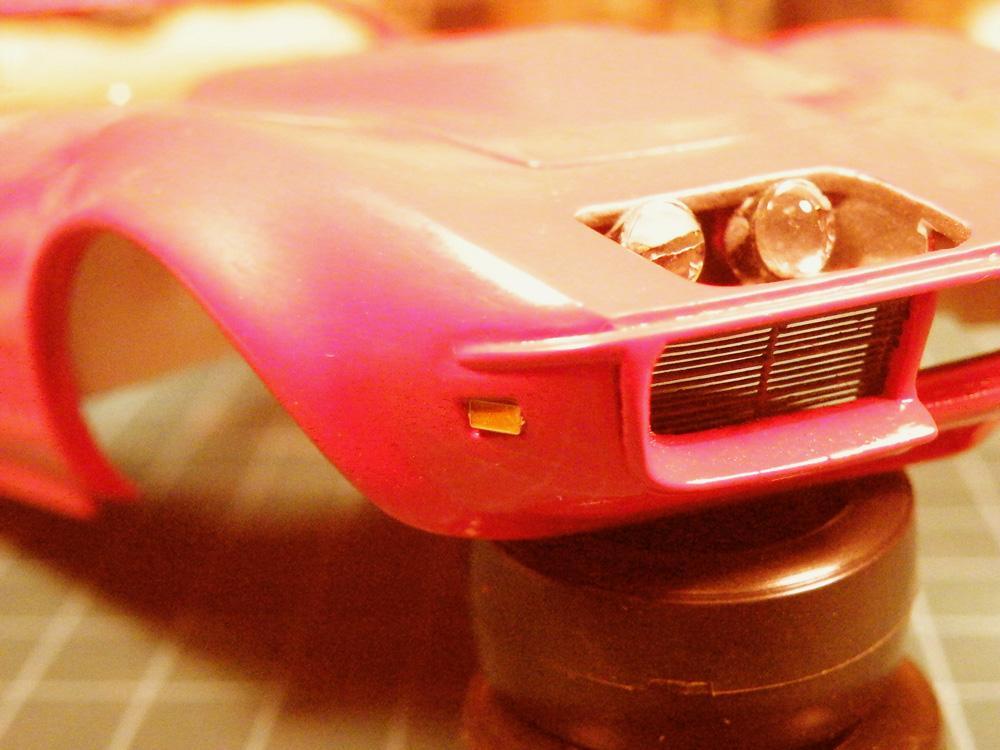

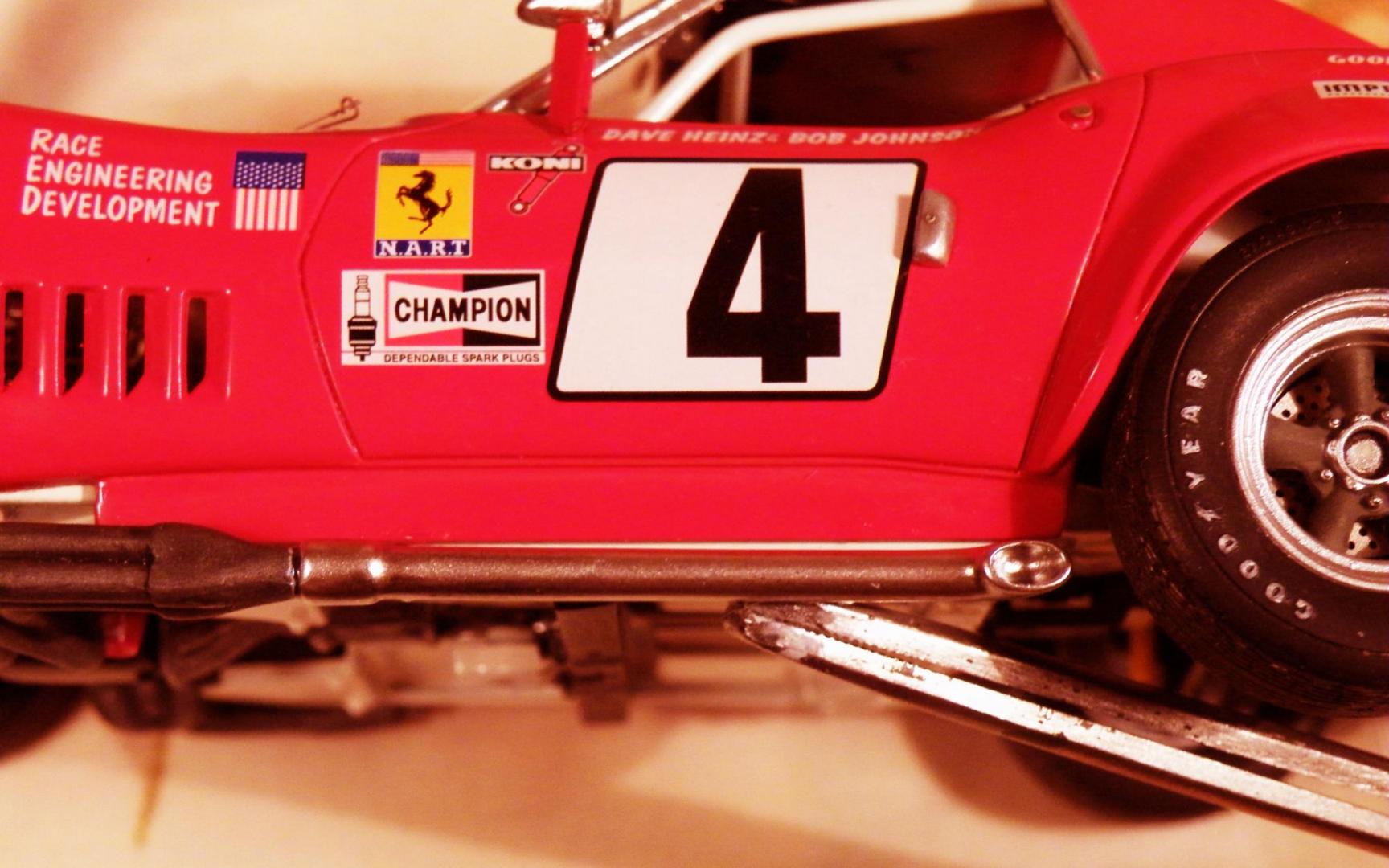

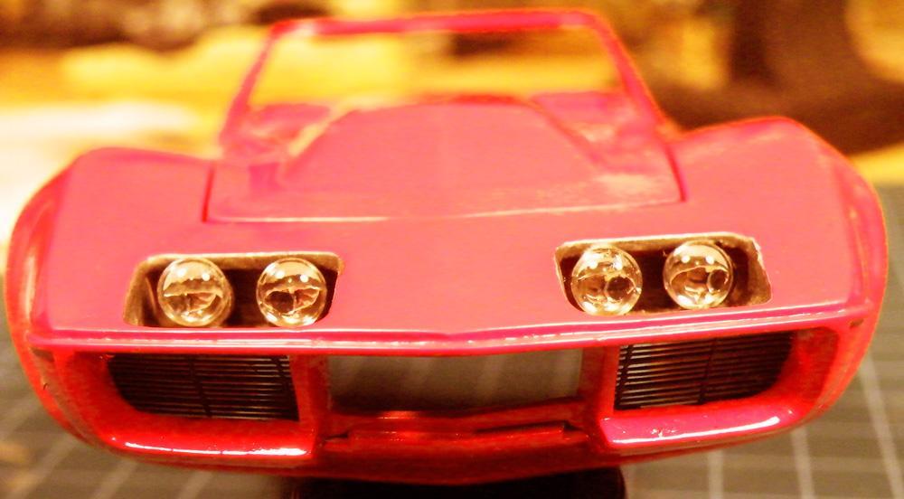

GlueTube Posted September 6, 2015 Author Posted September 6, 2015 The body on paint.Unfortunately my photographic skills or lack thereof do not do justice to the color. It pops! Used a top coat of Humbrol red over Humbrol orange in an attempt to get bright red. This shot shows the grill work, headlamps, and side marker. Head on shot of grill work and headlamps.
aurfalien Posted September 6, 2015 Posted September 6, 2015 (edited) Wow man, totally cool!As for pic skillz, a new smart phone would solve your issues. And maybe magic hour lighting. Edited September 6, 2015 by aurfalien
afx Posted September 7, 2015 Posted September 7, 2015 Brian, what are you using for headlight lenses?
GlueTube Posted September 7, 2015 Author Posted September 7, 2015 JC, they are a model railroad item called MV Lenses. RegardsBrian Kroon

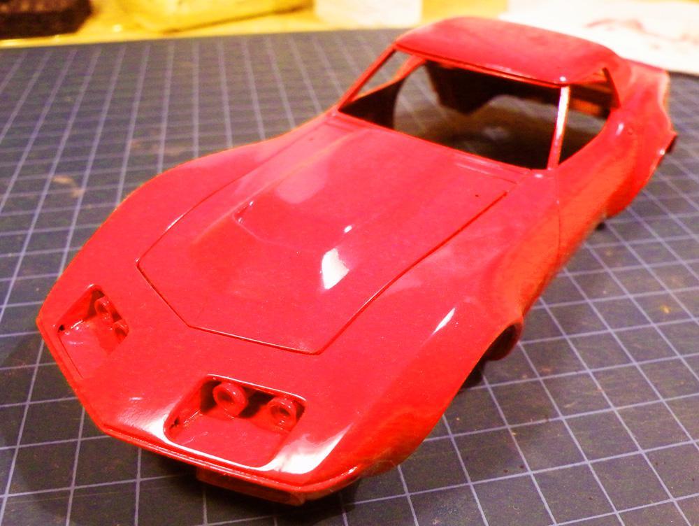

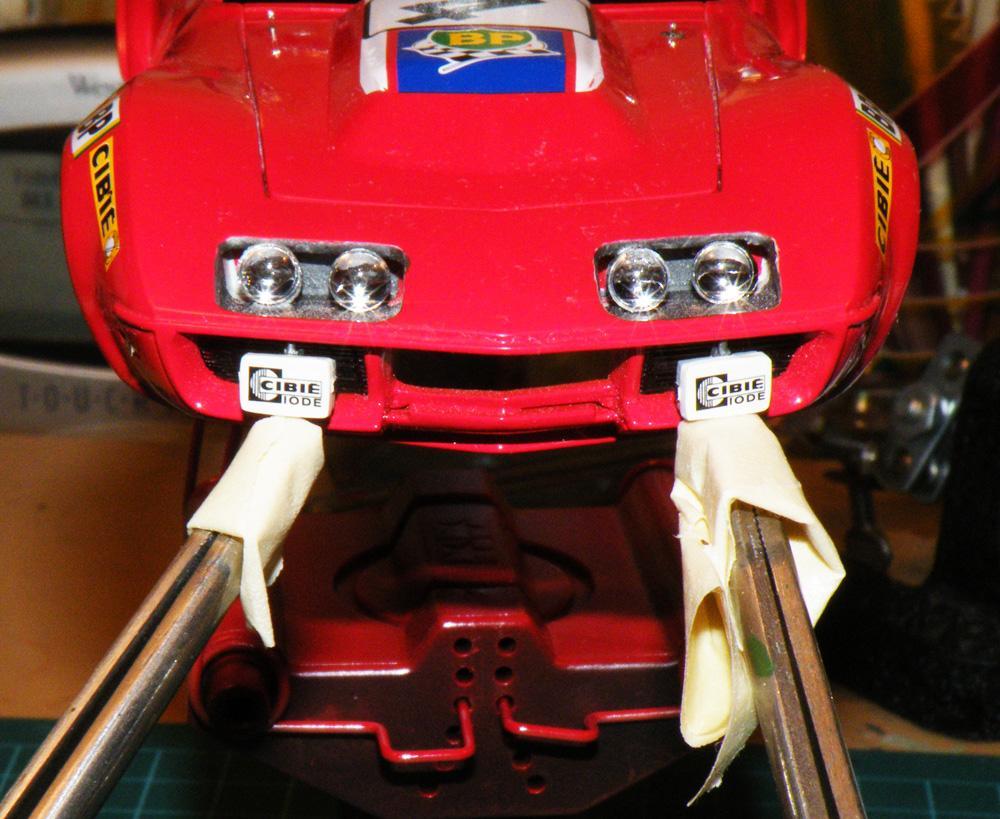

GlueTube Posted September 7, 2015 Author Posted September 7, 2015 On go the fog lamps! I also think this photo shows the front fender flares well....don't you?

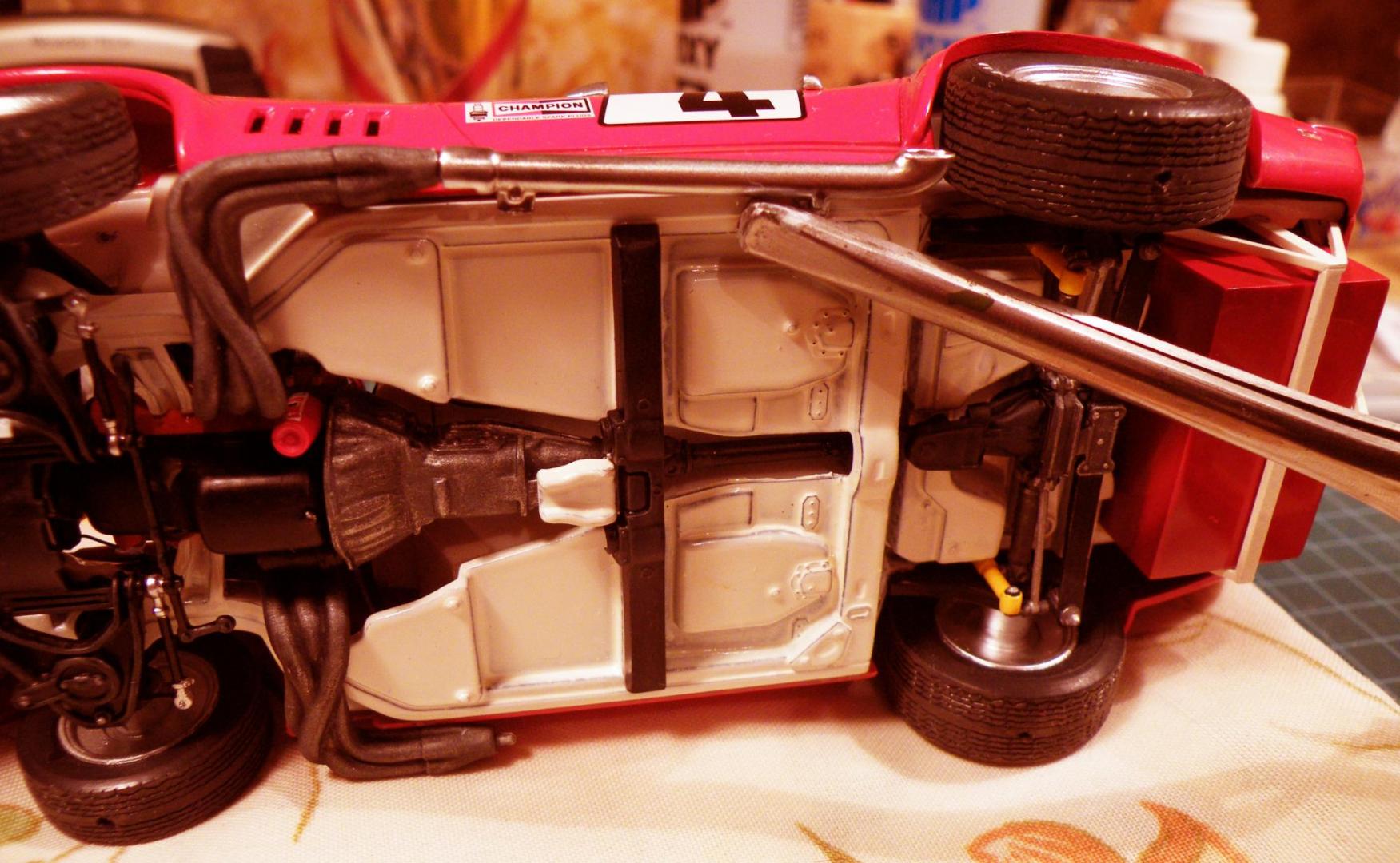

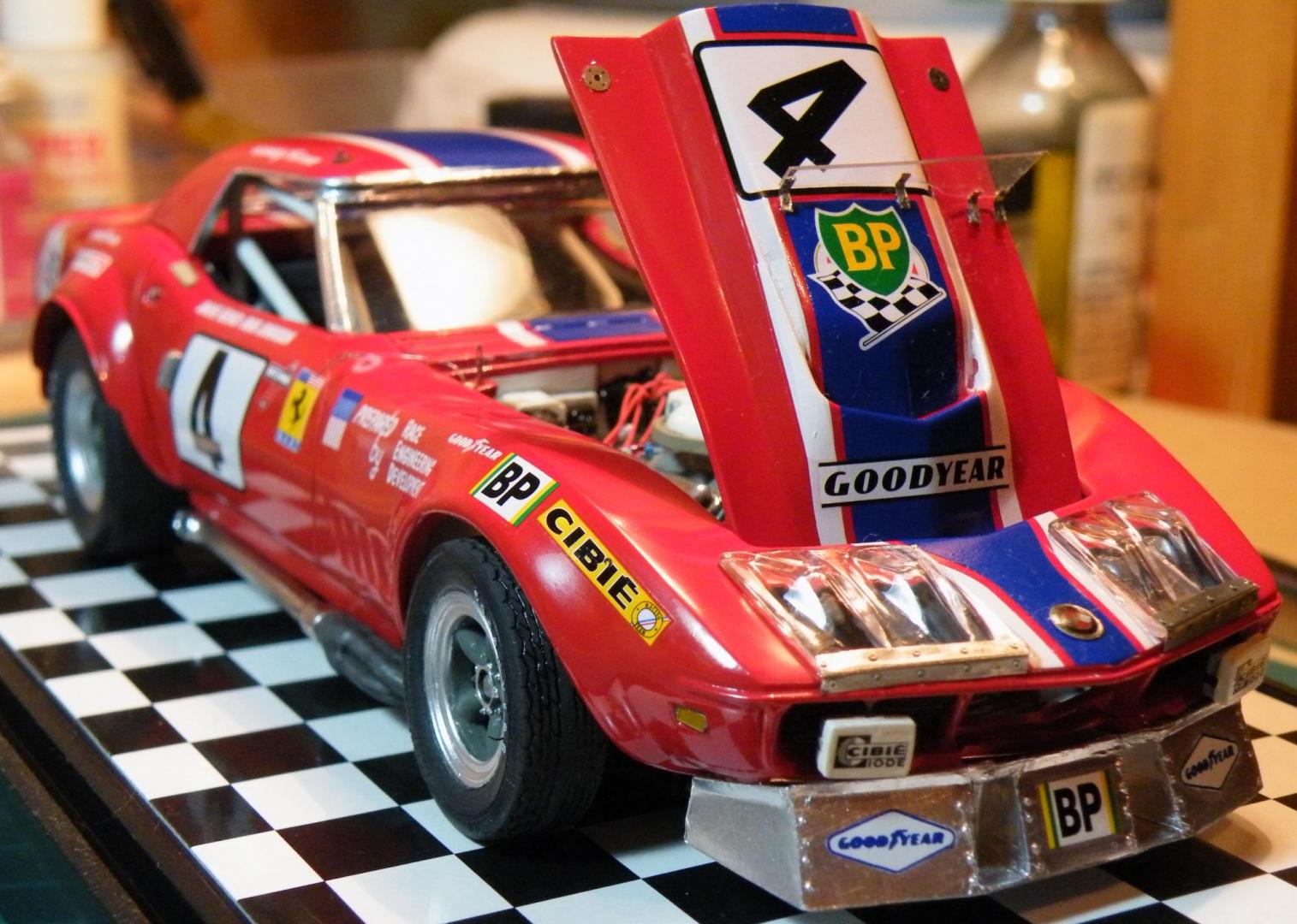

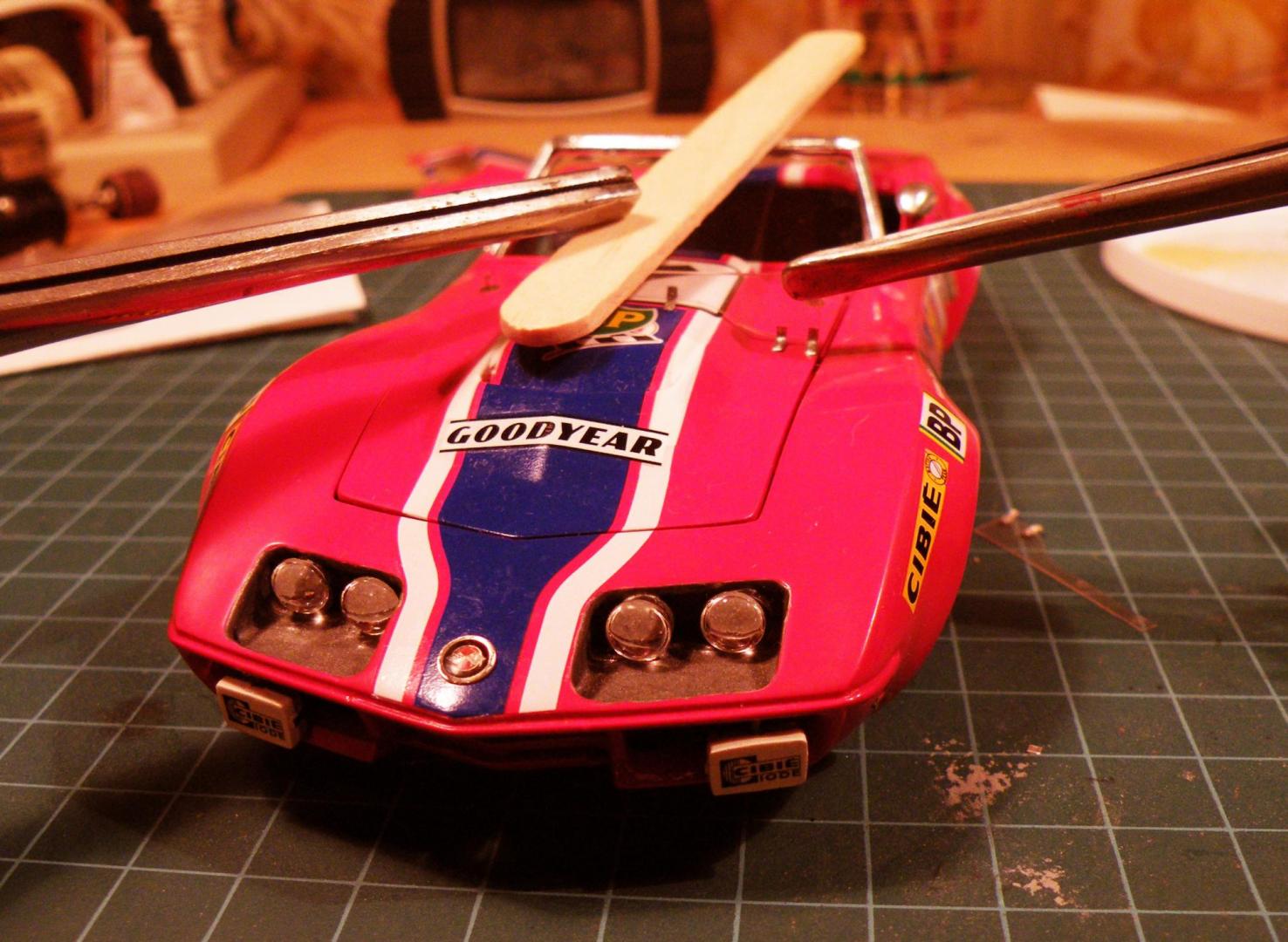

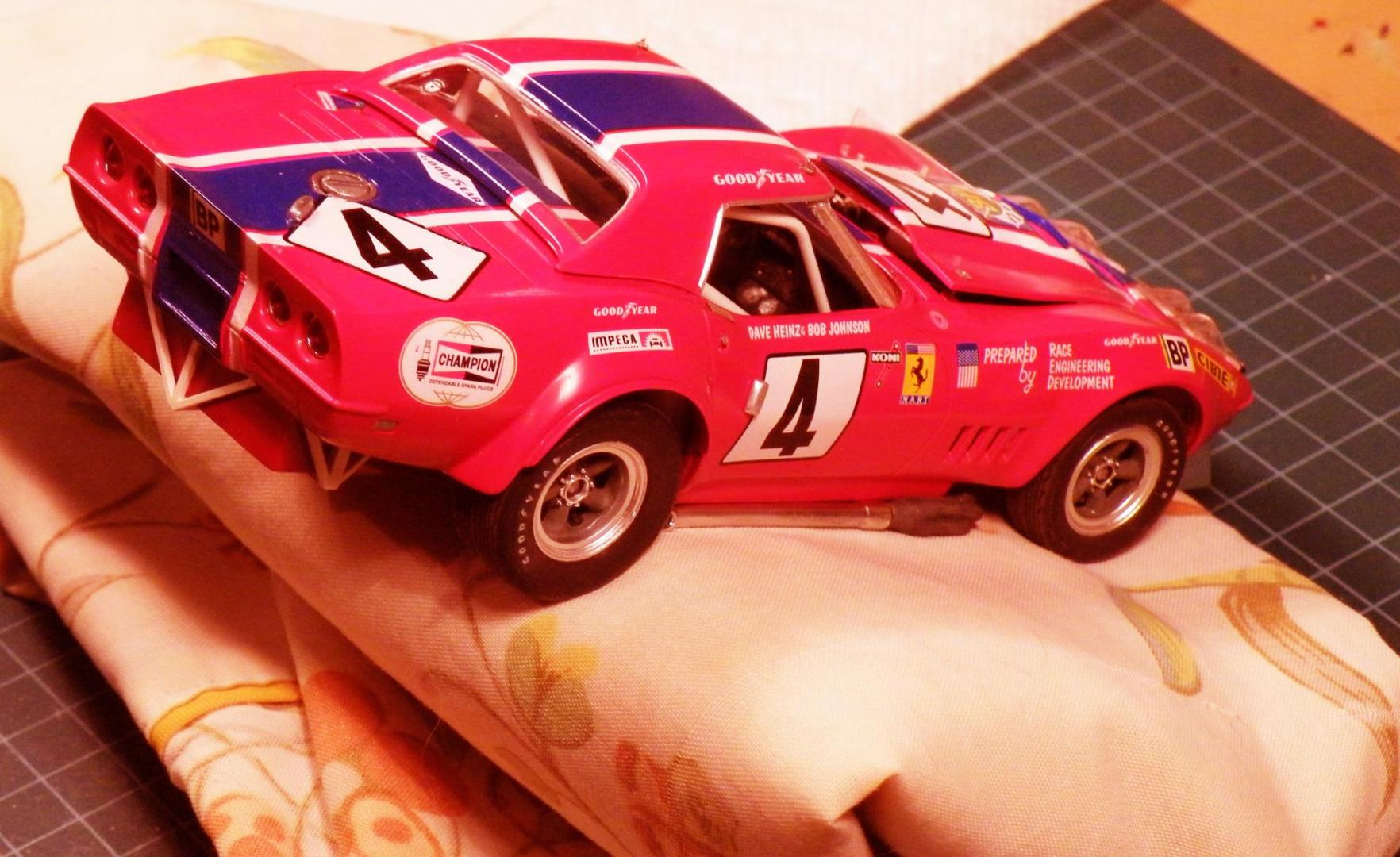

GlueTube Posted September 14, 2015 Author Posted September 14, 2015 Here you can see the install of the wind deflector. The clear plastic was salvaged from a packaging lid with display window. The mounts are wine bottle lead foil. Side dump install. My first attempt using Alclad paint. Number panel light is scratch built as is the mirror pedestal. A view of the underside. I use a an old rolled up pillow slip cover as an infinitely adjustable stand, while I finish the last of the details such as decals and photo etch placements. Regards Brian

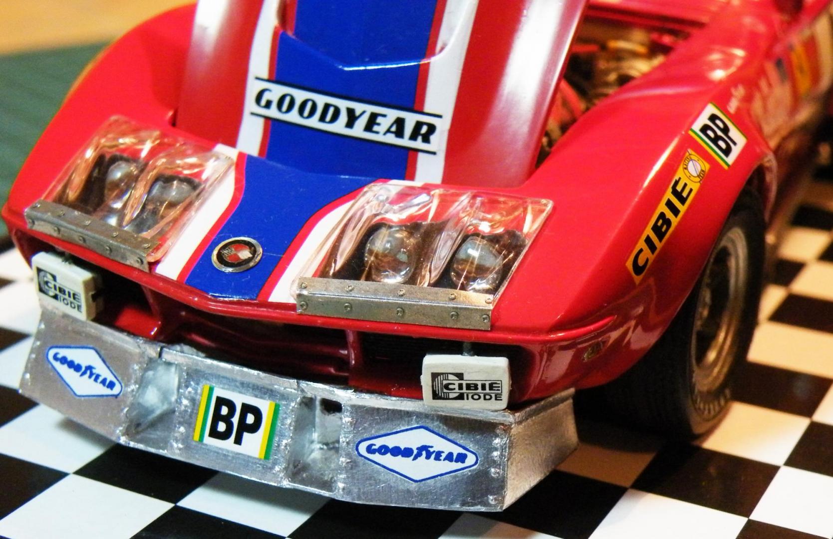

GlueTube Posted September 29, 2015 Author Posted September 29, 2015 Home stretch! On goes the spoiler. This is the part of the project I found most challenging. I used 010 sheet styrene and covered it with Bare Metal Foil.....I am not totally happy with the results....think I'll do Alclad nest time I have a large expanse of sheet aluminum to replicate.

Crazy Ed Posted September 29, 2015 Posted September 29, 2015 That's quite the Build there Brian. Wondering what you used for Rivets? They look great.

GlueTube Posted September 30, 2015 Author Posted September 30, 2015 Thanks for the kind words guys.Brian and Ed, the rivets come from Model Car Garage photo etch. I think one of the things I dislike about the BMF covered spoiler is that I covered the rivets, rather than leave then exposed as I did on the headlamp cover hinges and tops of the number panel lamps.Mitch, the headlamp covers, "Greenwood Bumps" came from the Greenwood Corvette kit. The actual NART car mounted them as per I have done with hinges in the front and screws in the rear. I wish they were vacuum formed from thin sheet stock, rather than injection molded, for a more realistic look. RegardsBrian Kroon
Reeves Racing Posted September 30, 2015 Posted September 30, 2015 Okay, I have the Greenwood kit but haven't opened it up yet. The Owens Corning kit didn't have them IIRC.I thought the flatter part of the clear cover went to the front and the tear drop part went to the back. Thanks for the clarification.
John Goschke Posted September 30, 2015 Posted September 30, 2015 What a great build! Very clean workmanship does justice to a very cool subject.
afx Posted October 1, 2015 Posted October 1, 2015 (edited) Okay, I have the Greenwood kit but haven't opened it up yet. The Owens Corning kit didn't have them IIRC. I thought the flatter part of the clear cover went to the front and the tear drop part went to the back. Thanks for the clarification. No the Owens Corning kit does not have them. They are in this kit. Edited October 2, 2015 by afx
GlueTube Posted October 1, 2015 Author Posted October 1, 2015 Okay, I have the Greenwood kit but haven't opened it up yet. The Owens Corning kit didn't have them IIRC.I thought the flatter part of the clear cover went to the front and the tear drop part went to the back. Thanks for the clarification.Ok Mitch, I now get what you are driving at. I wrestled with the same issue until the reality of making the "bumps" fit over my headlamps came into play. So I just fit them so they would work and clear the headlamps. (which are almost 5 scale inches in diameter) Visually I really didn't think it mattered as they looked good either way!RegardsBrian
Reeves Racing Posted October 1, 2015 Posted October 1, 2015 (edited) Either way it looks great Brian. I opened my Greenwood kit up last night, I want to do the same thing you did and make head lights instead of using the decal that looks like head lights. I bought the BFG Fred Caddy decal set for mine. Now I know what I may be up against when I go to fit the covers on my build. Edited October 1, 2015 by Reeves Racing
