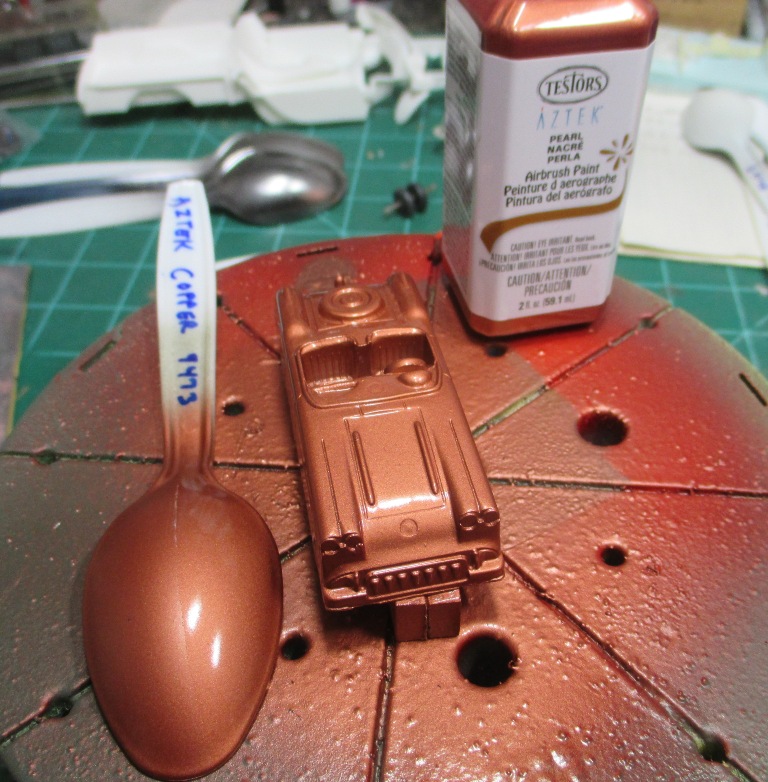

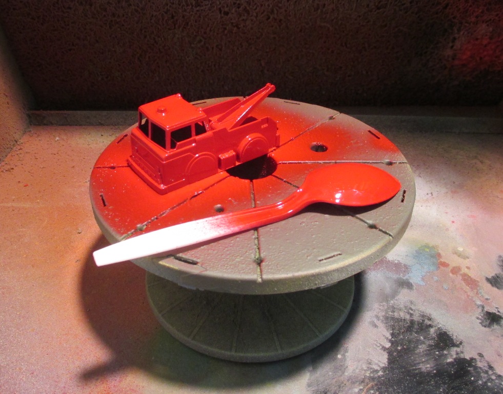

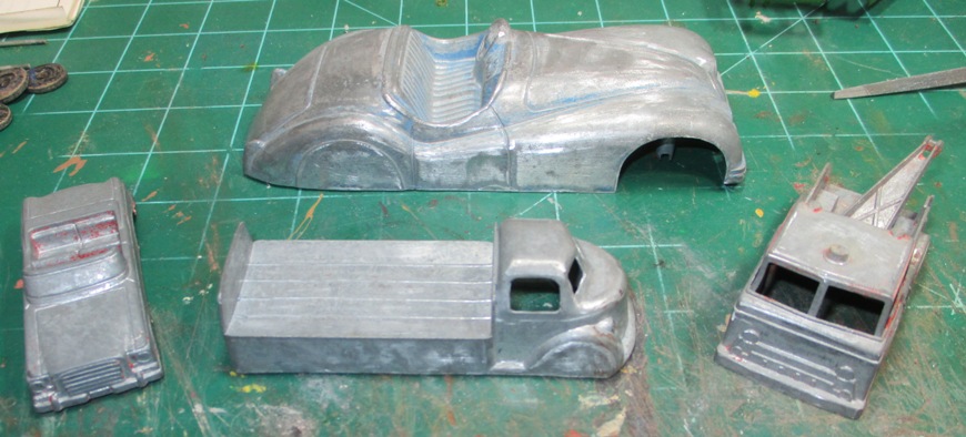

AzTom Posted September 2, 2015 Posted September 2, 2015 (edited) These are a few old diecast trucks and cars from my junk box that needed paint jobs. I dig some of these out every now and then to test new paints or just practice on. Some I will keep in the collection, others I will sell at the antique mall for hobby money. They were all stripped and primed with self etching primer. This is a Midgetoy Ford wrecker about 3 in long. It's paint with Testors MM Guard red with a drop of hardener added. Midgetoy 58 Corvette about 2-1/4 in long. Painted with Testors Aztec acrylics. This is with out a doubt the best acrylic paint I have ever sprayed in an airbrush. Here we have both Corvettes, one Copper and the other Guard Red finished. Edited September 2, 2015 by AzTom

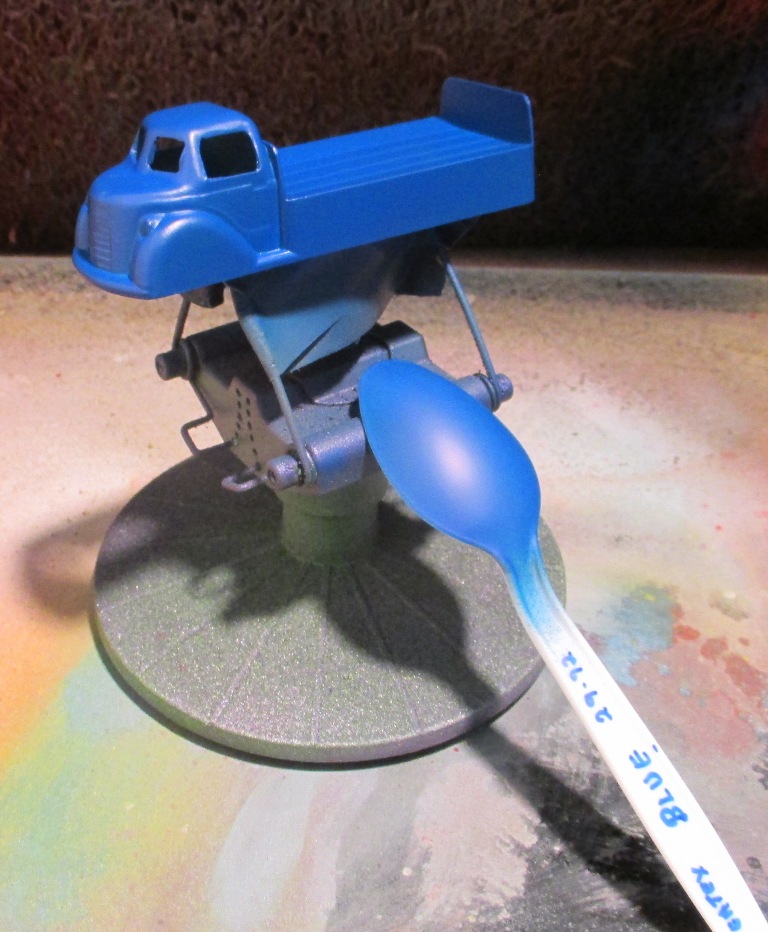

AzTom Posted September 2, 2015 Author Posted September 2, 2015 Thanks Ray. I love doing these and it's easy to make some extra hobby money This a beverage truck made by London Toys and is about 3 in long. The paint is Createx acrylic. Very easy to use, pretty hard to mess this stuff up. This one is Tootsietoy and is about 4 in long. I painted it with MM Lacquer Hugger orange and did not clear coat it. I just polished it with a automotive polish and it made it look more like the original paint. Clear coat looks great but too glossy for old toys.

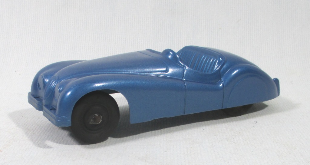

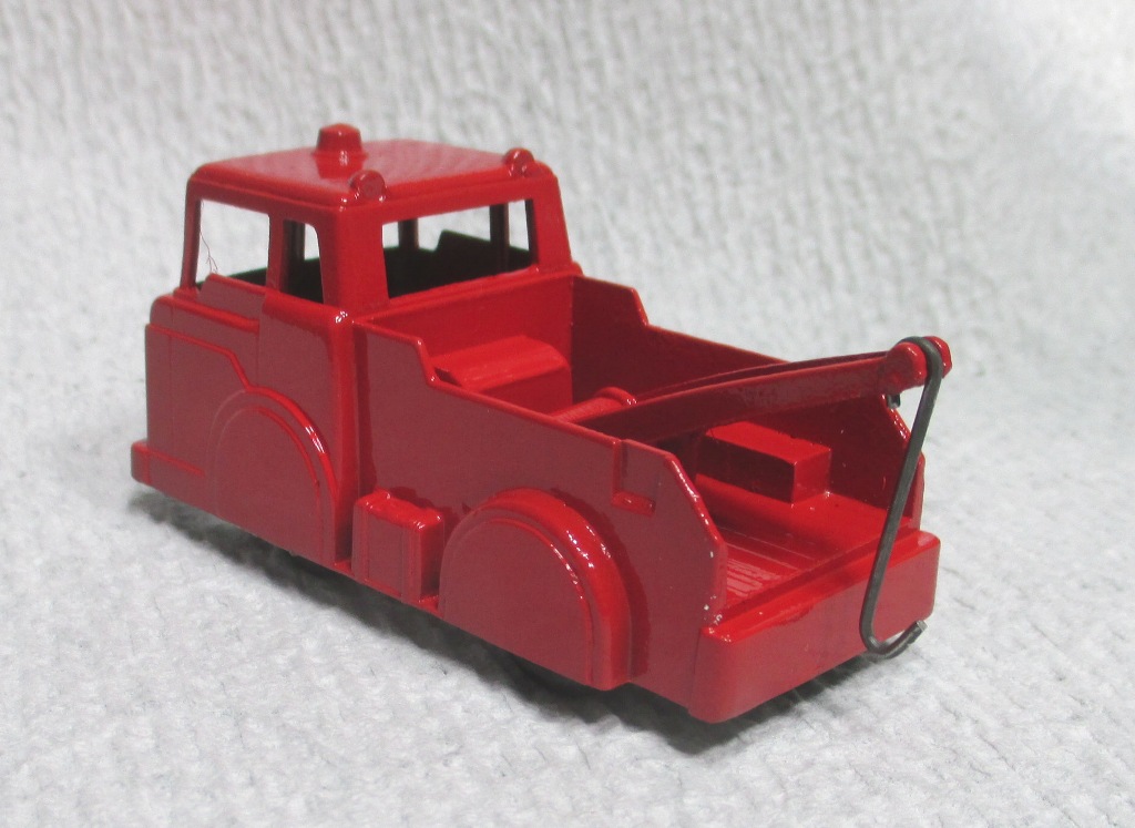

AzTom Posted September 5, 2015 Author Posted September 5, 2015 Okay, finished up a few more of them. Here is the Midgetoy Wrecker done. This one is only 3 in long. This is the Jaguar made by Irwin It's 6 in long and painted with MM rattle can Acapulco blue. I would like to find some Pepsi decals for the beverage truck.
