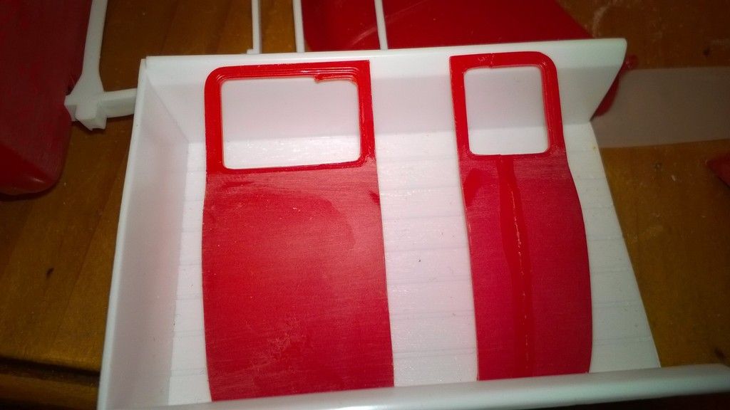

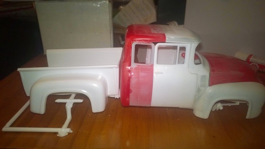

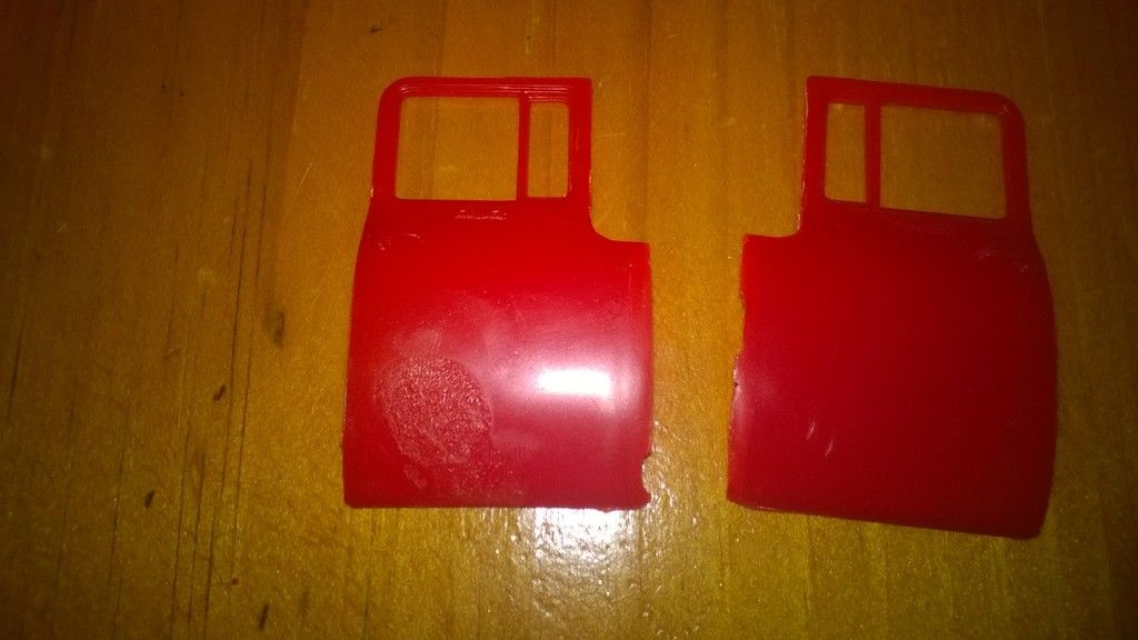

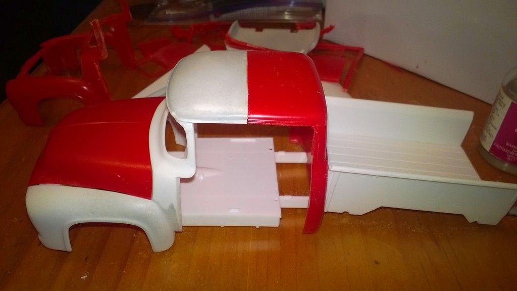

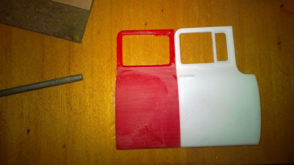

Travis T Posted September 8, 2015 Posted September 8, 2015 This is going to be a really slow build and won't be finished anytime soon. I started on it this weekend after receiving two extra cabs from a member here, one of which had the doors partially glued to it. I separated the doors and started reworking them for the extended portion. Then I sawed the kit cab and the extra cab and joined them together temporarily. Then test fitted the new panel. I decided it would be easier to flip the back "door" section from side to side and deal with the rounded off corner at the top as opposed to building a new jamb on the cut end of the door. No firm idea on where it goes from here, but it will probably be a mild 50s style custom when done. I would like some input on what types of glues would work best to bond this thing together, my biggest fear with it is breaking it during the body work phase. I know it probably needs some rocker panels fabricated and installed to make it more one piece. I started thinning the driver's side door post and broke it while cutting the roof. Would it be best to have this cast in resin so it is one piece? I've never done anything this involved before.

Travis T Posted September 8, 2015 Author Posted September 8, 2015 In looking at the pictures, I have decided to square off the top back corner of the doors as well. I looked at a few real custom extended cab pickups from this era and the rounded corner of the door just looks goofy and out of place on the real ones I saw. The corner was rounded to fit the cab originally but the door will look better I think with all corners square.

Superpeterbilt Posted October 3, 2015 Posted October 3, 2015 The best way to keep all of this from breaking while your working with it is to put thin strips of styrene lapping the joints on the backside. It really strengthens it up. Nice work so far. The cab looks great.
Travis T Posted October 5, 2015 Author Posted October 5, 2015 When I cut down the doors for the back side panels, I did put a strip of styrene on the inside of the joint. For the roof I was going to do a styrene panel for the headliner thinking that would reinforce it.
