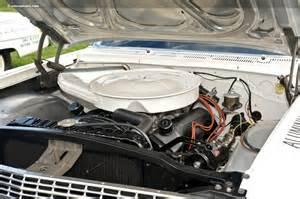

mk11 Posted September 12, 2015 Posted September 12, 2015 (edited) Basically any decent FE block in scale can stand in for the side oiler. The term side-oiler came from the extra oil gallery cast into the left side of the block to feed extra oil to the crank. Of course, one can add the bolt heads and side gallery bump as shown in the pic for accuracy... mike Edited September 12, 2015 by mk11
