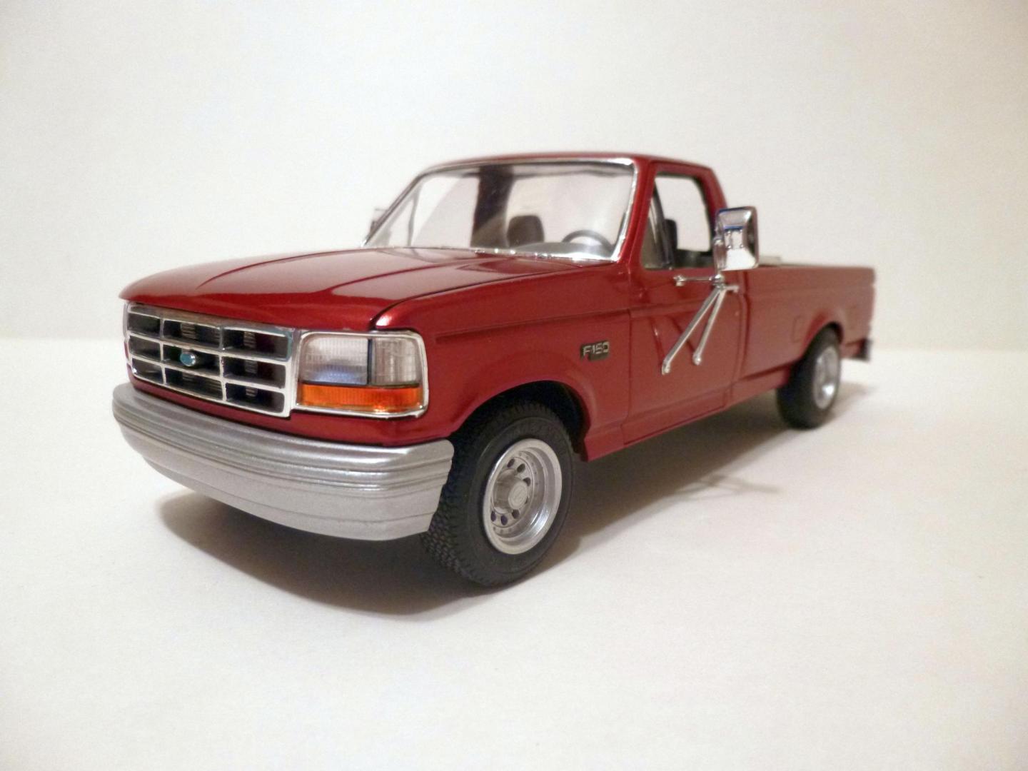

Chillyb1 Posted September 12, 2015 Posted September 12, 2015 Most Dupli-Color paints go on flat and require some gloss clear. I never bother with sanding the color coat with Dupli-Color because the clear always seems to bring out a beautiful and uniform finish. The Dupli-Color clear should do the job but I have no experience with it so no advice to give; same with Pledge with Future Shine. I do have lots of experience using Rust-Oleum lacquer clear over Dupli-Color and highly recommend it if easily available. Most modelers use the BMF after clear. As far as detail painting goes, you'll have to decide whether you want the details to have the same gloss finish as the body color. And, finally, welcome to the wonderful world of scale automobile modeling: the coolest by far segment of the scale-modeling community! These models are painted with Dupli-Color paints and cleared with Rust-Oleum:

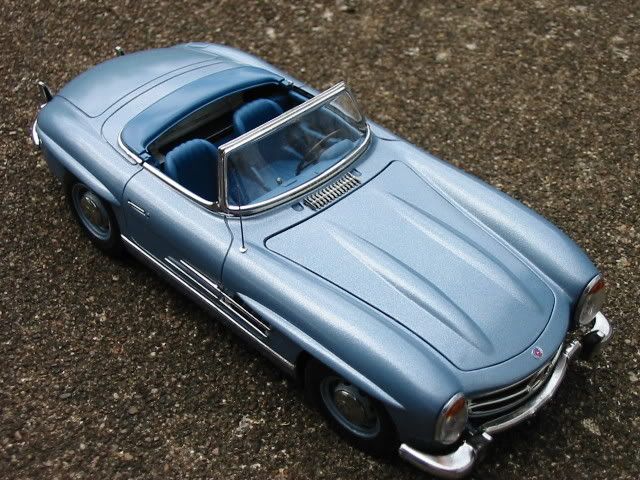

Ace-Garageguy Posted September 12, 2015 Posted September 12, 2015 (edited) They do make an acrylic enamel clear, that should work well over automotive enamels... http://www.amazon.com/Dupli-Color-DA1692-Crystal-General-Purpose/dp/B001DKPL14/ref=sr_1_2?s=automotive&ie=UTF8&qid=1442072689&sr=1-2&keywords=duplicolor+clear+coat The operative word here is "should". Unless you have specific experience using things over specific products, you should refrain from recommending them. I know for a fact that Testors Wet-look clear works very well over Duplicolor lacquers, and only takes 3 coats to give plenty of material to colorsand and polish (assuming you shoot it with little to no orange peel). This is Duplicolor as-shot out of the rattlecan, with one coat of clear. Duplicolor colors labeled as "metallic" MAY have metallic flakes that appear too large for scale work. Products labeled "mica" or "pearl" typically have smaller flakes, for a more-correct scale appearance. Of course, if the metallic particles in paint were REALLY scale-correct for, say 1/25, they would be almost invisible. For some probably very interesting reason, the human brain seems to accept metallic particles in paint as scale-acceptable once they get below a certain diameter. This Testors One Coat Lacquer flake is huge, and comes off looking rather like a bass-boat or really gaudy kustom kar finish. Edited May 30, 2016 by Ace-Garageguy

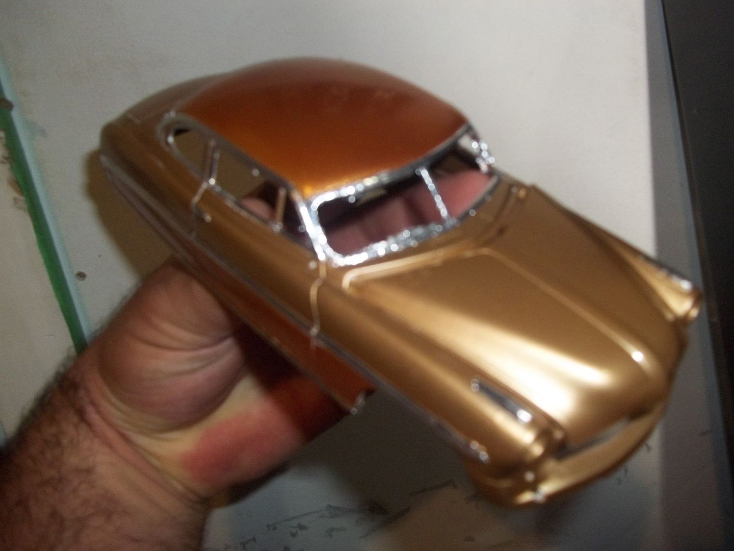

Longbox55 Posted September 12, 2015 Posted September 12, 2015 I haven't tested the acrylic clear over hobby paints yet, but the Paint Shop clear works fine over Tamiya and Testors lacquers, and I have had good results using it over Testors enamels, Tamiya acrylics, and even over some of the old Kustom Kolor paints, which I believe are a modified enamel. Testors Inca Gold lacquer Tamiya Lavender lacquer Testors Magnesium Brown enamel Tamiya Clear Blue acrylic, shot over Duplicolor silver Valspar JD Green enamel The roof and side color on the Hudson in my other post is Kustom Kolor enamel, Gamma Gold.
