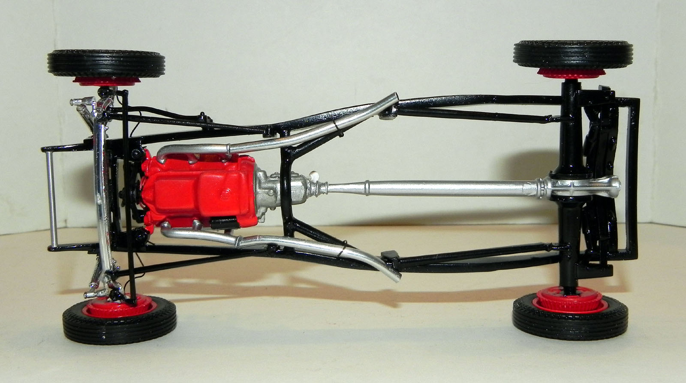

Phildaupho Posted November 6, 2015 Author Posted November 6, 2015 (edited) I will be away from the workbench for a couple of weeks so was anxious to see how the stance and engine location was going to look. Components are just held together with tape and silly putty. The overall ride height and stance were established by mounting of the front suspension. I did lower the front spring closer to the axle and trimmed down the springs leafs. I also think I achieved a lower front stance by using the front frame section from the Revell Deuce kit. The rear may come up a bit once I install the Model-A rear cross member and transverse spring but I do have a quickchange assembly fabricated and widened from the AMT ’25 T kit. It is also now obvious that the sectioning of the Deuce grill shell was required. The engine can sit a little lower so the air cleaner will fit under the hood. Edited November 7, 2015 by Phildaupho
Phildaupho Posted November 26, 2015 Author Posted November 26, 2015 (edited) FRONT SUSPENSION– As mentioned previously the front spring was reduced in thickness and mounted closer to the axle. The front shocks are from the ’29 kit trimmed, modified and mounted up-side-down. I attached the kit headlight mounts to a fabricated shock bracket. REAR SUSPENSION -Once the front ride height was established I was able to install the Model-A rear cross member and transverse spring. The spring/shock brackets were modified from the coil spring brackets from the ’29 kit. The rear radius rods are the extra front rods from the ’29 kit. The AMT ‘25 Model T kit also provided the rear shocks. The drive shaft is modified from the REV/MON 1/24 Deuce. I decided to reduce the amount of chrome on the car so the tie rod and radius rods were de-chromed. REAR WHEELS & TIRES – Used extra set of fronts on rear for Bonneville version ENGINE – The exhaust system and carbs are set up for the Bonneville version. Because I choose to use a three carb manifold like was used by the real car, I had to use an off-set generator which is going to make running the radiator hose on the right side a challenge. Edited December 6, 2015 by Phildaupho
