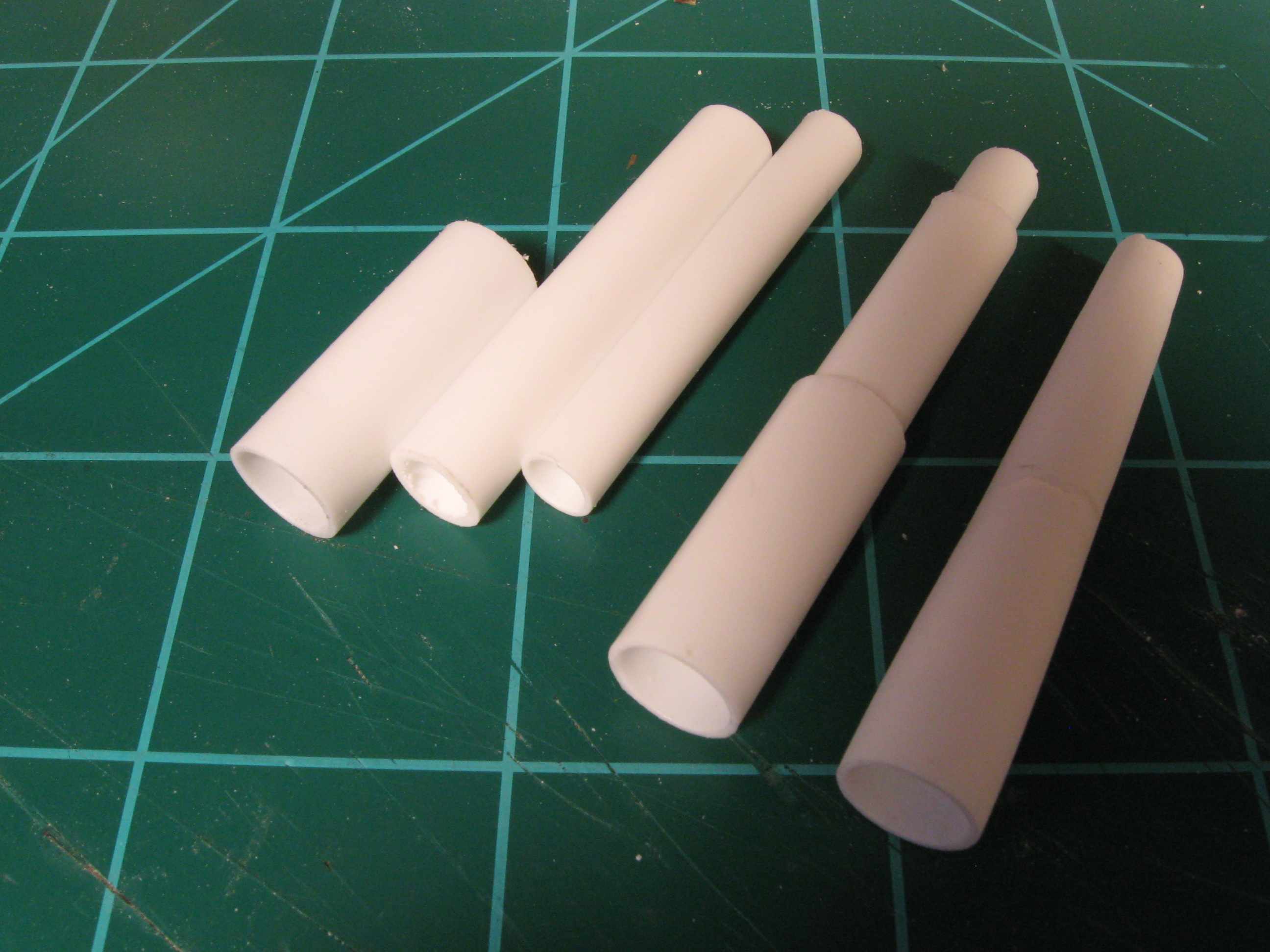

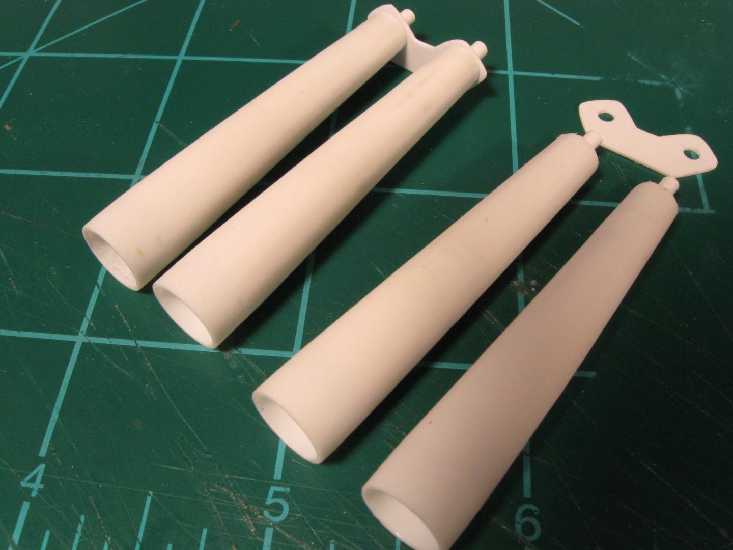

Ridge Rider Posted June 26, 2016 Author Posted June 26, 2016 (edited) Look awesome! How did you cut those circle so perfect? Elyashiv, I just used a circle template then cut them out with scissors and finished with files and sandpaper. Thanks everyone--It looks like progress is going to be slow this summer because well it's summer I have been working on the exhaust pipes but I still am not sure the best way to hang them out there with a minimal look but optimum strength. The pipes are 3/8" tapered to 1/4" and 2" long. I used 3/8", 5/16", and 1/4" tube as the main components. Edited July 7, 2017 by Ridge Rider photos
Spex84 Posted June 26, 2016 Posted June 26, 2016 It never would have occurred to me to fabricate tapered tubes by nesting sections of straight tube and then sanding it down...maybe because I don't have a lathe, but still, awesome idea!!Thanks for sharing all these WIP details with us.

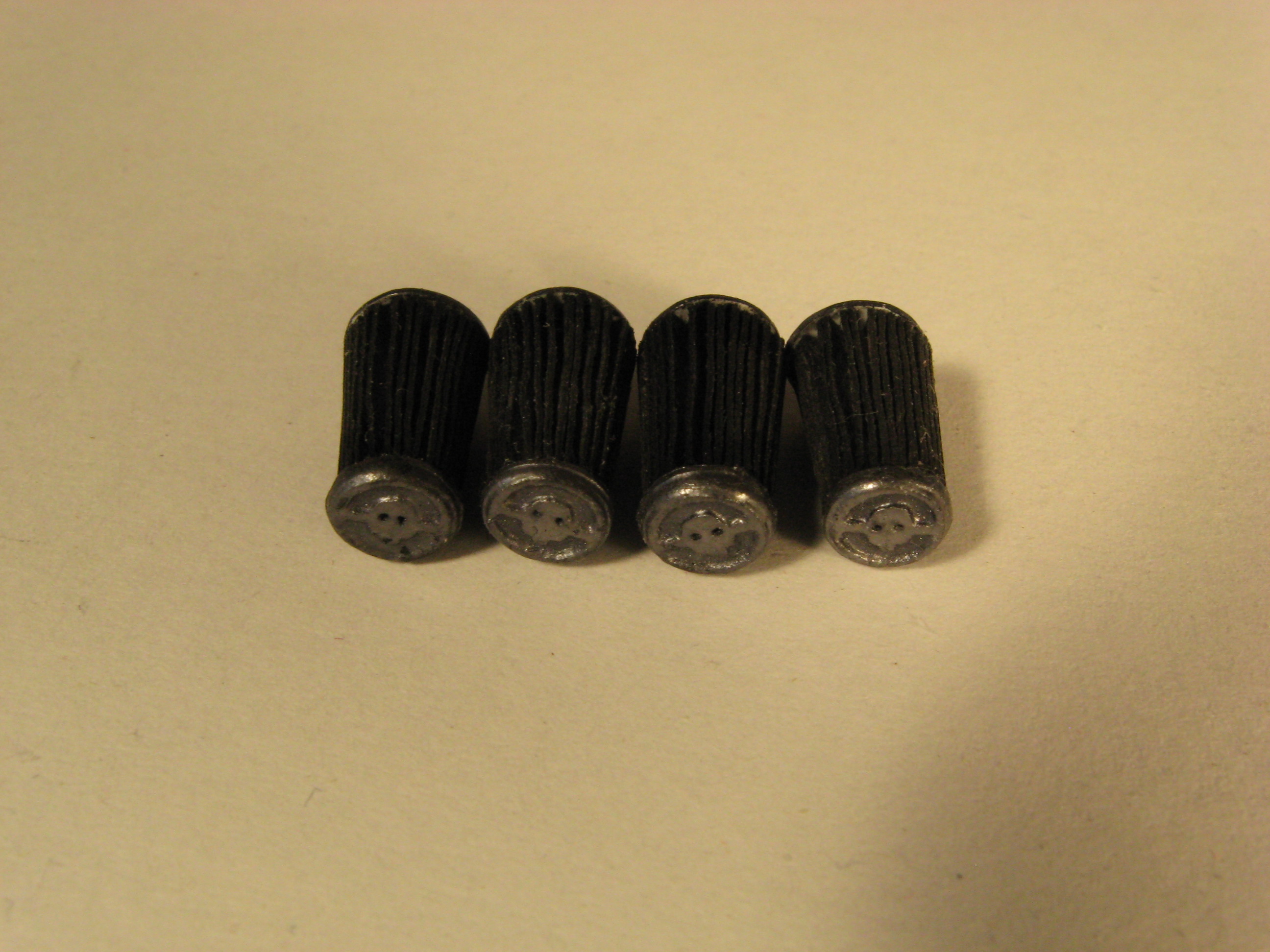

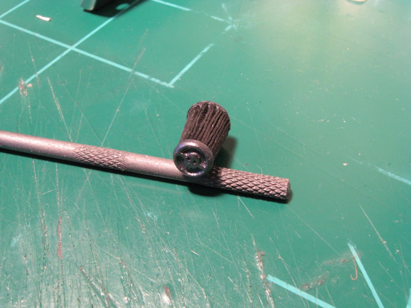

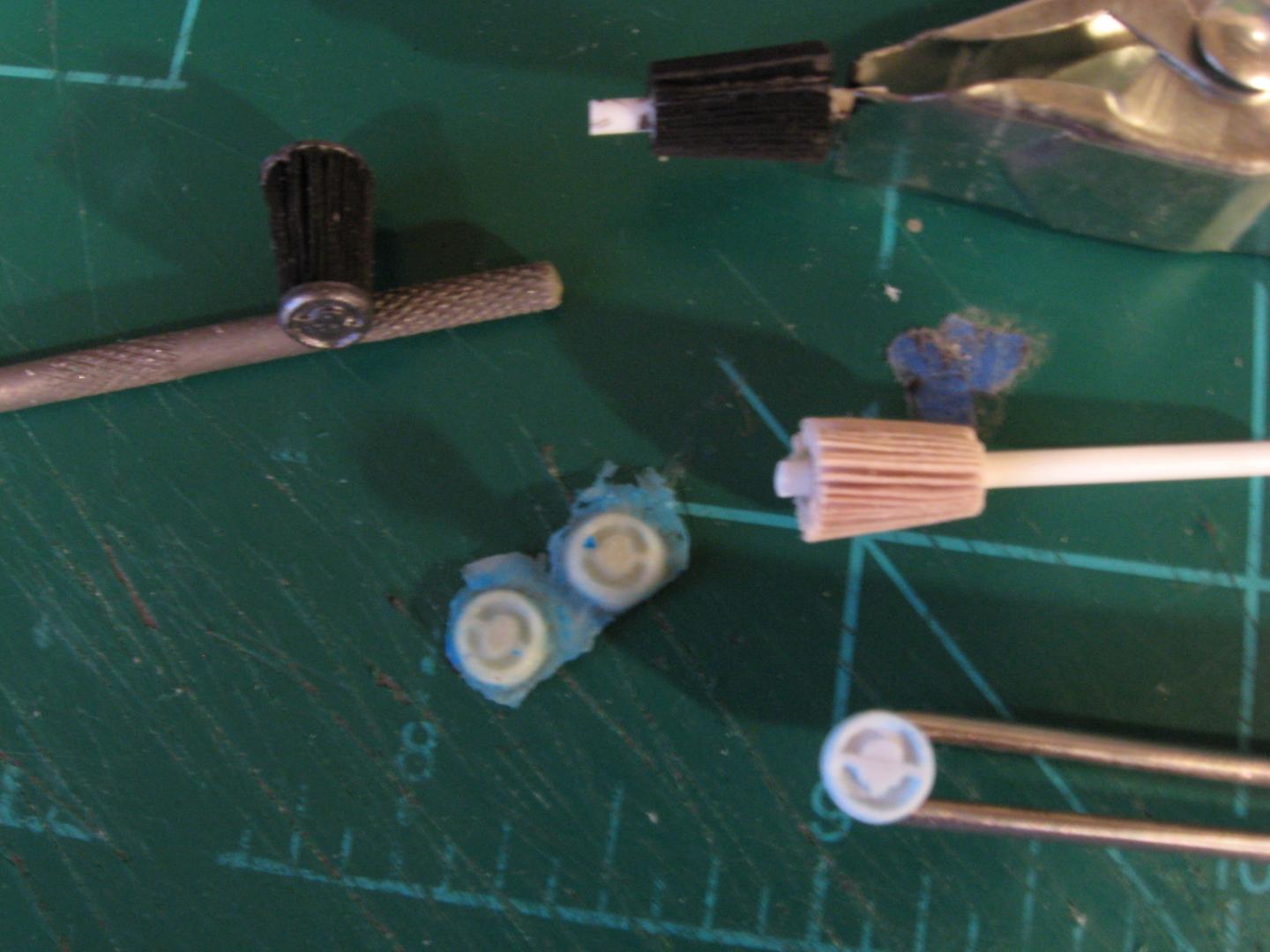

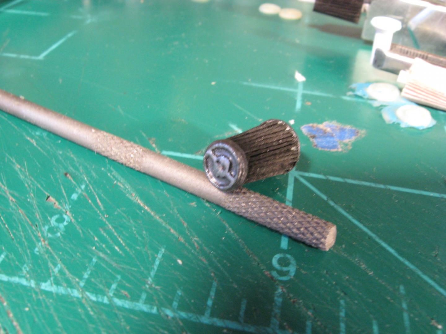

Ridge Rider Posted August 5, 2016 Author Posted August 5, 2016 (edited) Thanks for the support everyone. I'm still sort of taking a summer break but have been messing around with the filter idea. After many failures I think I have 4 that will work. I carved the skull detail on the front cap and then did a simple resin cast for the rest. (another first) I stained the filter with India Ink and added a styrene cap to the back. They are tough to photograph but it should work. Edited July 7, 2017 by Ridge Rider photos

Ridge Rider Posted September 22, 2016 Author Posted September 22, 2016 (edited) Bueller.................................Bueller.......................................Bueller? Just checkin' in. Thanks for the continued interest in my project guys. This will not die on my workbench but work is just crazy right now and the days don't seem long enough. I did manage to get 4 filters that somewhat resemble each other. I think they will look the part. Thanks again, Steve Edited July 13, 2017 by Ridge Rider photos
mustang1989 Posted September 22, 2016 Posted September 22, 2016 Man it's great to see you back Steve! Air filters all look uniform as well as awesome to me!!
Slomoslam Posted September 30, 2016 Posted September 30, 2016 Those air filters look great, the skull is such a cool touch. KEEP IT UP!!
