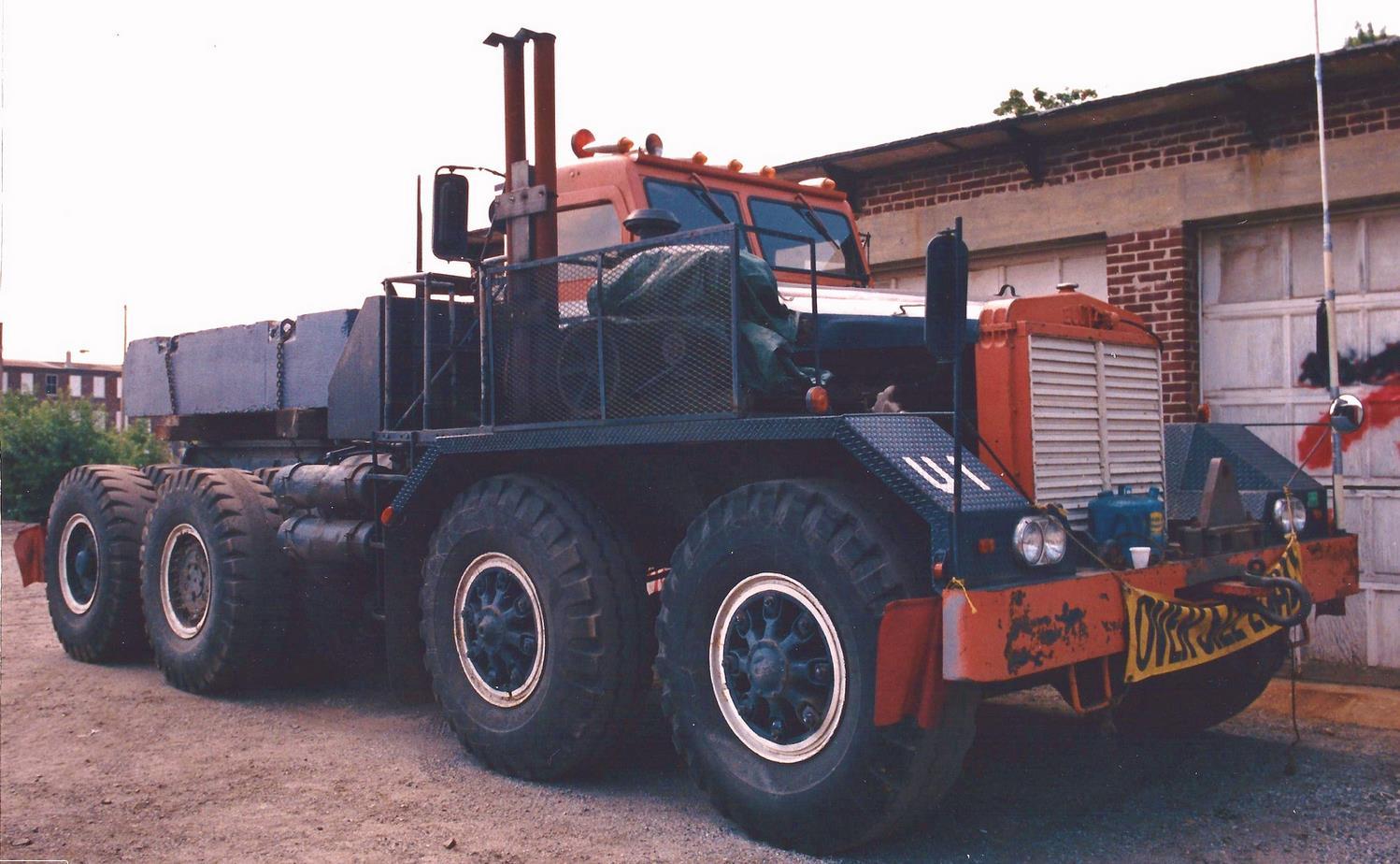

Tesla Posted October 7, 2015 Posted October 7, 2015 I've been researching the history of the 8 X 4 Euclids owned by Hake Rigging. Does anyone know if these had twin diesel engines and if so, what brand? Any and all info would be greatly appreciated!
gatorincebu Posted October 7, 2015 Posted October 7, 2015 (edited) Dennis, I am just wag ing here. I think they might be 6cyclynders if they are side by side. Cummins maybe?? But then again Euclid was owned by GM then . I think? Do I sense another of your cool projects? If so I may have something for you?? Be Well Gator Edited October 8, 2015 by gatorincebu

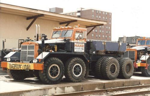

landman Posted October 7, 2015 Posted October 7, 2015 This shot puts it in perspective, or is it one of those tiny Autocars?
gatorincebu Posted October 8, 2015 Posted October 8, 2015 That is one huge beast of a truck! I like it. Be well Gator
jeffbrad Posted October 8, 2015 Posted October 8, 2015 (edited) The Euclid stuff from back then ran Detroits due to the GM ownership. They used the 6 110's in the dozers and scrapers and off road dumps. Not sure about that 8x4. Never seen one but it sure is cool. If it has 2 engines side by side they're probably 671's. They did build a power unit that had 2 of them side by side. P.S. Did some digging and they were available with either Cummins or Detroits although the Detroits were more common after GM bought Euclid in 1953. Edited October 8, 2015 by jeffbrad
Superpeterbilt Posted October 8, 2015 Posted October 8, 2015 Dennis, from what my book says (there isn't a twin steer model in it), it could have had either twin Detroit 6-110's, twin Cummins NRTO-6-BI "turbo diesel", or one truck had twin Detroit V12's. All trucks in the book have Allison 4 or 6 speeds, some trucks have two trans. As for the model, it could be a 1LLD, 2 LLD, 3LLD, 4LLD, 5LLD, or 6LLD. Also a R-55, or a R-62. These all look the same as the Hake truck, but not twin steer.
gatorincebu Posted October 8, 2015 Posted October 8, 2015 The side by side motor fits . As there was a Eclid dozer that had the side by side motors.. I saw on when I was a kid. It was a real monster back then. Be Well Gator
Tesla Posted October 8, 2015 Author Posted October 8, 2015 This shot puts it in perspective, or is it one of those tiny Autocars? It certainly makes the Autocar look small

Tesla Posted October 8, 2015 Author Posted October 8, 2015 Thank you everyone for your input...very much appreciated!! Here's a picture that shows the engine. (photo by John Pearson) It seems to resemble a Cummins? Let me know what you think...
Superpeterbilt Posted October 8, 2015 Posted October 8, 2015 Yes that definitely looks like Cummins manifolds on both trucks.
truckabilly Posted October 8, 2015 Posted October 8, 2015 If the engines are side by side then each powers one side of the truck, right? No need for diffs. Or is it more complicated?
Tesla Posted October 8, 2015 Author Posted October 8, 2015 If the engines are side by side then each powers one side of the truck, right? No need for diffs. Or is it more complicated?Having a picture of the drivetrain would certainly be beneficial. This is something I haven't been able to locate. As they say, "a picture is worth a thousand words"
