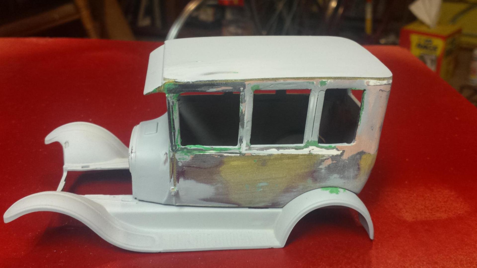

Eric Macleod Posted October 8, 2015 Posted October 8, 2015 I have been playing around with this one for awhile. Lots of work still to be done.
Eric Macleod Posted October 8, 2015 Author Posted October 8, 2015 (edited) Here is a bit of background on this one. My dad's first car was a 1926 Ford Model T Fordor (yes, that is the correct spelling) Sedan. He bought the car in pieces in 1953 for $50.00. He sold the car when he went to college but was able to buy back the car in 1970. We have had the car ever since. The 1:1 car has a mostly original interior and undercarriage. I rebuilt the engine 20 years ago and have used the car ever since.A holy grail has been to create a model of this car. What I have done so far is to take a Revell '26 Ford Tudor, ground off the door moldings and cut the body off from the beltline up. I retained the top. Then I took a front body section of a AMT '25 T coupe and used it for the front door tops. I used another front half of a '25 T coupe and used the front of the rear windows. For the rear part of the rear windows and aft pillars I used more '25 Coupe parts. Finally, I used the back of another Revell '26 T Tudor body for the backlight and the upper portion of the rear body.I glued these pieces to the retained top and then wedded the assembly to the Tudor lower body. Lots of filler and sanding later and you have the product you see above.Showing my hand just a little, this is going to be the centerpiece of a complete set of all six of the bodystyles of the car Ford marketed as the "Improved Ford" for 1926. This will include the easy one, the '26 Touring, a model I have already finished, a '26 Runabout (unequipped), '26 Coupe, '27 Tudor, and the '27 Roadster Pickup.More to come soon. Edited October 8, 2015 by Eric Macleod

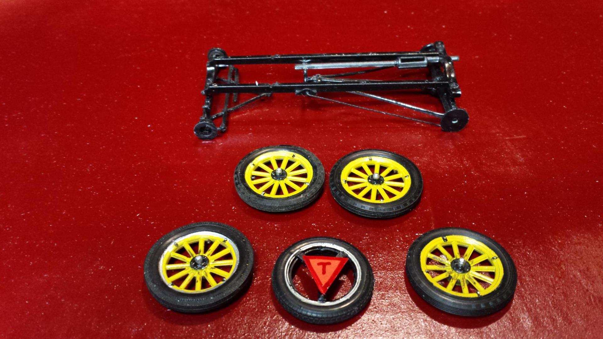

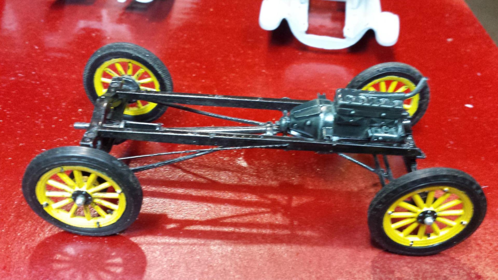

Eric Macleod Posted October 9, 2015 Author Posted October 9, 2015 Tonight I worked on wheels and some chassis details. Sharp eyes will notice that the tires don't match and there is a non-matching wheel in the mix also. That is the way dad's car is.

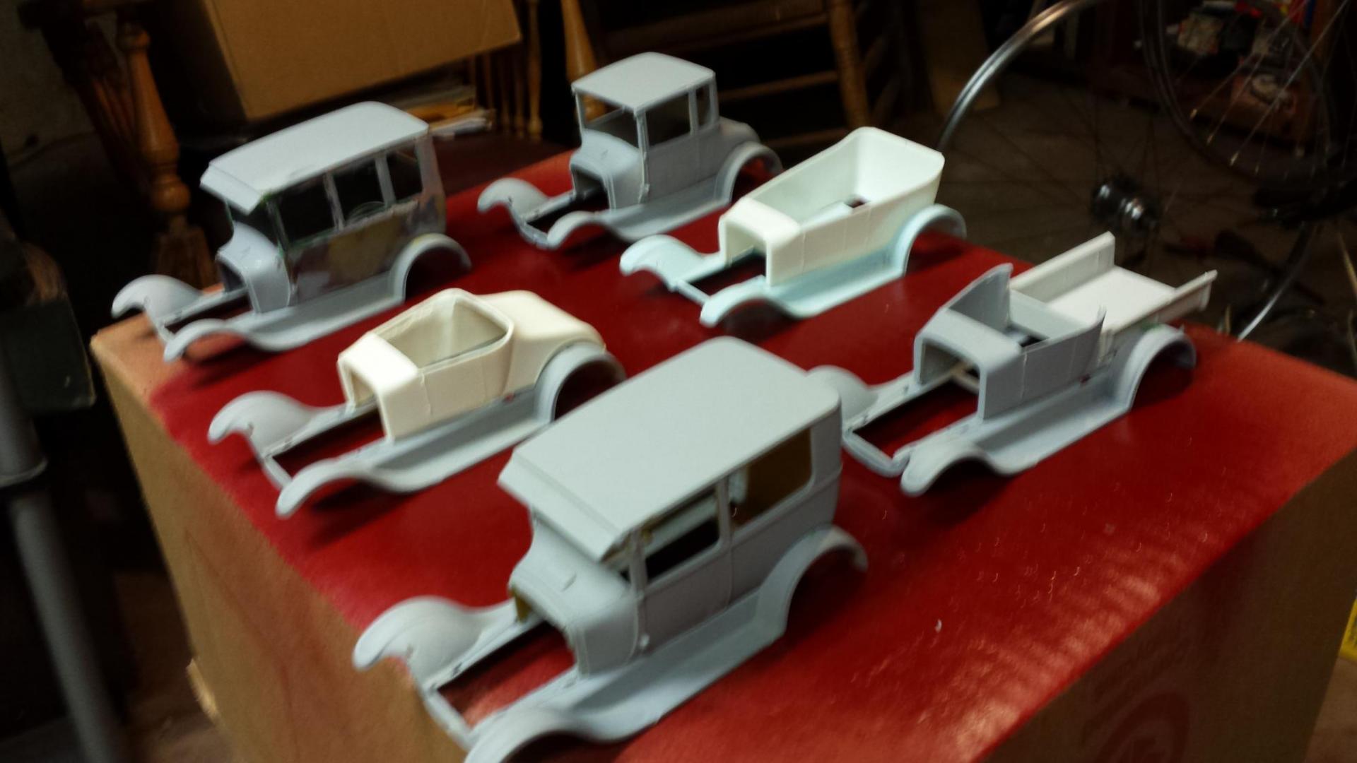

Eric Macleod Posted October 12, 2015 Author Posted October 12, 2015 This will give you an idea of what I am ultimately shooting for with this project. I have also mocked up the chassis.

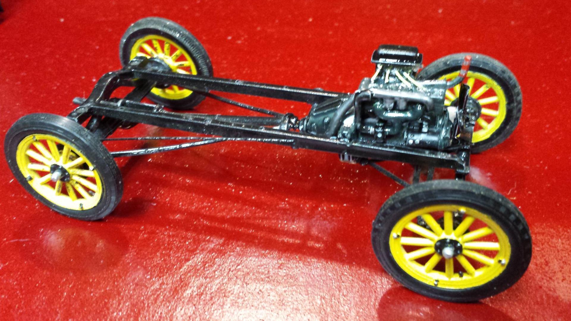

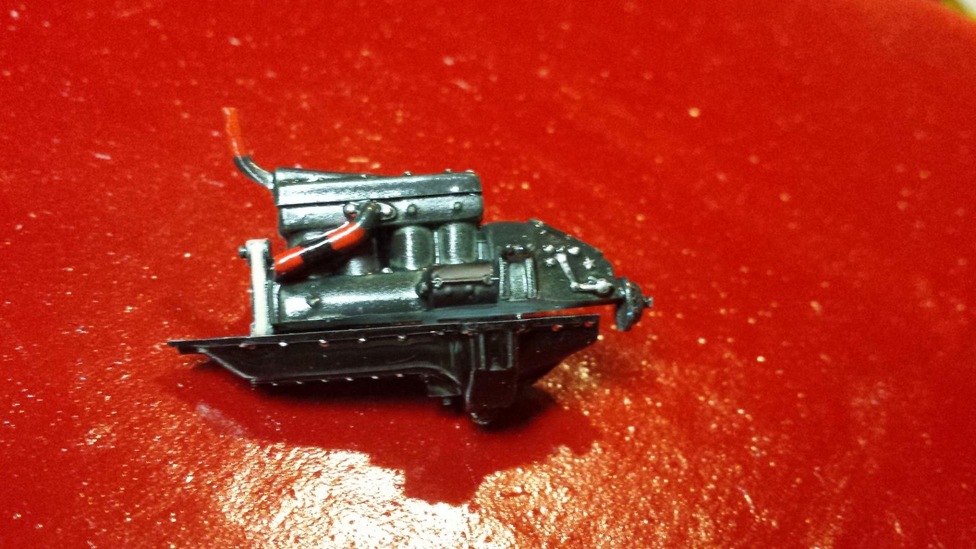

Eric Macleod Posted October 13, 2015 Author Posted October 13, 2015 Another update. I am working on engine details. This is a little difficult because it is a dark green engine with black accessories. It is correct for the way Ford did things but not terribly visually exciting. Some dirt and grease will help.

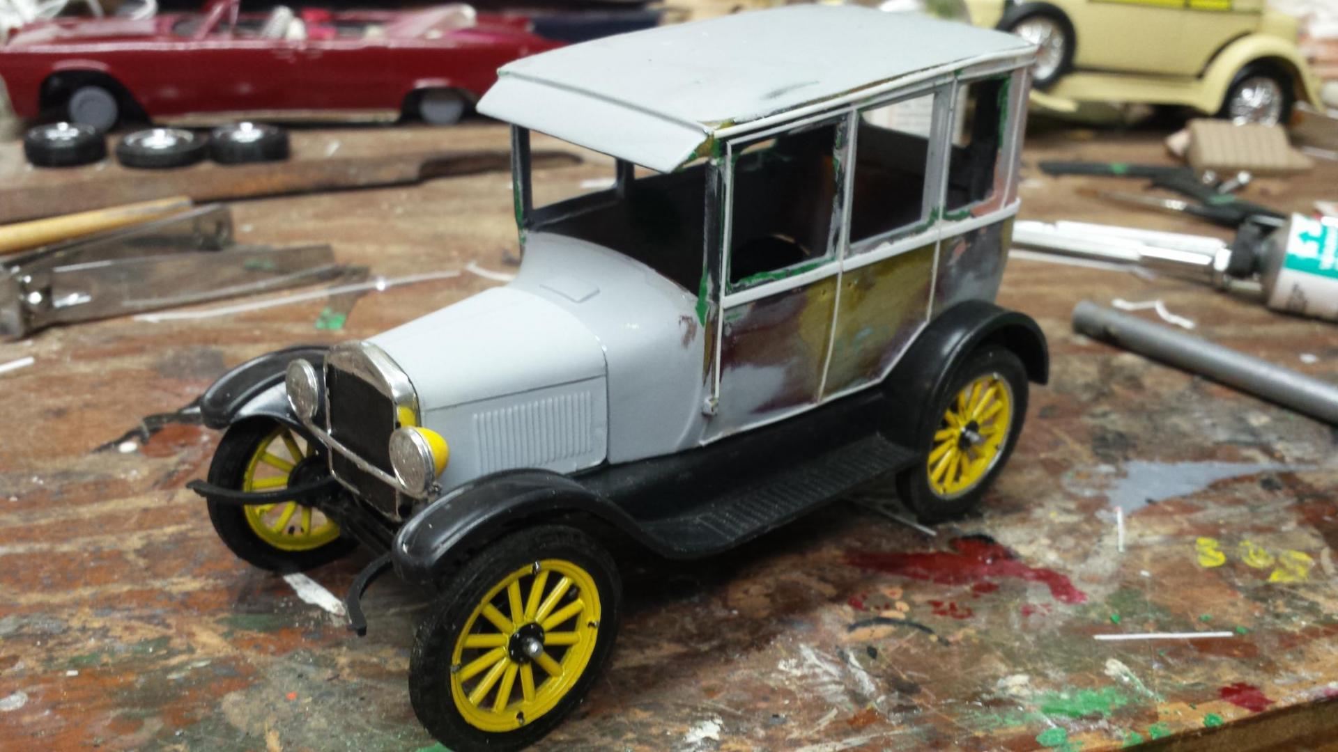

Eric Macleod Posted October 14, 2015 Author Posted October 14, 2015 I made some significant progress this evening. I have the chassis pretty well done. While I planned to use Buttera fenders it became very obvious during this mock up that AMT fenders will work better. I have a lot of fitting to do and significant body work as well but it is starting to look like a car. Clearly this is a work of compromise but I will be proud to display this one . Thanks for looking.

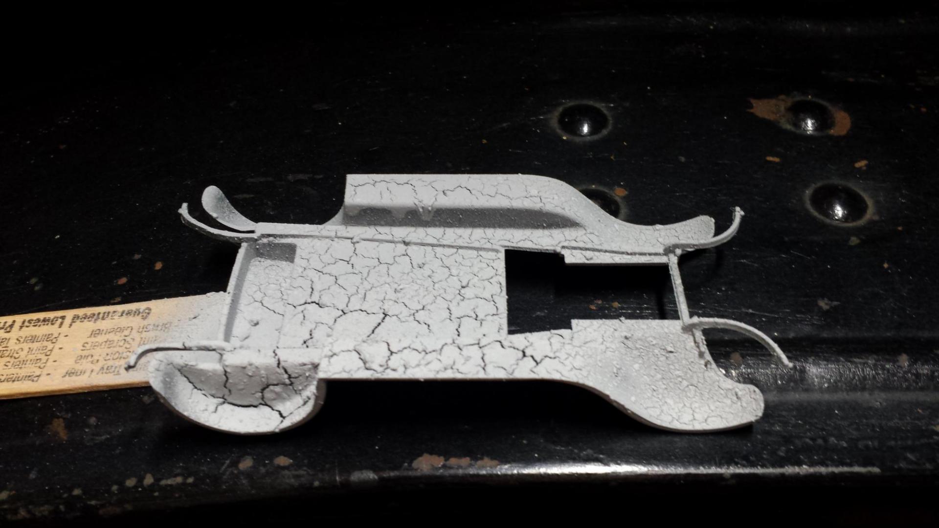

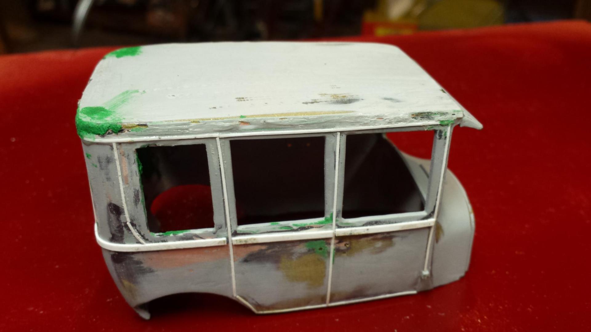

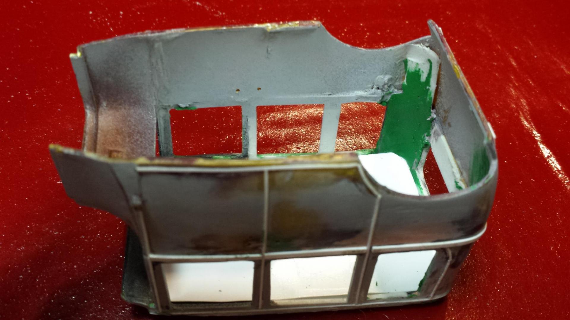

Eric Macleod Posted October 16, 2015 Author Posted October 16, 2015 While it probably doesn't look like I got much done tonight I made a lot more progress. The entire body was sanded and I added the headliner. There are a few more details like interior door panels and a little more work on the windshield header. Otherwise I an ready for some primer. Speaking of which have a look at what happens when you grab the wIrong can of paint. If it's a job worth doing it's worth doing twice.
Eric Macleod Posted October 16, 2015 Author Posted October 16, 2015 Here are my freshly primed fenders.
