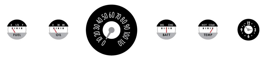

Helper Monkey Posted October 15, 2015 Author Posted October 15, 2015 First off, Thank you everyone for your responses. I think I have decided to head in another direction. After looking at images of 49 mercury interiors I realize that the gauges supplied in the kit are not accurate. In addition they kept falling off and they have chipped a little now. I decided to create my own in Illustrator and print them on paper. Down worry the image below is blown up. The small gauges are 1.5mm and the big one is 4mm. I have a japanese screw hole punch, I just need to get the really small bits for it to cut them out of the paper. I may even put resin to simulate glass. Now My Epson R220 may work but I need new cartridges for it, Once I get those I will be all set. If it does not then maybe the big Epson at work will print that fine. It's made for Art Reproductions.
Foxer Posted October 15, 2015 Posted October 15, 2015 I have a japanese screw hole punch, I just need to get the really small bits for it to cut them out of the paper. I may even put resin to simulate glass. Now My Epson R220 may work but I need new cartridges for it, Once I get those I will be all set. If it does not then maybe the big Epson at work will print that fine. It's made for Art Reproductions. A hole punch is definitely the way to go as you'll have to print those on white decal paper. Your Epson 220 will be fine to print them ... I have an Epson R3000 I use but it's the same Epson resolution. I've printed decals I can't read by eye but everything is clear under magnification. Use the best photo print setting and let the ink dry a day. Then an acrylic clear coat. Best of luck and let us see the results you get.
Tom Geiger Posted October 15, 2015 Posted October 15, 2015 I decided to create my own in Illustrator and print them on paper. Down worry the image below is blown up. The small gauges are 1.5mm and the big one is 4mm. I have a japanese screw hole punch, I just need to get the really small bits for it to cut them out of the paper. I may even put resin to simulate glass. Now My Epson R220 may work but I need new cartridges for it, Once I get those I will be all set. If it does not then maybe the big Epson at work will print that fine. It's made for Art Reproductions. Nice work on the gauges! I have some of the Detail Master printed gauges that came with their photo etch sets. Note that they printed theirs on paper rather than decal. So it's a good decision to go with paper VS decal. Also a good choice to use a punch to cut them out round. Print many, punch many, pick the best ones to use on your model. For applying the gauges I use Microscale Micro Kristal Klear. This is a product that many people use to install clear glass and make windows on aircraft and ships. It's really a very good white glue. Use this to glue in the gauges, then add a dot of this over each lens. It may take a day or two, but it will dry clear and will be a convincing lens. The Kristal Klear is the bottle on the left in this photo.
Helper Monkey Posted October 16, 2015 Author Posted October 16, 2015 Nice work on the gauges! I have some of the Detail Master printed gauges that came with their photo etch sets. Note that they printed theirs on paper rather than decal. So it's a good decision to go with paper VS decal. Also a good choice to use a punch to cut them out round. Print many, punch many, pick the best ones to use on your model. For applying the gauges I use Microscale Micro Kristal Klear. This is a product that many people use to install clear glass and make windows on aircraft and ships. It's really a very good white glue. Use this to glue in the gauges, then add a dot of this over each lens. It may take a day or two, but it will dry clear and will be a convincing lens. The Kristal Klear is the bottle on the left in this photo. Thank you. I am going to look into the detail master gauges too. For some reason I never thought to check aftermarket. The glue sounds a lot like the White PVA bookbinding glue I use. It dries super clear and flexible. I used the Epson 4880 at work today on glossy photo paper. I exported my Illustrator file as a pdf and printed it. It did not turn out good. I am going to try bringing the native file and print it strait from photoshop. cause there is no Illustrator at work. I also created a 600 dpi and a 900 dpi tiff file to see if i can get better detail. I think I need to mess with the printer settings too in order to get the results I want.
Foxer Posted October 16, 2015 Posted October 16, 2015 I used the Epson 4880 at work today on glossy photo paper. I exported my Illustrator file as a pdf and printed it. It did not turn out good. I am going to try bringing the native file and print it strait from photoshop. cause there is no Illustrator at work. I also created a 600 dpi and a 900 dpi tiff file to see if i can get better detail. I think I need to mess with the printer settings too in order to get the results I want. That is odd as you will not get better resolution than that printer .. Epsons print at an effective resolution of 1440 dpi! with my Epson R3000. I always change resolution of my decal photos first thing in Photoshop to 1500 dpi. Do not resize the image when doing this. All my editing and re-sizing starts from there. I always print from Photoshop at the highest print settings for Epson premium glossy paper. This is the back of a van my daughter owned that gives an idea of the resolution you should be getting. The model is 1/25 for reference. These bumper stickers were from my first digital camera .. a 4mp thing and the photo I used was the whole back of the van, so they weren't too high resolution to start with. Feel free to ask me anything about this.

Helper Monkey Posted October 17, 2015 Author Posted October 17, 2015 That is odd as you will not get better resolution than that printer .. Epsons print at an effective resolution of 1440 dpi! with my Epson R3000. I always change resolution of my decal photos first thing in Photoshop to 1500 dpi. Do not resize the image when doing this. All my editing and re-sizing starts from there. I always print from Photoshop at the highest print settings for Epson premium glossy paper. This is the back of a van my daughter owned that gives an idea of the resolution you should be getting. The model is 1/25 for reference. These bumper stickers were from my first digital camera .. a 4mp thing and the photo I used was the whole back of the van, so they weren't too high resolution to start with. Feel free to ask me anything about this. Thanks! I think I just need to mess with the settings. I was busy at work today so I never got the chance to see if it would work. Then again my gauges may be too small for that detail. the small ones are only 1.5mm and the large one is 4mm. not exactly large. Your stickers look really great. with a lot of good detail.
