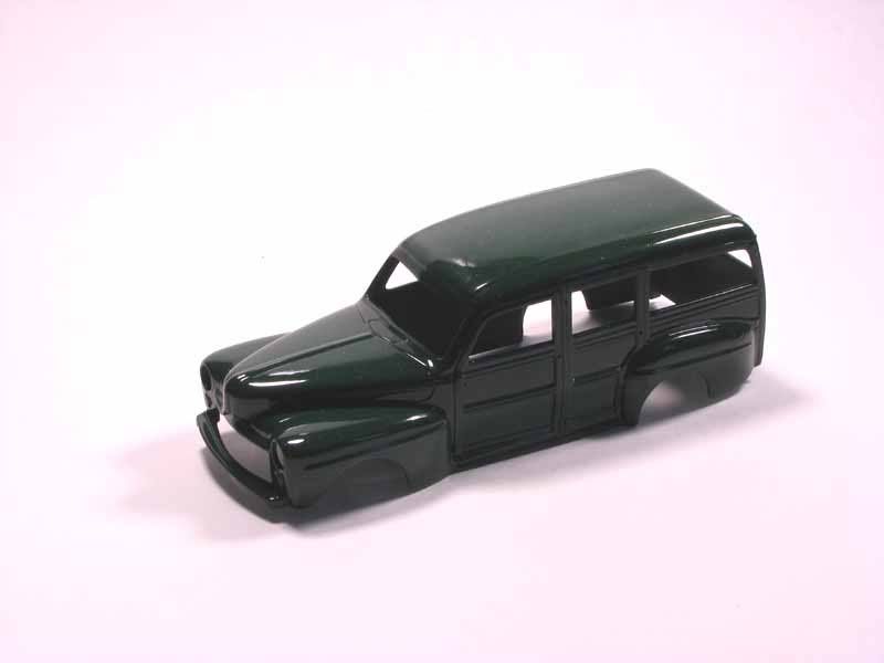

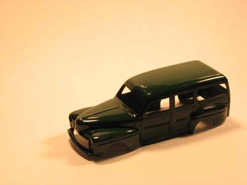

m408 Posted March 16, 2008 Author Posted March 16, 2008 I do have a degree in film. If you post some troublesome shots I might be able to id your problem O.K. Cal, Here are some shots using the same settings for each. How come it goes from gray background to white to pink? I have been told that it has something to do with "white balance" but I can't figure it out.
CAL Posted March 16, 2008 Posted March 16, 2008 (edited) Yeah, it looks like a WB issue. Cannon says you cannot produce natrual color with Auto WB. Cannon has always been a little more WB sensitive than other cameras. You may need to set WB for the light you are using IE tungstun or Fluorecent, and see if you get the results you desire. The best thing would probable get a balance card use custom setting on WB and WB on a WB card. In otherwords, the camera needs to be told here this is pure white so use this as a white baseline, but you have to manually set it up. Then, you just need to WB everytime you shoot or set up a custom preset fo WB wherever you are shooting, if you are using the same set up often. The reason why the background is changing is your shot is changing. AWB is using the aggregate composition of the shot to adjust WB. It doesn't know your background is white so it using the background the object and quesstimate light source color temp and coming up with an average WB setting depending on what is all in the frame. on a side note. Red is the most difficult color for a digital camera to process correctly. It just has to do with the light sensor technology in digi cams. Another thing I notice is your light choice. Halogen light is a complicated light source to color balance to. First it's not a typical color temp like light day light or tungsten. Also Halogen color temp changes slightly with wattage and distance. Xenon would be a better choice, Tungsten would be a good choice, even the cool blues and greens of Fluorecent would be an easier light to work with than Halogen. HTH Edited March 16, 2008 by CAL
Aaronw Posted March 16, 2008 Posted March 16, 2008 (edited) I just took these real quick as an example, so ignore the fact they are not that great, I didn't even move the lights so they are much farther away than normal which is why I think the adjusted photo has a slight pink tinge. Except for the last pic they are only edited for size, no other adjustments, the last pic had no color adjustments just brightness / contrast. This first one was taken set on daylight This next one was taken with the white balance set to tungstun (Incandescent or the regular egg-ish shaped light bulbs) This last one I used the tungstun setting and then used Photoshop to adjust brightness / contrast just to brighten it up. Any photo editing software should let you do this. On my camera white balance is found under functions, I open the function menu, then I select the bar that has AWB (automatic), a sun (daylight), a cloud (cloudy), a lightbulb (tungstun / incandescent), a tube (flourescent) and a tube with an H (not sure on this, halogen?). I'm pretty sure mine is different than other cannons though, mine has a thunmb toggle kind of like a video game which I haven't seen on other cameras. The adult school near me had a class for beginning digital photography. I never took it but it sounded like it was just an experinced photographer who helped people figure out how to use the various functions on their camera. Something like that sounds perfect for you if there was someplace offering a class like that. Edited March 16, 2008 by Aaronw

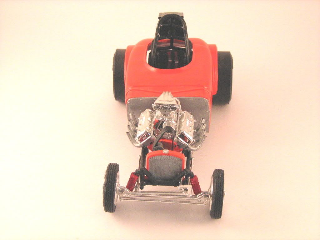

MikeMc Posted March 17, 2008 Posted March 17, 2008 (edited) Or go outside, set to aperature priority(f8 or so) turn on the flash and practice by looking at the shadows with and without flash. Color temp will change the way things look to us. Incandescent bulbs will make things have a yellow/orange cast Flourescent (f40cw) tubes have a bluish tint. And then there is the sun..the best light source This picture was taken using these tips notice the shadows and all details are evenly lit!! simple camera, operator, and setup.....just lotsa practice!! Edited March 17, 2008 by MikeMc

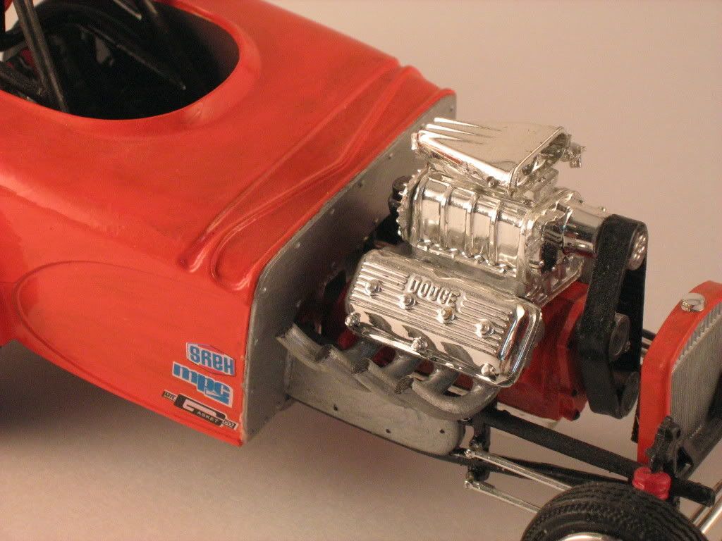

m408 Posted March 17, 2008 Author Posted March 17, 2008 Thanks all for the help. I read the manual and figured out, I think, the white balance. Changed out the holagen bulbs with the same ones that I use in my house lamps. Just posted some pics on "under glass" of my latest build taken with the new set up. I think that they came out O.K. (if you ignore my building skills). Thanks again all for your help.
