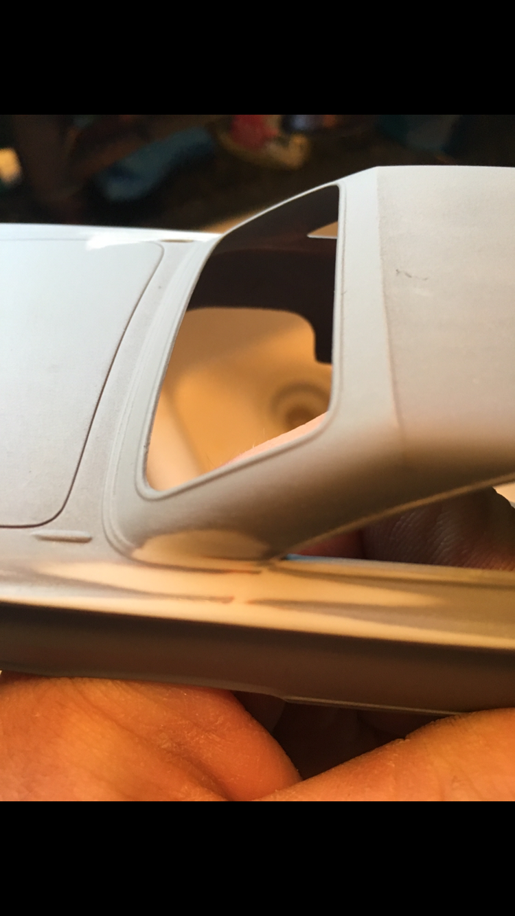

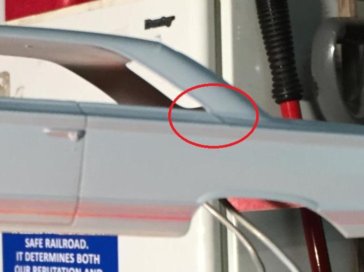

Sledsel Posted October 22, 2015 Posted October 22, 2015 Another great old kit.... Get some foam fingernail sanding sticks at Wal Mart and sand out those mold lines on the top of the rear fenders. Doing so will really make a difference when you are done. I have one on the shelf and I did not sand them and it drives me crazy. As for color, I prefer darker colors on these boats, and red... but you been there.

Againmikewins Posted October 22, 2015 Author Posted October 22, 2015 Another great old kit.... Get some foam fingernail sanding sticks at Wal Mart and sand out those mold lines on the top of the rear fenders. Doing so will really make a difference when you are done. I have one on the shelf and I did not sand them and it drives me crazy. As for color, I prefer darker colors on these boats, and red... but you been there. Are you talking about the side shots of the body, where the line runs right through where it says "Park Lane"? For a '64 Merc, you almost have to go with "Bittersweet" don't you? Definitely the most unusual color for '64. Although, it's not for everyone! Steve I actually agree with you on it!

Sledsel Posted October 22, 2015 Posted October 22, 2015 this mold line here..... as for your paint, if going with a solid color, try WalMart again, or Lowes or Home Depot. Check the Krylon colors out, they have something very close to Peacock. Also, Hobby Lobby or Michaels carry Krylon Short cuts. I have had very good luck with Krylon paints on my kits. I have not tried the "2x" cover paints, so I am not sure what to say bout them.

BIGTRUCK Posted October 22, 2015 Posted October 22, 2015 The mold lines should come off thats true , but when I did mine the sink hole at the leading edge of the right front fender needed the most attention. These Mercurys make for great builds inside and out.

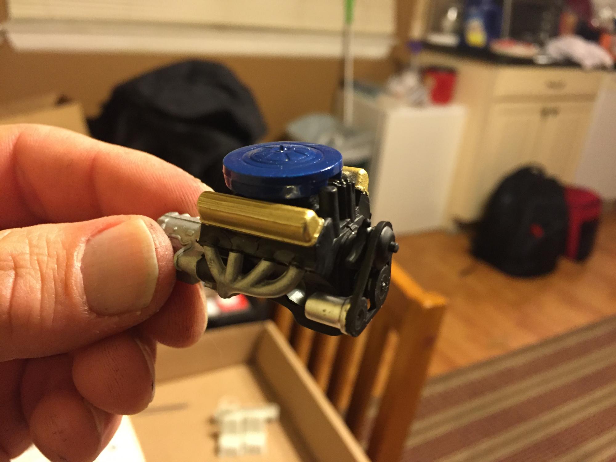

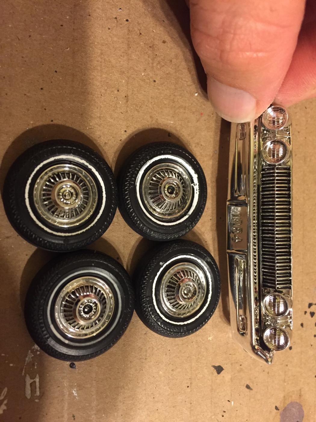

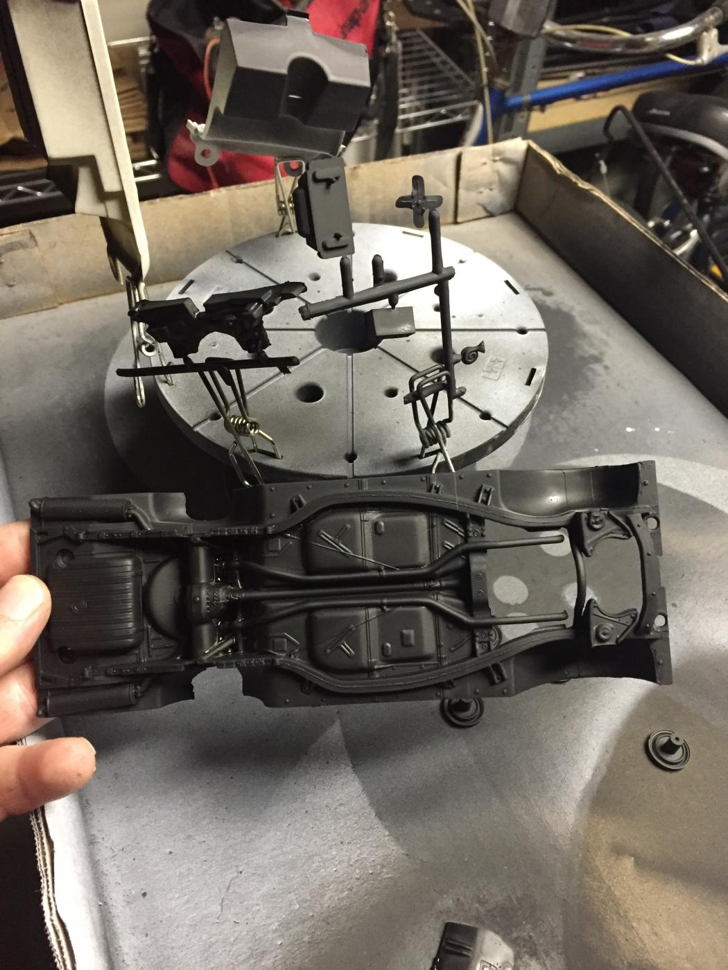

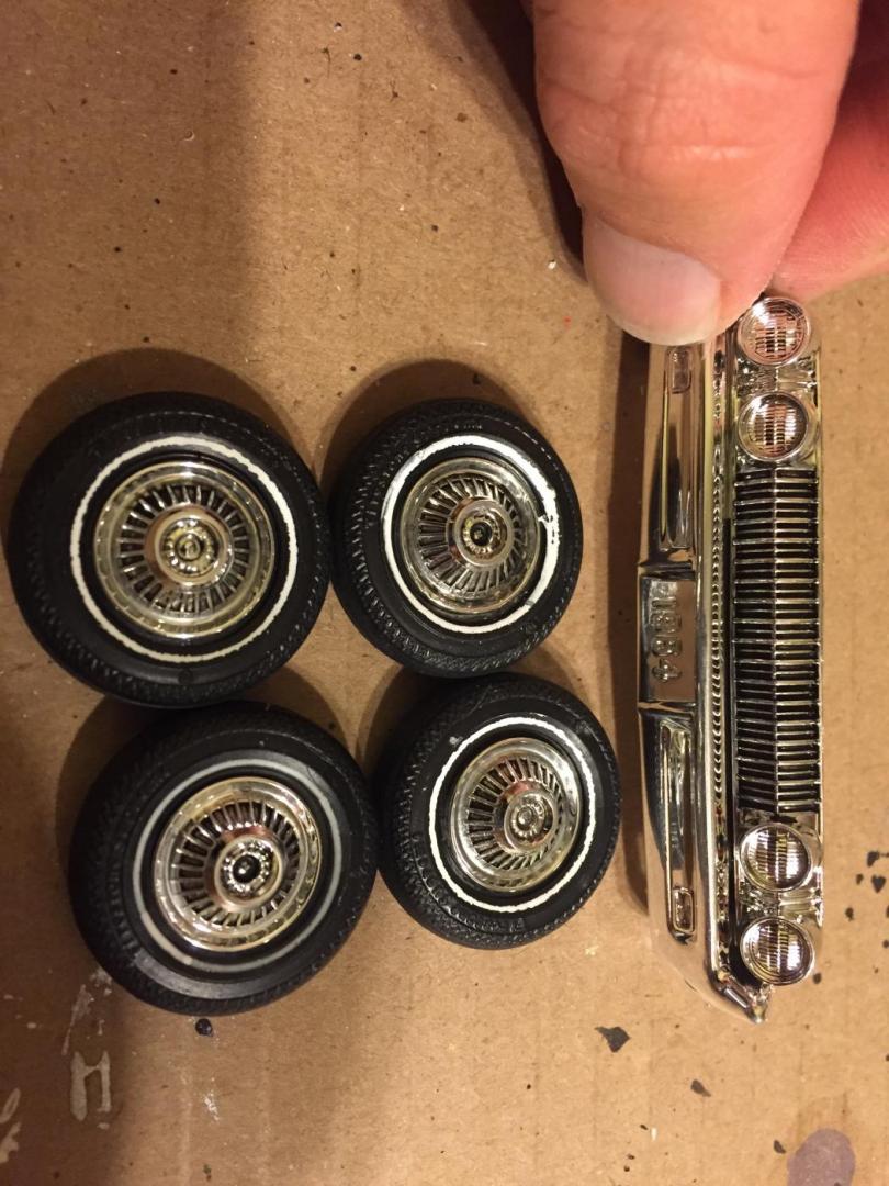

Againmikewins Posted October 29, 2015 Author Posted October 29, 2015 I made a little progress tonight. I'm still undecided on the interior/exterior colors, but it's too humid to spray tonight. I'm leaning toward a couple different blue colors I've got. I'm not going to detail too much on this kit, seeing as everything is molded into the chassis, engine compartment and fire wall and I'm still a rookie. I black washed the grill and wheel covers using Vallejo Acrylic Black I'm pretty happy with the outcome there. I also drew the white rings on the tires using an acrylic gel pen and a stencil. I'm not too pumped with those, so I'll probably soak them and start again. The engine block was painted with Testors Satin Black. The transmission and headers were painted with Model Masters aluminum. The valve covers that came with this kit were chrome plated, so I just went over them with Testors acrylic gold metallic. Finally, the air cleaner with Model Masters Ford Engine Blue. The chassis, firewall and other items were shot with Project Source flat black from a spray can. I think I paid $2 for it. I'm happy with the results. I'll detail those pieces later on. Thank you all for the tips and suggestions regarding the mold lines. I think I rubbed them out pretty good. Since I'm not doing a lighter color, I'll stick with the gray primer. Stay tuned!

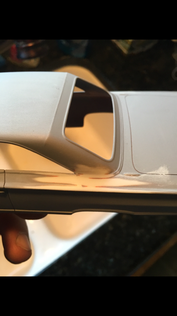

Againmikewins Posted November 4, 2015 Author Posted November 4, 2015 I got some work done today on the body. Thanks for the advice about the mold lines! I wet sanded the primer with 1000 grit and nailed the mold lines with some 320. While spraying the final coat of primer, I dropped the hood on the floor. Now I've gotta sand down that mess! Heres the mold lines, at least.

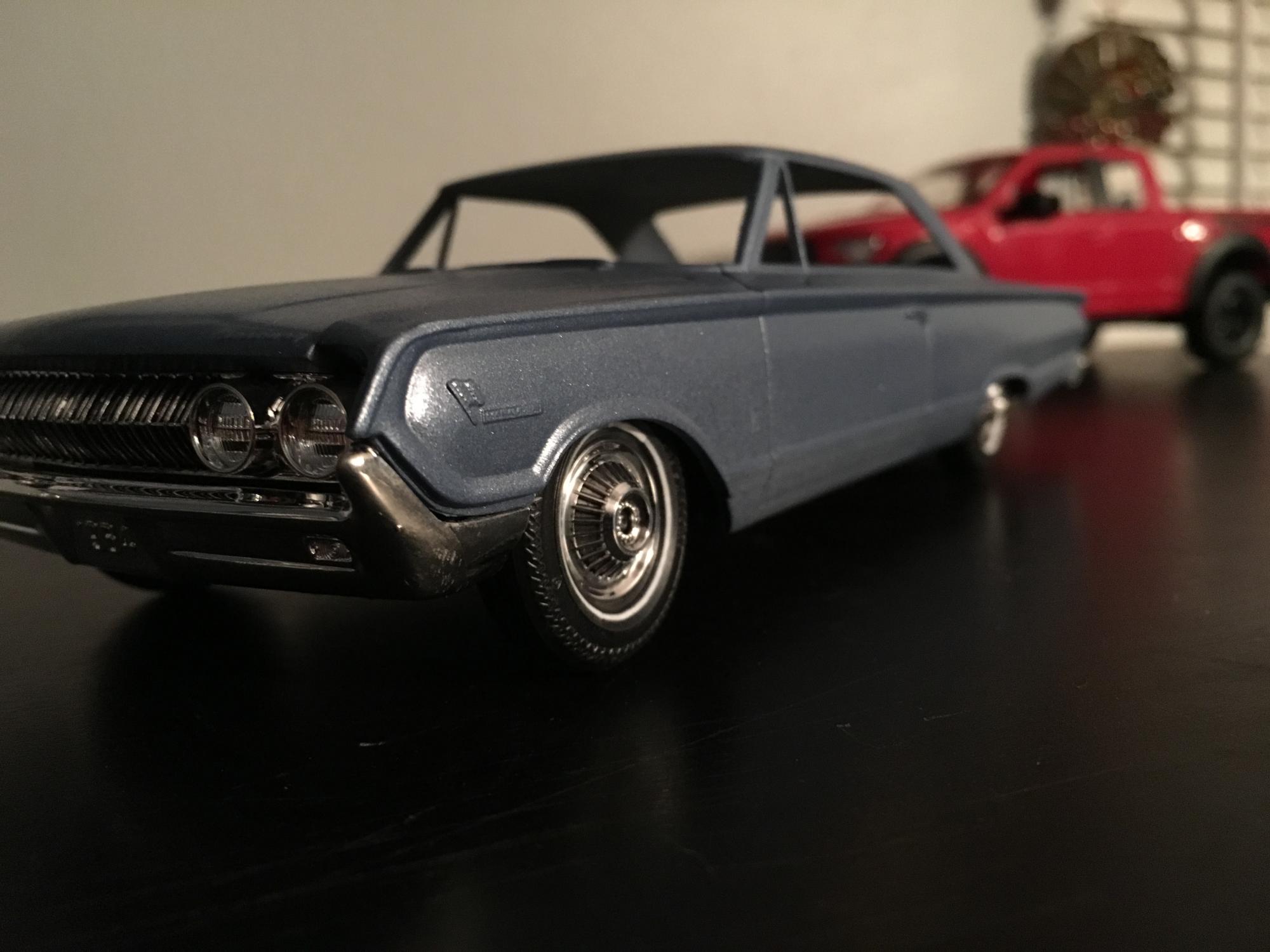

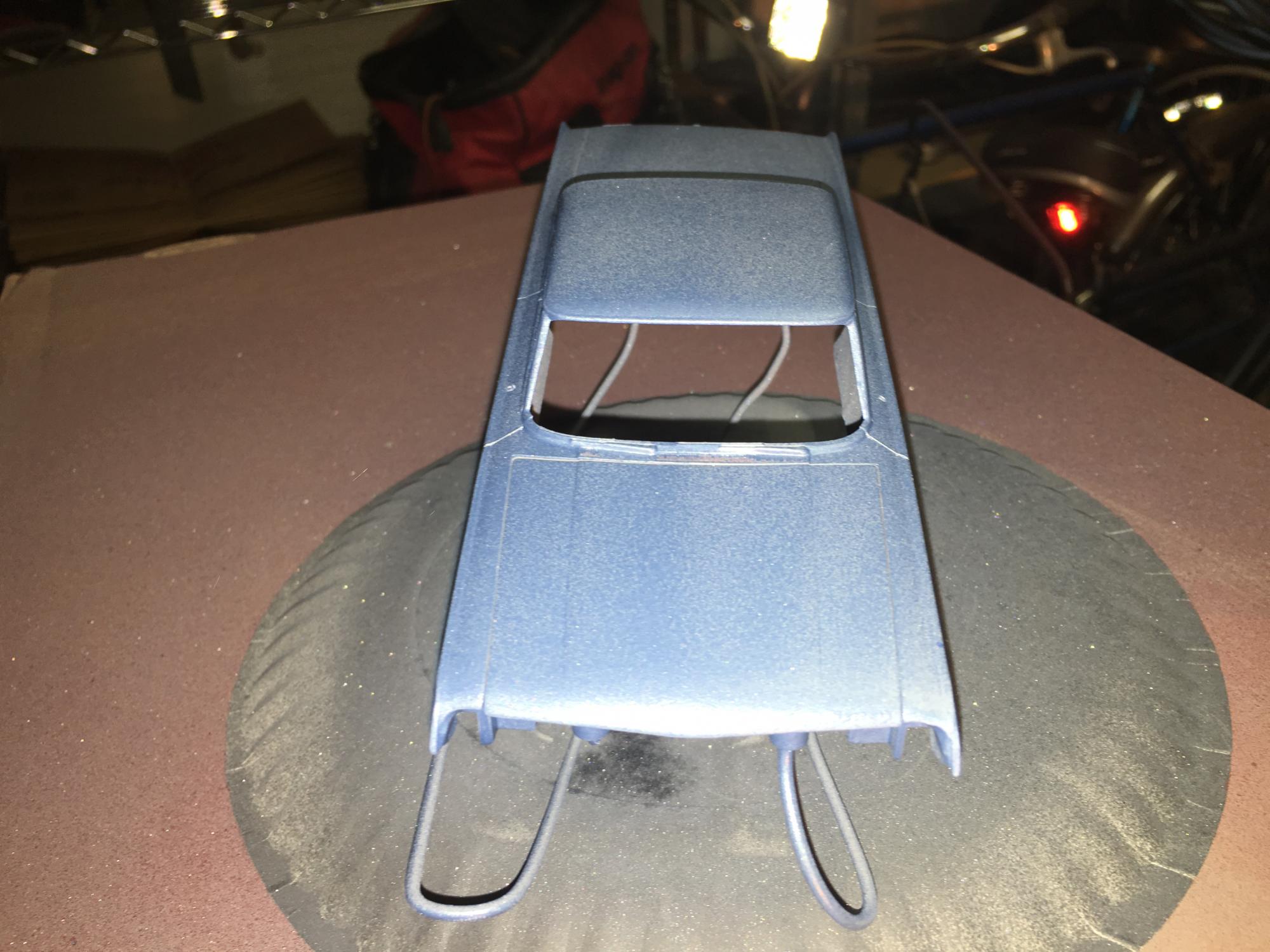

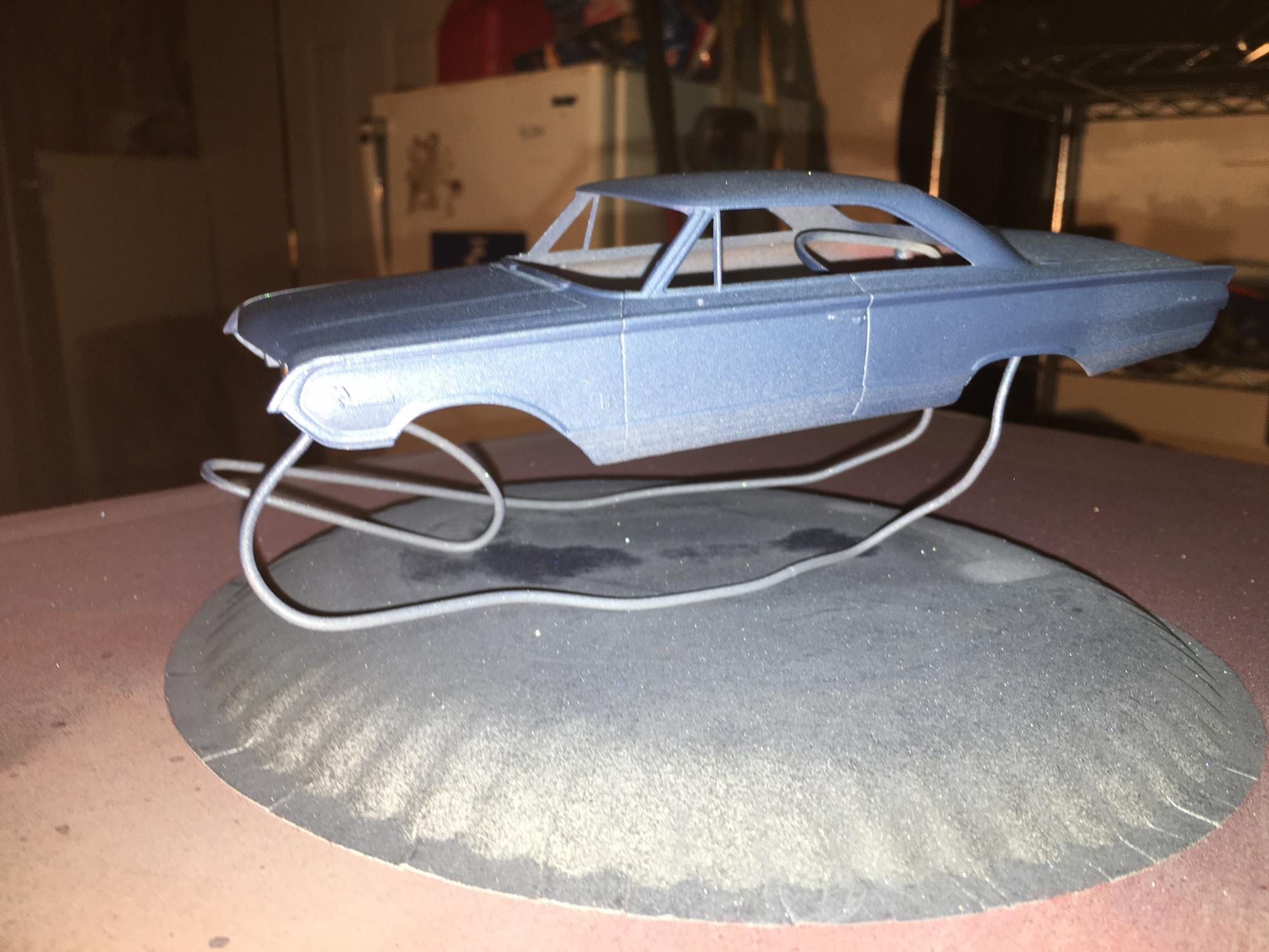

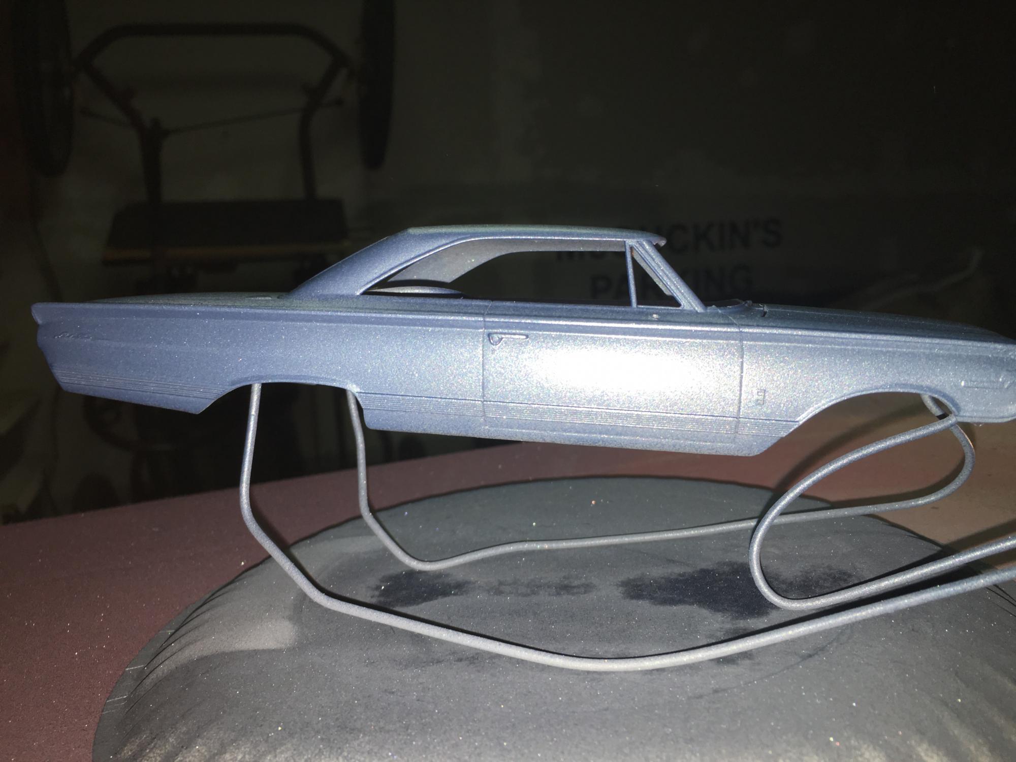

Againmikewins Posted November 4, 2015 Author Posted November 4, 2015 Well, I've got the first coat down! I went with Duplicolor Light Blue metallic, it looks pretty close to the '64 Mercury factory Glacier Blue and Tiffany Blue. I've got three projects that I've been working on and I'm happiest with this one. I'm wondering if this is too heavy for a "mist" coat?

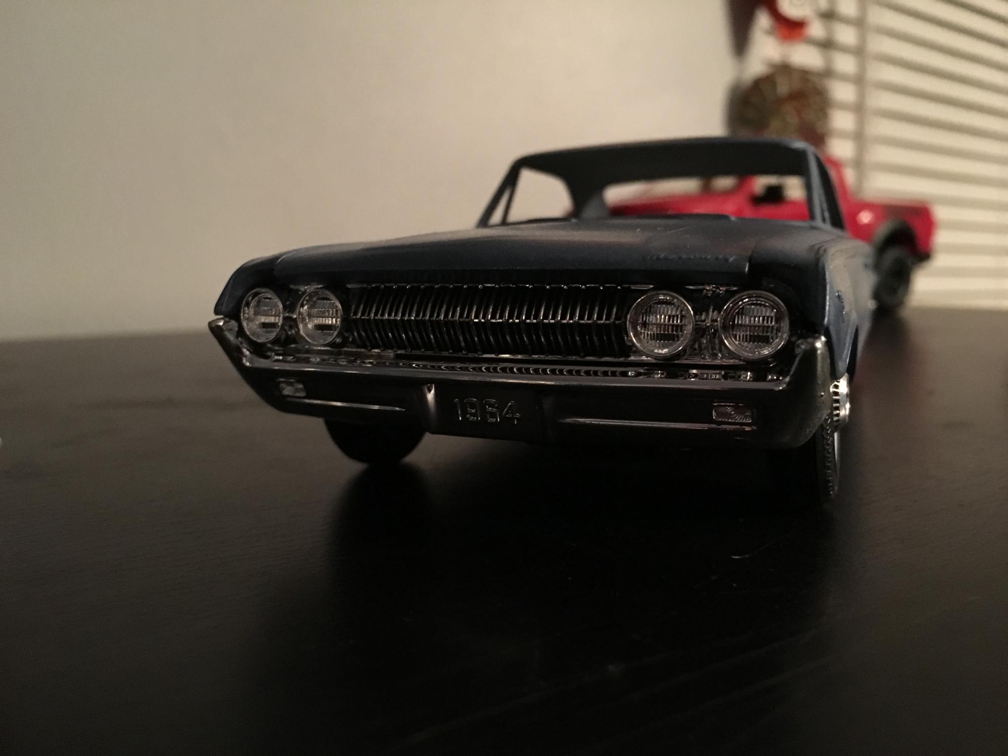

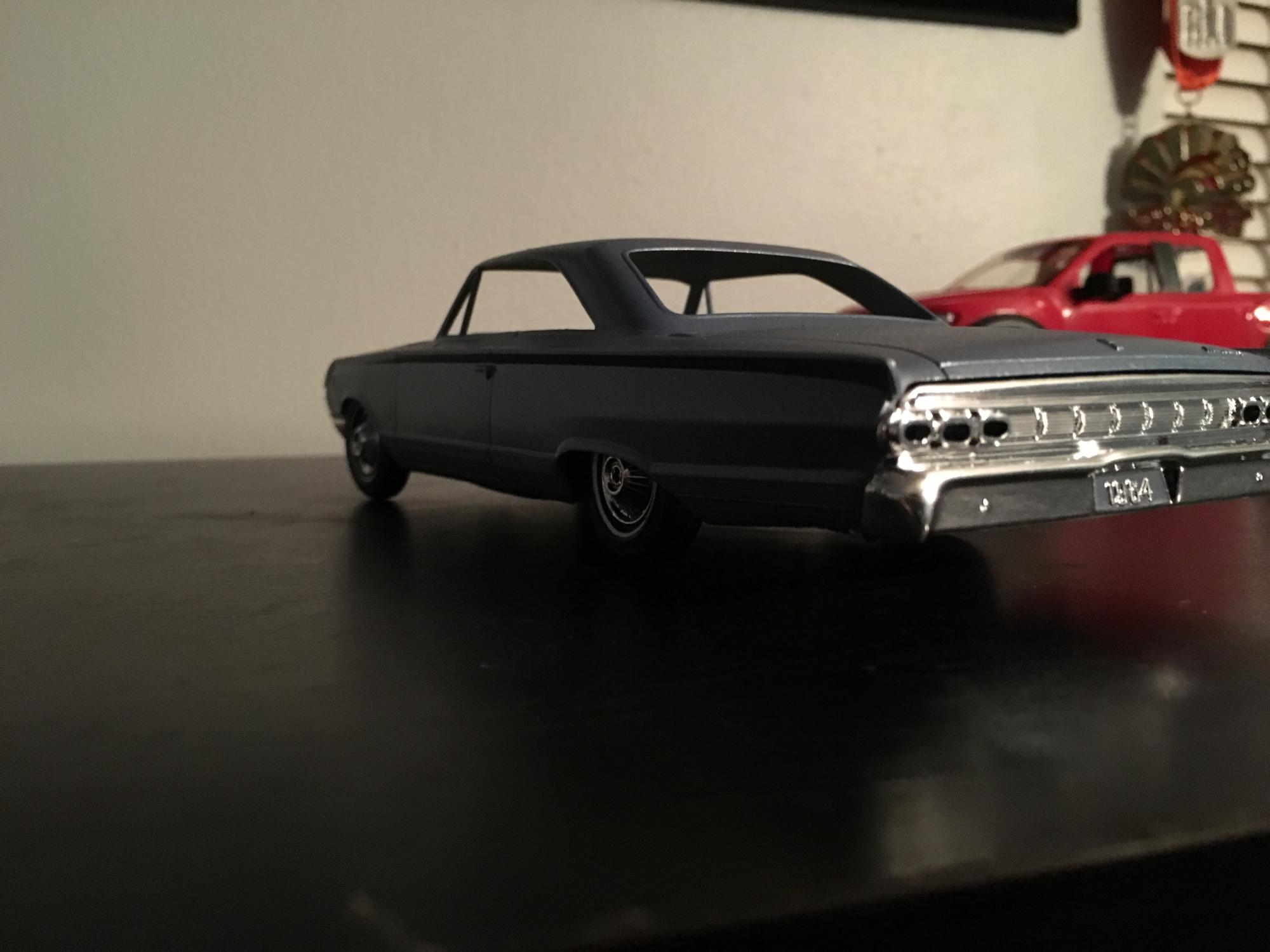

Againmikewins Posted November 5, 2015 Author Posted November 5, 2015 Did a mock up on her tonight! She's looking mighty mean!
StevenGuthmiller Posted November 5, 2015 Posted November 5, 2015 Looking good Michael!Looks like you got the color on nicely.Now I would just avoid sanding the color coats & go directly to your clear coats.After a few coats of clear, you can polish out any orange peel then. Steve
