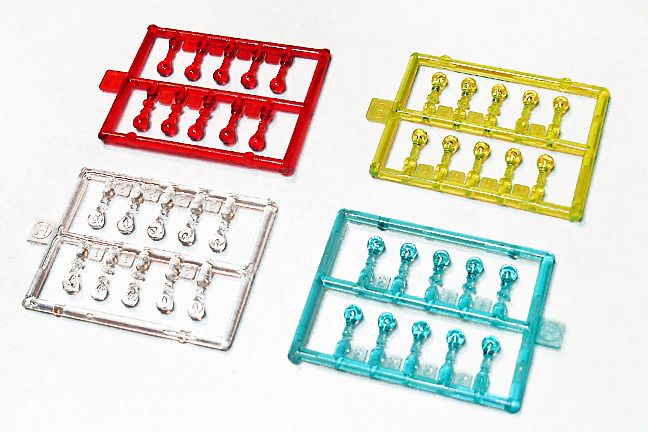

This particular kit represents a 1919 Garrett named the "Pendle Princess," which was one of many tractors in a private collection. This one has the front-mounted generator, a lot of fancy pinstriping and polished brass, and even multi-colored light bulbs all along the edges of the roof… it was all gussied up  to be used as a portable source of electricity at a fair, carnival, etc. and not as a "work" tractor.
I want to build this as a more typical road-going, working machine, which means no colored lights, no front-mounted generator, etc. I'll "de-bling" it, scratchbuild a shorter roof without the fancy brass roof brackets, and generally tone things down a bit overall. My goal is a tractor that looks less like the box art and more like this one:

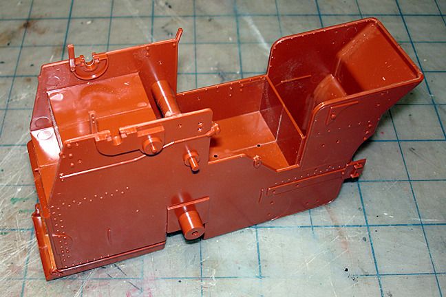

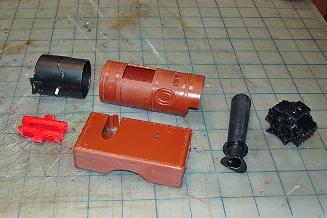

Whenever I build a model, the first thing I do is locate all of the components that are molded as left-right or top-bottom halves and pre-assemble them. Same with any other subassemblies that are multi-piece but represent a single piece on the real thing, or that will be painted all one color on the finished model. Liquid glue, then sand the seams smooth so that they disappear...
The main body also gets pre-assembled... it is molded as a left-right half with a separate rear panel. It all gets glued up first, then will be painted and detailed as a unit...

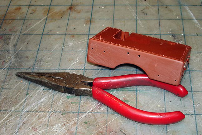

The kit represents a fancied-up version of a steam tractor, with that forward-mounted generator. My model will be a working tractor, no generator... so the mounting platform for the generator won't be used. I filled in the holes in the front part of the boiler where the side plates of the generator platform would go by jamming a short length of styrene rod into the holes and then flowing liquid cement around the rod. i will only fill the rear holes... I'll keep the front holes open and install a set of parts box headlights there later...

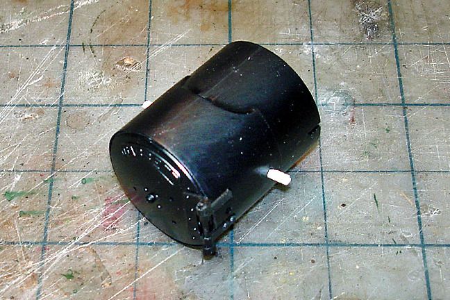

There were some molded-in water lines on the main boiler and water tank. I will be replacing those molded-in lines with actual 3 dimensional lines made of brass rod... so all the molded-in details were sanded off. This is the water tank...
If anyone out there has a use for 40 1/16 scale multi-colored (and very realistic) light bulbs, let me know. I won't be needing them... :D
