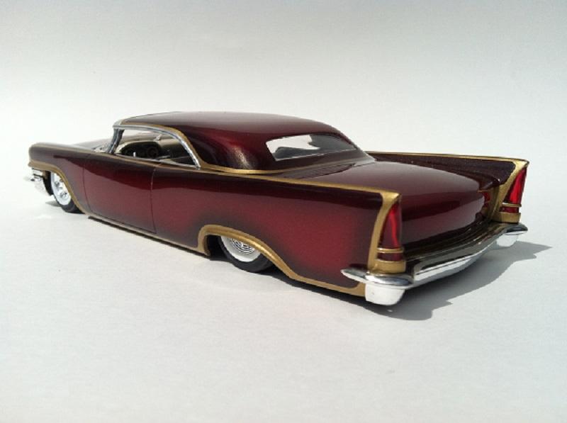

Ferbz Posted October 30, 2015 Posted October 30, 2015 Hey gang, Years ago, I was airbrushing nail polish paintjobs thinning them with Dupont automotive nitrocellulose lacquer thinner(since the nail polish I was using was nitrocellulose lacquer)with great results. I was also conveniently spraying my basecoats and clearcoats with nitrocellulose lacquer based Plastikote automotive spray cans, but I've discovered that neither nitro lacquer thinner nor Plastikote nitro lacquer are available these days. I had the idea of switching to acrylic lacquer based paints since automotive paint supply stores DO carry acrylic lacquer thinners, and acrylic lacquer based Duplicolor automotive spray cans are available, but I don't know which brands of nail polish, if any, are acrylic lacquer based. Anybody out there have this info? Thanks in advance! Here is an example of a nitro lacquer paintjob I did. The gold base, candy red, and final clearcoat was Plastikote spray cans, while the black fogging and gold pearl clear was nail polish.
