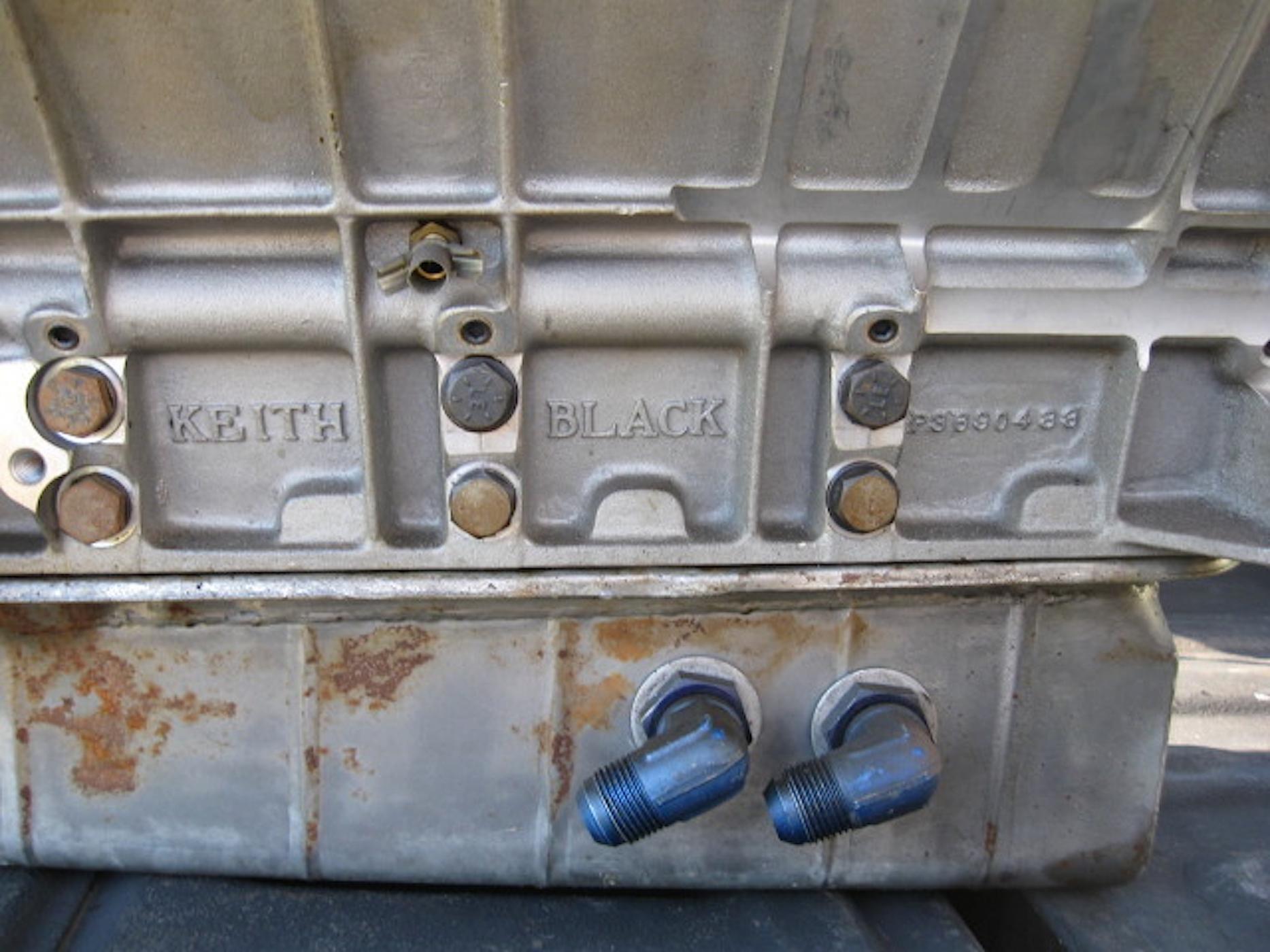

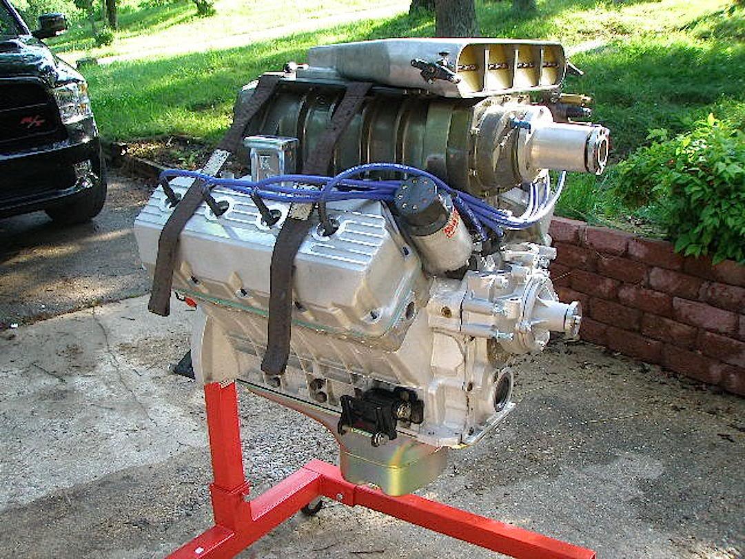

69NovaYenko Posted November 10, 2015 Author Posted November 10, 2015 (edited) MuncieAfter reading your comment I decided to look into when Keith Black started casting aluminum 426 Hemi blocks. This is what I uncovered:"Keith moved the operation to its current location in South Gate, allowing expansion of the machine-shop and a more suitable area for stocking parts. He introduced his aluminum version of Chrysler's 426 Hemi in 1974. This was the fuel category's "bread-and-butter" engine for the better part of the next decade."http://www.keithblack.com/history.html Edited November 10, 2015 by 69NovaYenko
Muncie Posted November 10, 2015 Posted November 10, 2015 great reference pictures - seldom get to see the block like that outside of a carthank you for researching the date - it's good to have it defined, sorry I left it so fuzzy. If you are building late 60's, early 70's, most of the fuel racers left the iron block bare - didn't have to mess with hot tanking the block to remove the paint when it had to go back to the machine shop for repair work. Hot tanking damages the cam bearings so the unpainted block saved removing and installing new cam bearings - critical to minimize machine shop time and expense between races for most weekend warriorsOK, back to the original paint question...
