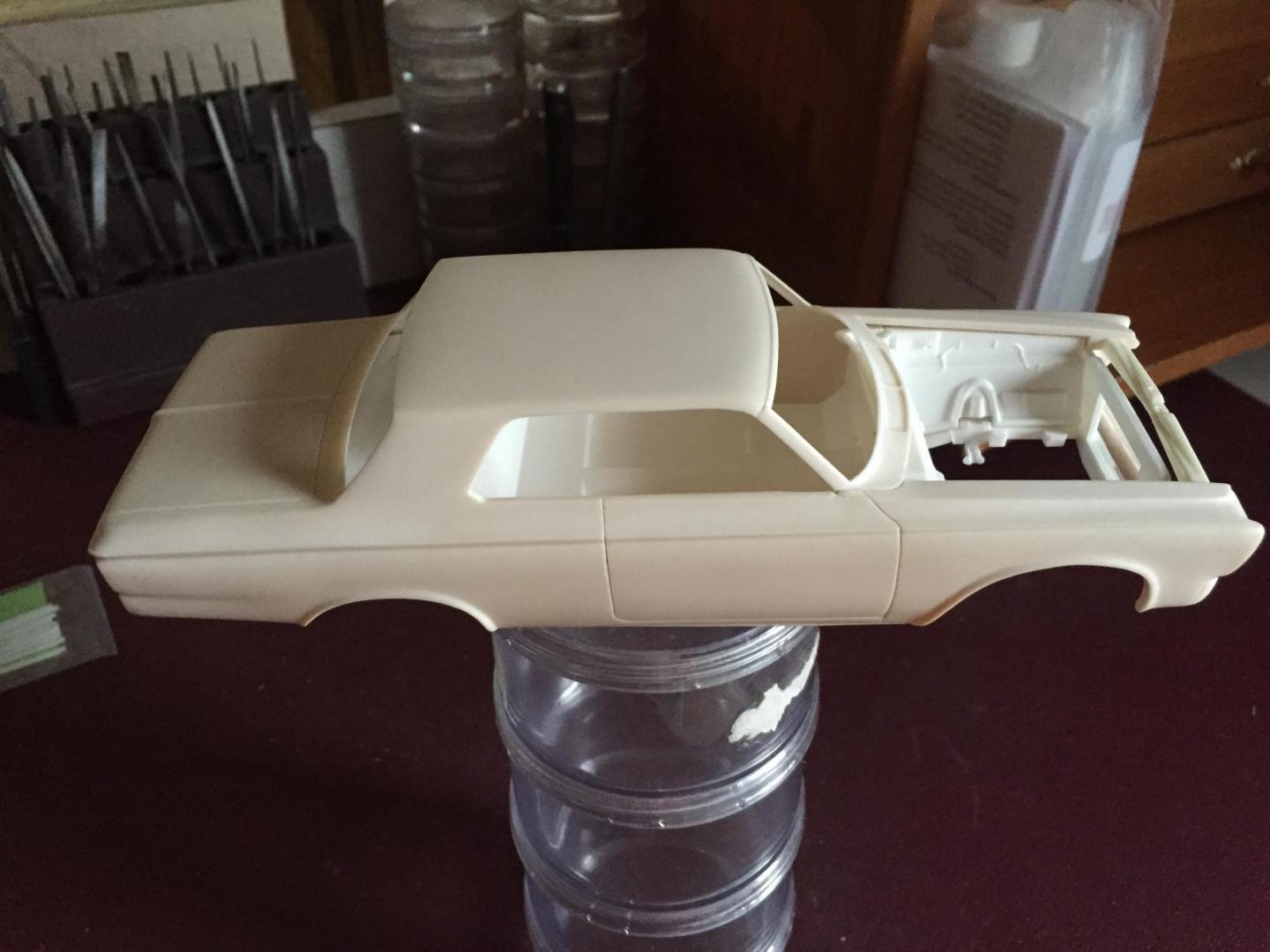

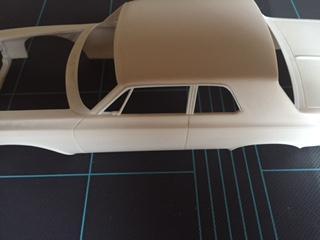

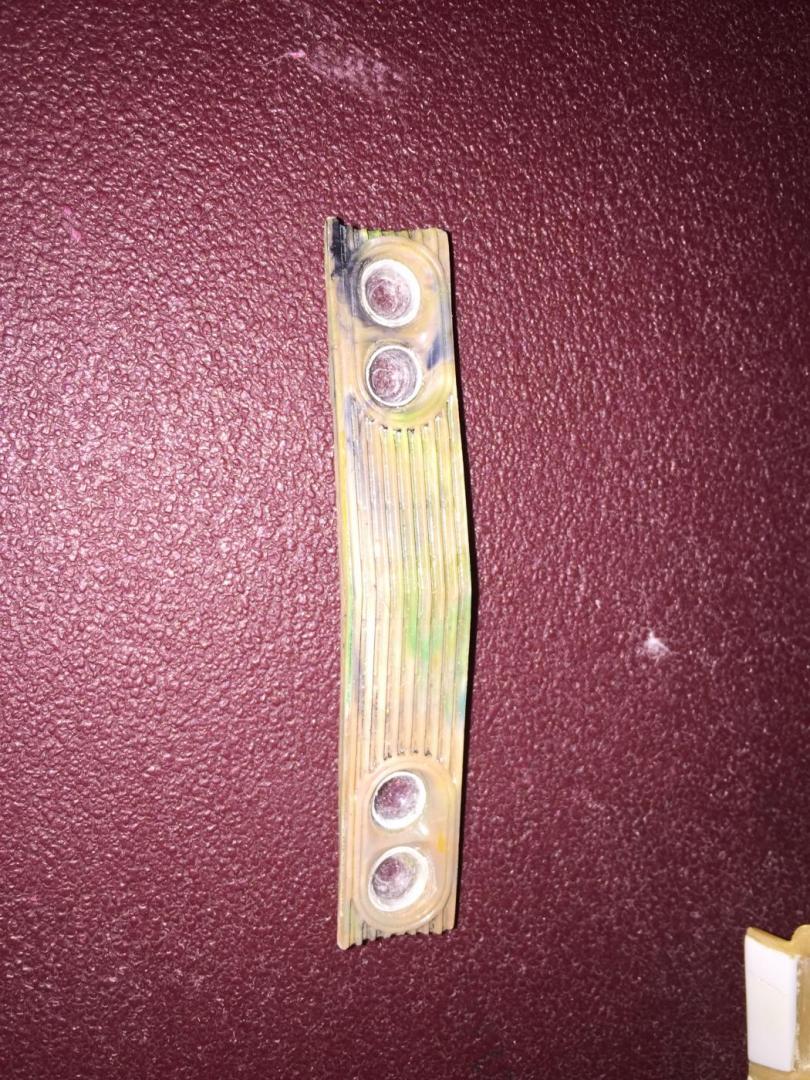

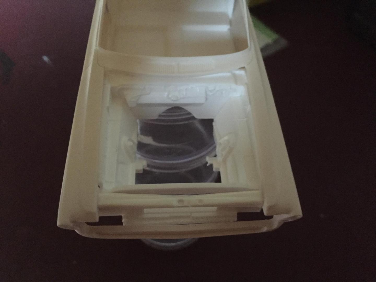

BobbyG Posted December 7, 2015 Posted December 7, 2015 This is my first post on the forum so please bear with me. Shaking the dust off a project started a couple years and now determined to finish it. Started with JoHan's 63 Fury, stripped all trim to make it a Belvedere. Took the rear panel from a JoHan 64 Plymouth and separated the tail lights, bucketed the grill for headlights. the chassis and interior is from Lindberg's 46 Dodge, and engine from a Revell 69 Charger with my own modified cross ram manifold that I cast in resin for accuracy. Adding the sedan post and door panels to be scribed with Belvedere trim and making everything fit right. need to make a bumper filler for the front and cast the parking lights in clear resin. I made a master for the dog dish hubcaps from an old wheel cover, casted them in resin and had them chromed. I hope to get as much done over the holidays and ready for paint. Paint is Med Met Blue with a multi-tone blue interior. Thinking of a white painted roof, maybe. This is a Mopar that has had a lasting impression from when I first got my driver's license. Also on the bench is a JoHan 62 Dodge Dart Super Stock that will be a match for the Belvedere. Thanks for looking.

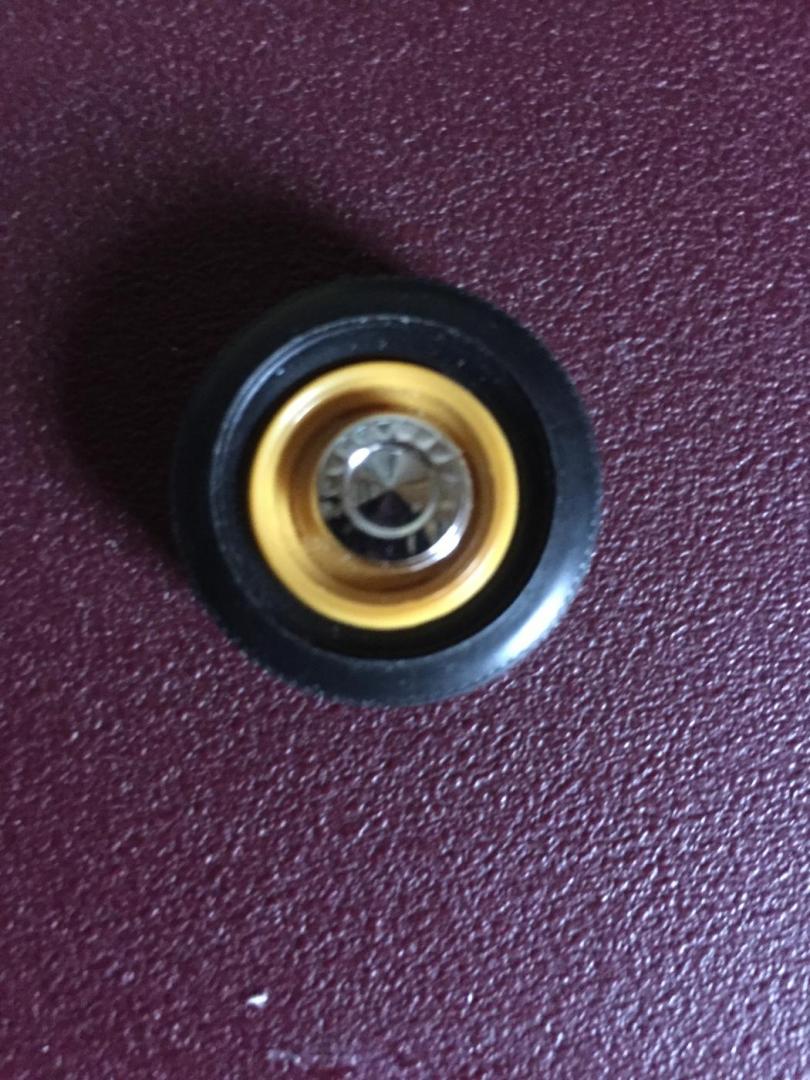

tubbs Posted December 7, 2015 Posted December 7, 2015 (edited) Thanks Niko. In 1963 the Max Wedge (RB) block engines were 426 cu in, Ramcharger for Dodge and Super Stock for Plymouth. Although from my knowledge the 413 Cu In was still offered in 63 for certain models. Of course these were the same engines. This will be a Stage II Maw Wedge with 2, 4 bbl carbs on a cross ram manifold with ram exhaust manifolds.Beautiful job so far. really like what you are doing. the back panel is great. Bobby G is correct. in 63 the max wedge had 426 cubic inches. the 62 you are building, will be a 413.I am a huge fan of these cars and will be watching. 2 questions, where did the dog dish caps come from (was it the lindburg 64 dodge?) and can you get a clearer picture on the dash and what you did? I know the dash in the johan kit isn't the best.keep up the great work Edited December 7, 2015 by tubbs

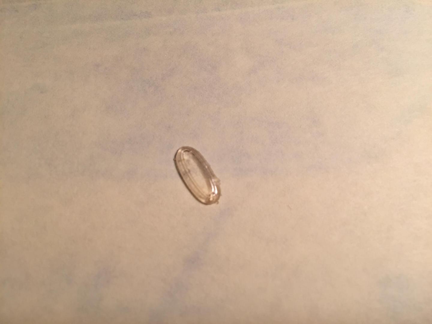

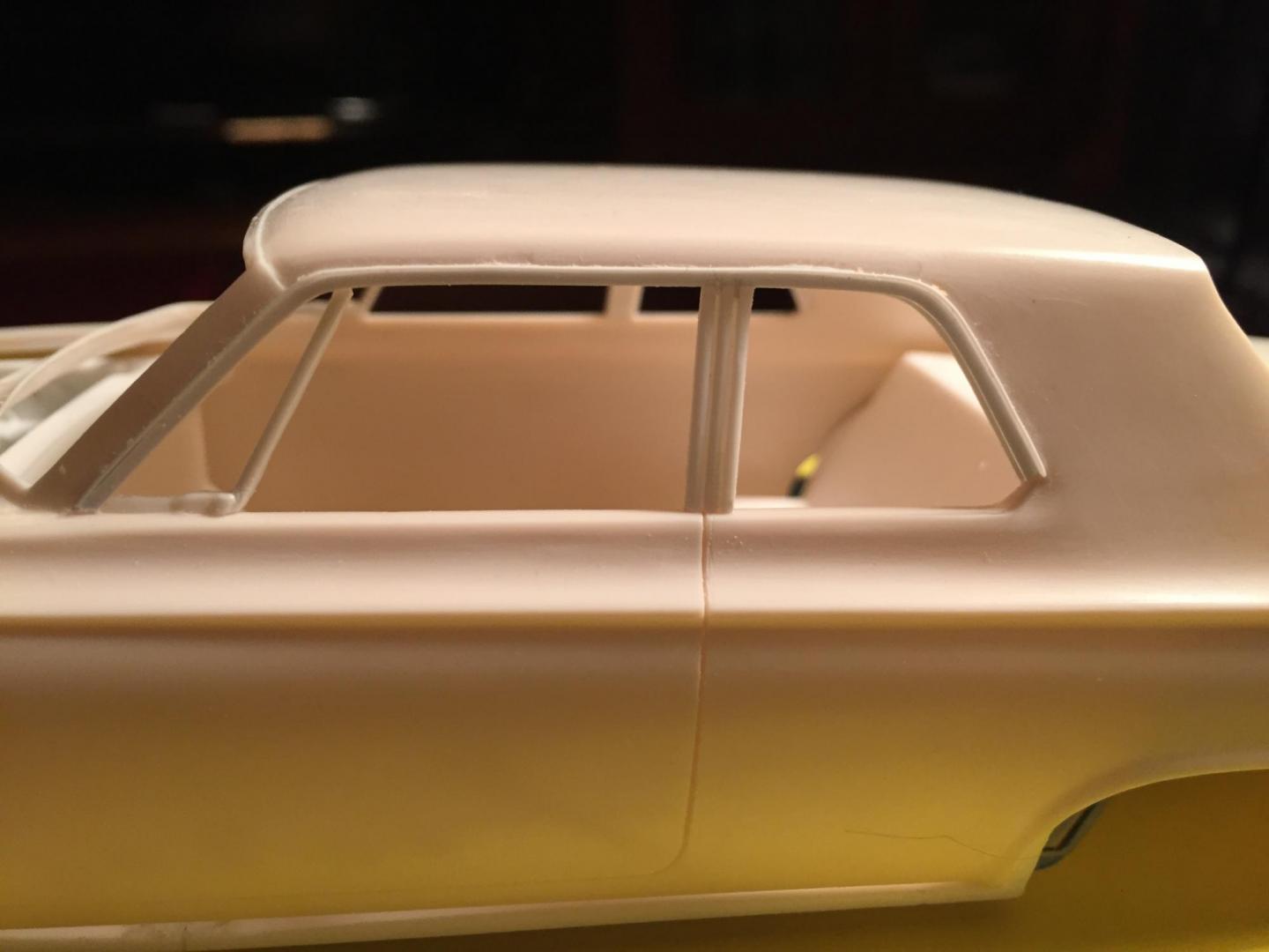

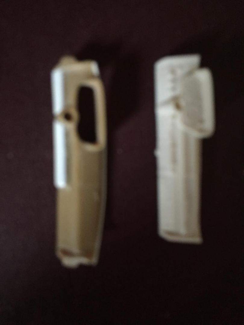

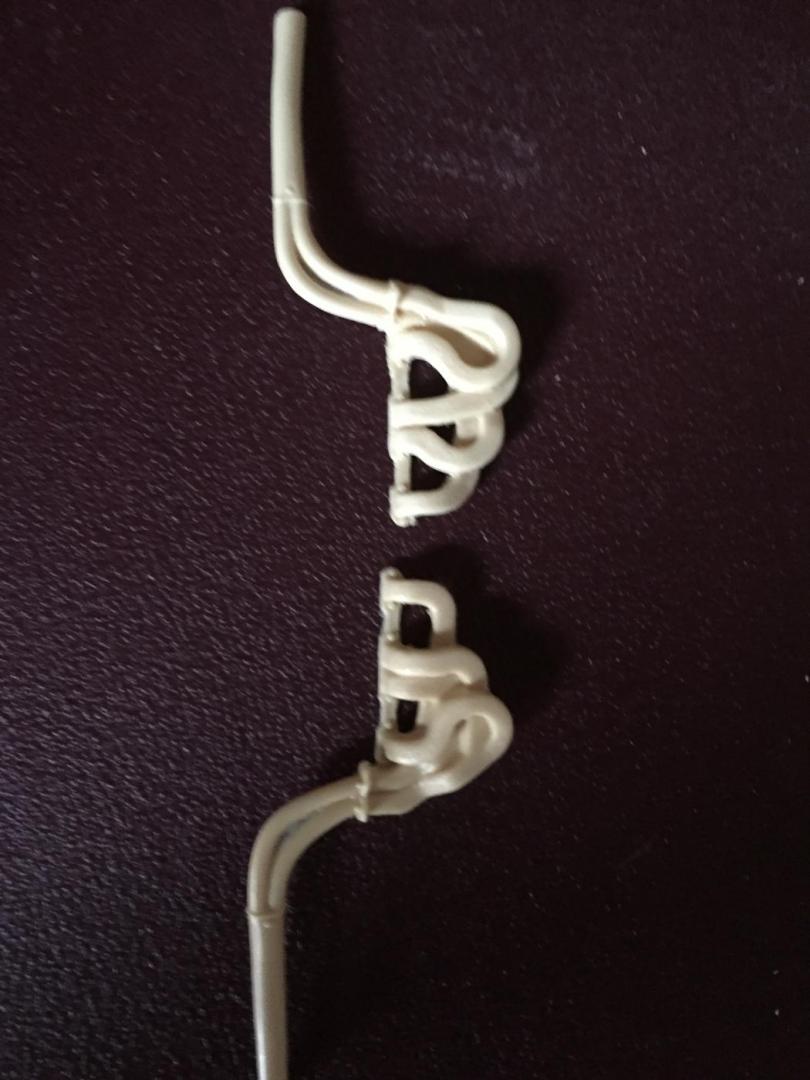

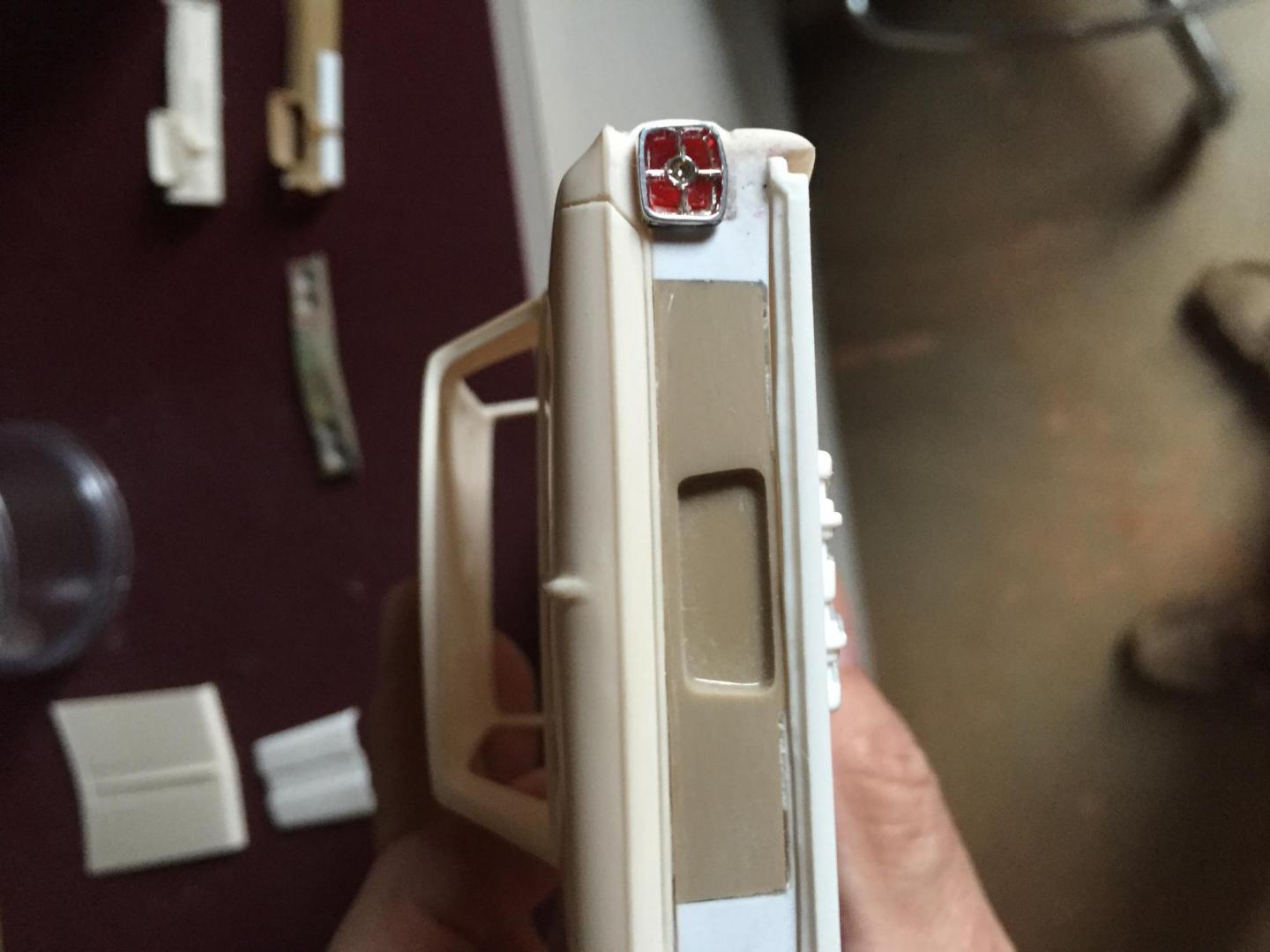

BobbyG Posted December 8, 2015 Author Posted December 8, 2015 Thanks Al. The hub caps are resin, I forgot where I got them. I originally made my own out of the kit's wheel covers, cut and shaped around the center and came out OK but then found these. I may make a mold and cast another set for the 62 Dodge since they are similar. The dashboard has been filed and shaped for the base steel version with radio delete panel but needs to be finished. The gauge panel will be separate adding details and gauge decals (made from photos of the 1:1). Here are some additional pics, I was able to add the sedan post over the weekend, came out pretty good. I cast the parking light lens in clear and carved out the backup lights and tag bezel from the Fury tail panel.

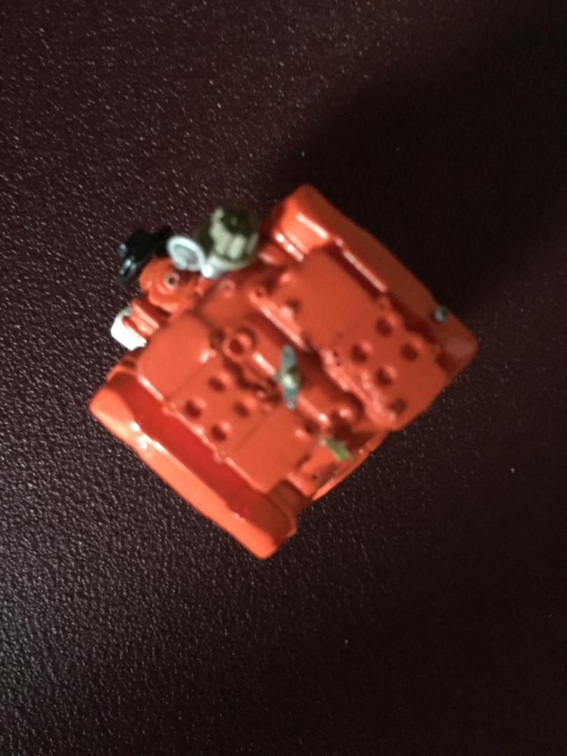

showrods Posted December 8, 2015 Posted December 8, 2015 What brand and colour name is the paint on the engine block? Looks good.
BobbyG Posted December 8, 2015 Author Posted December 8, 2015 Hey Peter, I painted the engine a couple years ago, it's a mix of Tamiya paints.

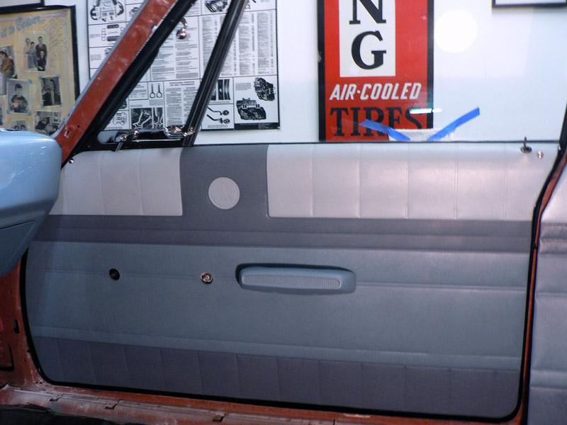

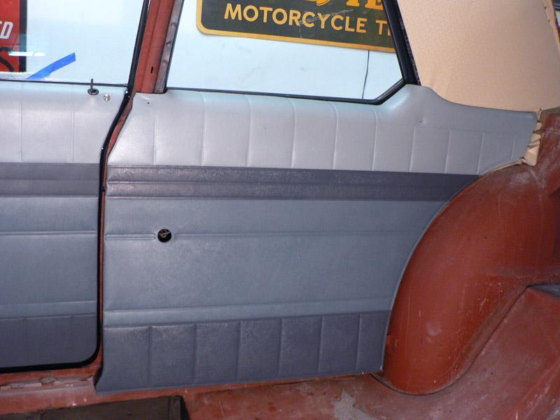

BobbyG Posted December 8, 2015 Author Posted December 8, 2015 You are doing masterful work....Very nice job on what you've done so far..The Belvedere model had a strip of straight chome on the sides..The model without the chrome is the Savoy which took the place of the low line Plaza of earlier years..Keep it going, this is going to be a killer car... Wayne Thanks for your comment. You are correct, I may add the side trim or just leave it as a Savoy which will determine the door panel trim as well. Thanks. Here's the dash and trim I am shooting for along with a pic of the Savoy.

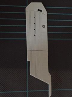

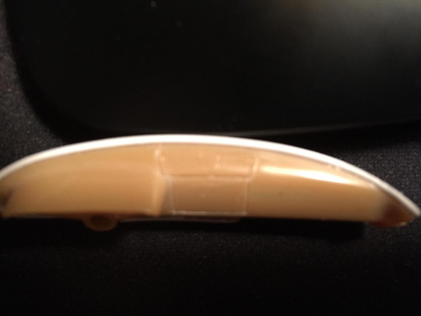

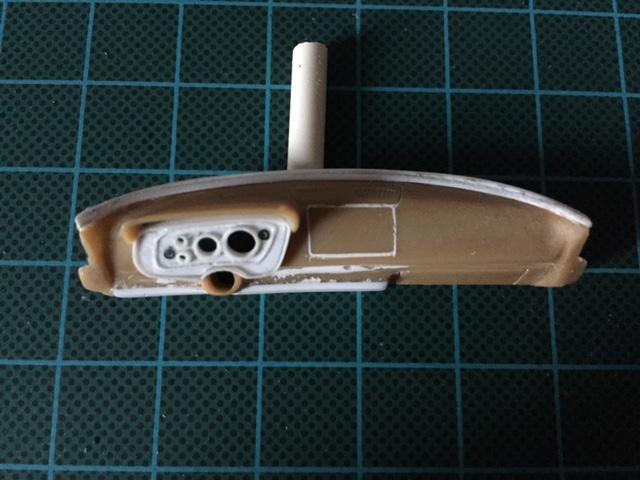

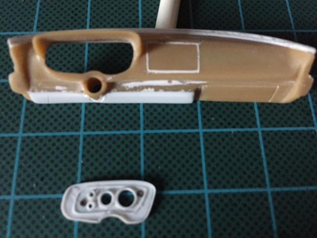

BobbyG Posted December 10, 2015 Author Posted December 10, 2015 (edited) Got a little bit done on the dash and gauge panel. I have to find someone who will photo etch the speaker grill and gauge panel. Not sure if I like how the gauge panel came out, it will look much better once detail painted and gauges are in. Need to add push buttons on the panel. Thanks Edited December 10, 2015 by BobbyG

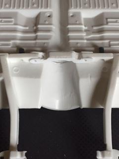

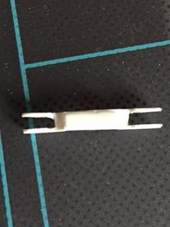

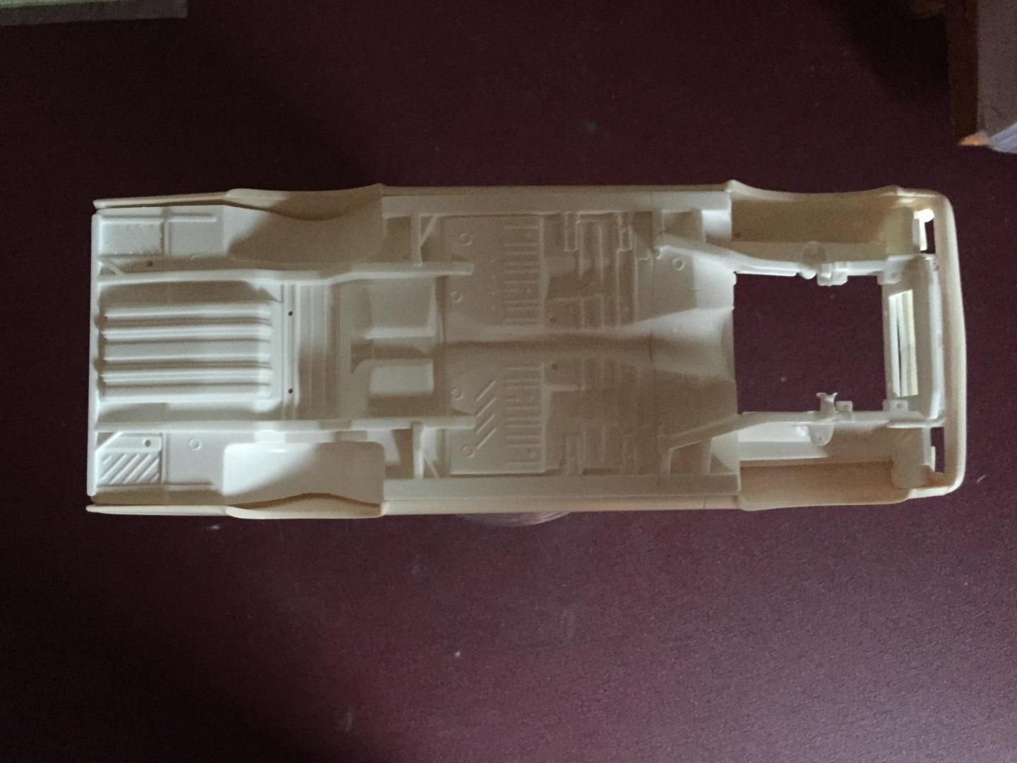

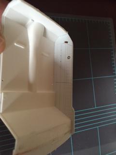

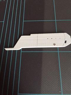

BobbyG Posted December 15, 2015 Author Posted December 15, 2015 (edited) Did some work over the weekend, door panels and separate transmission mount on the chassis. Thanks for your comments. Edited December 15, 2015 by BobbyG
