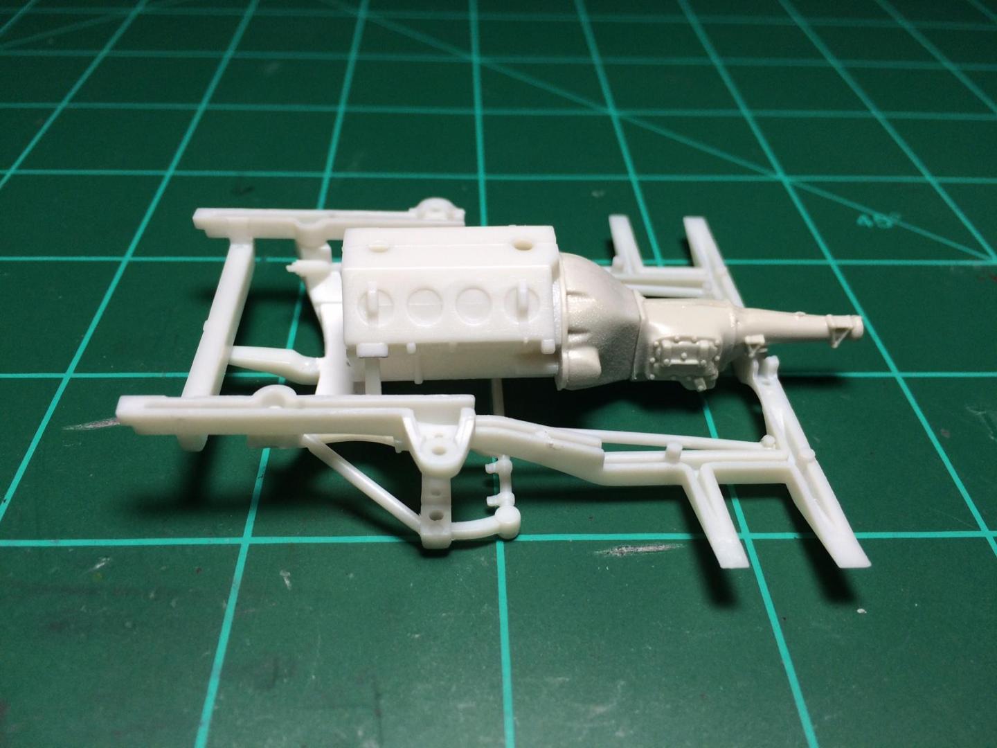

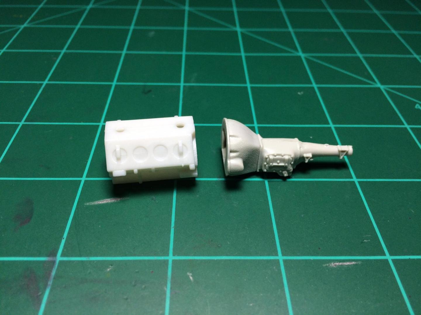

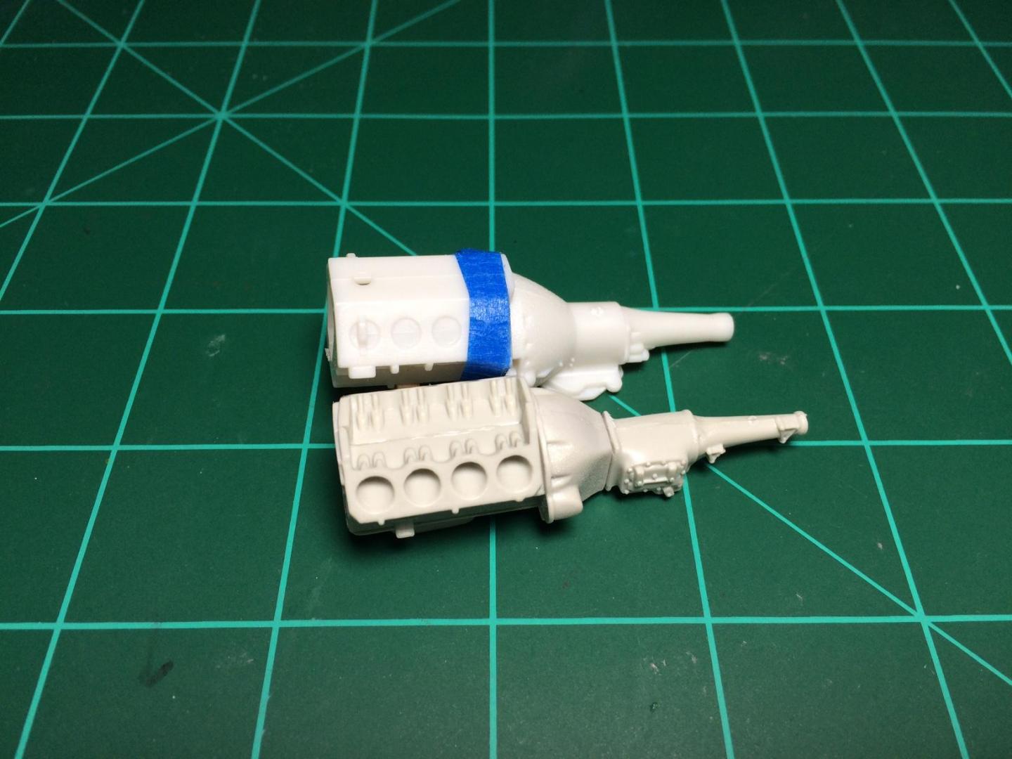

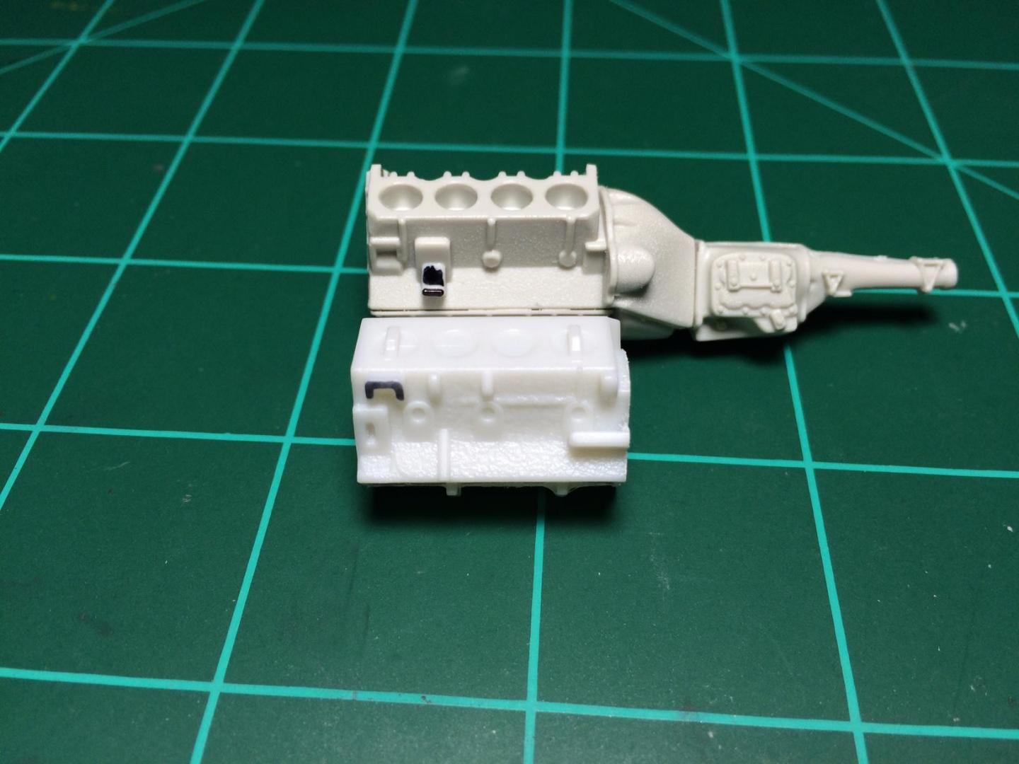

Greg Pugh Posted December 11, 2015 Author Share Posted December 11, 2015 My original intention was to use the complete engine and transmission from the Super Bee but...that changed. I decided that I will be using the engine from the Satellite and mate it to the bell housing/transmission from the Super Bee. The first picture is of the two engines side by side for comparison when I was mocking it up. The second pic was after I already changed my mind but forgot to snap a pic, you can see the Torqueflite has been removed already. Also in that second pic, you can see what prompted this decision. If you'll notice where I marked with Sharpie, the motor's mounting point is too far back and too low on the Super Bee, and it's too high and just a bit too far forward on the Satellite. Once the motor is installed and the exhaust manifolds are installed, you won't see this anyways so instead of correcting the motor mounts, I chose the lesser of the two evils. As some of you know, the RB engine series (383, 413, 426 wedge, and 440) all share the same block. The Satellite kit came with a 426 Wedge and the Super Bee kit came with a 440. AMT and Moebius both did their homework here too as both blocks are identical in size. So much so in fact, that I'll be able to use the short block from the Satellite and still put the top end and all of the 6-pack stuff right on top of it and no one will ever know! Mwahahahahahahahahaha! Quote Link to comment Share on other sites More sharing options...

dodgefever Posted December 12, 2015 Share Posted December 12, 2015 My original intention was to use the complete engine and transmission from the Super Bee but...that changed. I decided that I will be using the engine from the Satellite and mate it to the bell housing/transmission from the Super Bee. The first picture is of the two engines side by side for comparison when I was mocking it up. The second pic was after I already changed my mind but forgot to snap a pic, you can see the Torqueflite has been removed already. Also in that second pic, you can see what prompted this decision. If you'll notice where I marked with Sharpie, the motor's mounting point is too far back and too low on the Super Bee, and it's too high and just a bit too far forward on the Satellite.Neither is exactly right; the driver's side mount should be around the same height as on the Moebius block, but rearward of the oil pump. The AMT block looks more correct in terms of the chamfers on the corners, but easy to fix on the Moebius. Good job on the K member. Looking forward to seeing this progress. Quote Link to comment Share on other sites More sharing options...

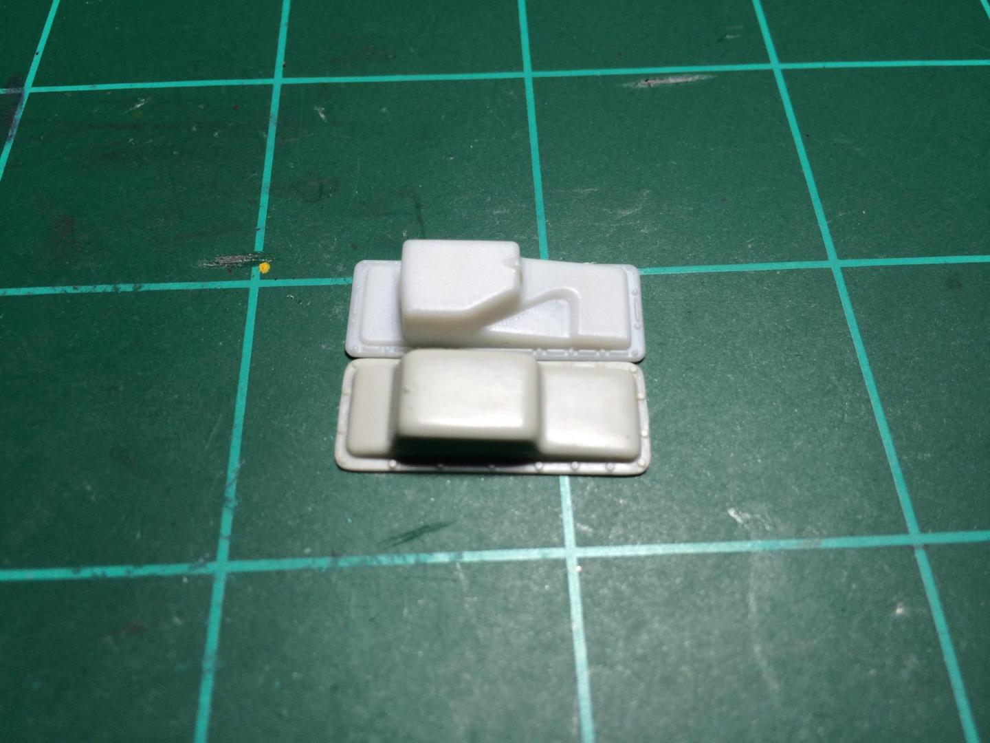

Greg Pugh Posted December 15, 2015 Author Share Posted December 15, 2015 Something else for those building this kit, especially those wanting to build an accurate stock car, I discovered that the oil pan is wrong. The oil pan in the kit is correct for a C body car with a big block. In the picture below, the oil pan on the top is the Moebius Satellite piece, while the lower one is from AMT's Super Bee. Reference: http://www.440source.com/oilpans.htm    Quote Link to comment Share on other sites More sharing options...
