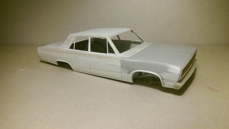

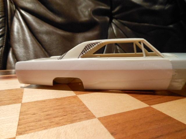

Stuntman Mike Posted December 15, 2015 Posted December 15, 2015 (edited) Hey dudes I´ve started posting pics of this build in the WIP of my Duel truck and since it has caught quite some attention, I thought it´d be better to post it here instead of spamming a truck WIP with car stuff. Some information on this conversion can be found here: The Duel Project. Everything else will be posted in here from now. I´ve also found a few more pics of the earlier stages of this build. As mentioned in the other thread, this Valiant will be made from a Dart body that was mated with a Duster front end. While the Dart body is totally inappropriate to resemble a Valiant, it´s still a useful foundation for extensive bodywork. It actually helps a lot to have more than a chassis plate and two fenders with a hood to work with. I could already write a book about what has been done yet. But I´ll just add some minor information to the picture as the whole process is kinda self explanatory. If questions come up, don´t hesitate to ask and in case you find major inaccuracies, sport a pointer and provide some helpful critics, please. I don´t care when this will be finished. If I need to change something, I´ll gladly do it for the sake of self-flaggeration and accuracy... Well then...here´s all the pics I could find on my hard drive. I´ve marked what needed to be removed from the Dart´s c-pillars The trailing edge of the hood needed just some minor trimming to fit to the contours of the "thing" (whatever it is called...) between the hood and the windscreen. This is how the engine bay looks after the Duster´s and Dart´s parts were mated. After the body pieces were mated, this view made my toenails fold up. This was when I realized that I loaded myself with tons of work. This was when someone made me realize that the roof height was incorrect for a sedan. It looked kinda weird, just like a top chop. The roof was then cut off of the body and the roof height was adjusted. It also forced me to completely re-do the side window trim that I already did earlier. After the anti-top-chop was done, I´ve had an extremely fragile body to work with. The side window trim brings back a lot of the strength. I simply glued a full sheet of styrene into the hole and drew the trim with a pencil onto the sheet. Then I cut the windows out with an x-acto knife. The result is a lot stronger than just some posts out of strip styrene. And as a benefit there´s no messing around with alignment. There´s now a nice even surface for adding clear sheet for the windows. And that´s where I´m at right now. Still lots of unpredictable work. I´m actually curious which stick will be thrown between my legs next. I´m sure the Valiant has already planned something to make me curse the day I was born... As mentioned, critics are very welcome and most appreciated. Maybe I can get this body good enough to be casted in resin. But be patient, I´m not rushing this and slow progress is to be expected. Cheers Kevin Edited December 15, 2015 by Stuntman Mike

Stuntman Mike Posted December 16, 2015 Author Posted December 16, 2015 Hey! Thanks for all the nice comments and for the links guys. It´s motivating and made me go on with the bodywork. A strip of triangle styrene was glued to the vertical surface of the trunk lid. This will help me to bring this area into shape. The sheet below is just flat and follows the shape of the rear bumper. But there has to be an edge in the panel and this is where the triangular styrene strip comes into play. In 1:1 it´s a very subtle and barely noticable line, but it´s tricky to duplicate in scale. I added a layer of putty after the strip was glued to the body. It looks kinda sloppy, but now there´s enough meat to sand this area into shape. When I´ll be done with sanding, the egde in the panel will be solid styrene instead of putty. It also will help during the sanding process as I can better see what I´m actually doing while approaching the desired result. Just gotta let this cure before I´ll start sanding. As you can see, I tend to work rather careful with putty to reduce the sanding process to a minimum. It also helps to keep the surrounding surfaces clean and unharmed. I have a ´72 Nova from AMT in progress that I´m turning into a Yenko Deuce. This kit has horrible side window trim and I´m redoing it with the same technique that I used on the Valiant. The refurbishment will include the drip rail trim aswell. It´s just a little work, but fairly easy and manageable by pretty much anyone who has already worked with sheet. I think I´m going to make a tutorial as there are a lot of kits out there that need a little improvement in this area. Cheers Kevin

MrObsessive Posted December 18, 2015 Posted December 18, 2015 The trailing edge of the hood needed just some minor trimming to fit to the contours of the "thing" (whatever it is called...) between the hood and the windscreen. This is how the engine bay looks after the Duster´s and Dart´s parts were mated. Still lots of unpredictable work. I´m actually curious which stick will be thrown between my legs next. I´m sure the Valiant has already planned something to make me curse the day I was born... As mentioned, critics are very welcome and most appreciated. Maybe I can get this body good enough to be casted in resin. But be patient, I´m not rushing this and slow progress is to be expected. Cheers Kevin Kevin, as I mentioned in your other thread, this is super excellent work you're doing! I quoted your pics as you've done an excellent job so far in trying to mate up bodies of disparate proportions. I know that type of work all too well, as I'm a big fan of "if something's not quite right, fix it as best you can!" BTW, the panel between the hood and the windshield is the "cowl". And yes, DON'T rush this one! I know what you're making can be quite tedious, and certainly takes time! You're doing a kit in itself with all of the bodywork (I talked about this in another thread), so I look at it as just as much work as putting an entire kit together! Thanks for keeping us posted, and as I mentioned before, I'm definitely following along!

Stuntman Mike Posted December 23, 2015 Author Posted December 23, 2015 (edited) Best things come in threes.... I´m doing the side window trim for the third time. I realized the b-pillar was too narrow and while I´m at it I´ve also improved the top of the door panels. I have also started work on the c-pillars by sanding my way into it to bring it into shape. I think the correction of the rear window will be less work than anticipated. I´m also building with more reference now to avoid such no-brainer mistakes like the too narrow pillars. I´m actually starting to count rivets. I also think that the rear end of the body may be a little bit too long. Looks like it could be five millimeters shorter. What do you guys think? Does anyone of you actually own a 4-door Valiant? It would be awesome to get some measurements of different parts of the body. This is how the chassis plate of AMT´s ´71 Duster fits into the body. I just needed to do some minor trimming behind the rear inner fenders. It´s almost a drop-in. And this is the result on the trunk lid after a few minutes of sanding. That´s it for now. Next update will probably cover further work on the new pillar situation. Wish you all a great christmas and at least one new kit. Cheers Kevin Edited December 23, 2015 by Stuntman Mike
