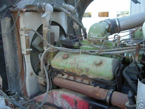

vincen47 Posted December 29, 2015 Posted December 29, 2015 For anyone else who is interested in a v12, Moluminum has one on the website now.

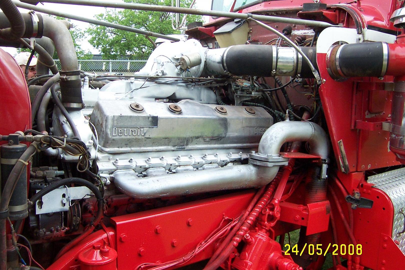

Old Albion Posted December 29, 2015 Posted December 29, 2015 Jeff,Your comment about the KW chassis being to narrow for the 8V Detroit is an interesting one. I'm sure that's why on the 1:1 Kenworth trucks the exhaust manifolds on 12V71s are turned upwards, because the frame is to narrow for the manifolds to point downwards.

Old Albion Posted December 30, 2015 Posted December 30, 2015 I think the engine in the Super Boss KW is a marine version and a 12V71TTA (Twin Turbocharged and After-cooled). I bought some old Hendrix resin cast ones a few years ago and put one in an Autocar and still have 2 left for possible future projects. On an 8V71 the exhaust manifolds should be above the frame rails and point towards the rear of the truck. With a 12V71 as stated the manifolds turn upwards with the outlet at the rear of the engine. There is a special "U" shaped pipe that bolts to the manifold and converts the exhaust to point downwards. Hope this makes sense.
lapazleo Posted December 30, 2015 Posted December 30, 2015 Actually the upturned manifold and u shape was to clear the steering shaft. If you notice the 8v71 and 12v71 are the same width. 12v71 manifolds exit to the rear like the 8v71 normally. It depended on the truck they were in.
