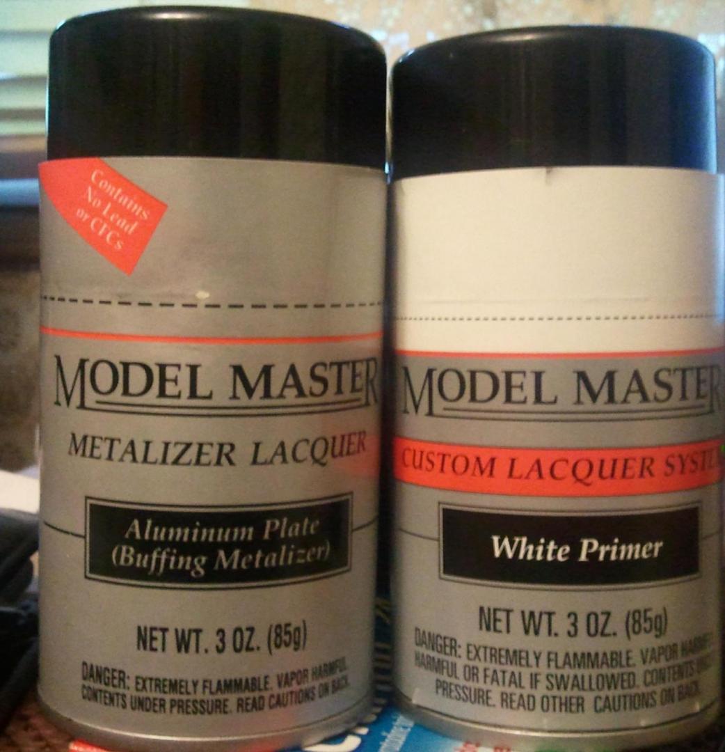

Hello, Finally made it out to the local hobby shop today to purchase a bunch of primer, spray enamels and little jars to begin building again for the first time since 98 when I was 16. Noticed when I got home that two of the sprays that I bought (1 primer and 1 aluminum) have lacquer in the label. All but these 2 are spray enamels. Just wanted to see if I can use these on my NASCAR models. Have been a fan for years and accumulated a bunch of kits to build. Just wanted to ask the knowledgeable builders with experience on this board before I try and use one and ruin the model or melt the plastic. Thank you for your help.
Thanks
Joe
You can put enamel over lacquer, but not the other way around.  Test the primer on spare trees first, it may or may not craze the bare styrene.

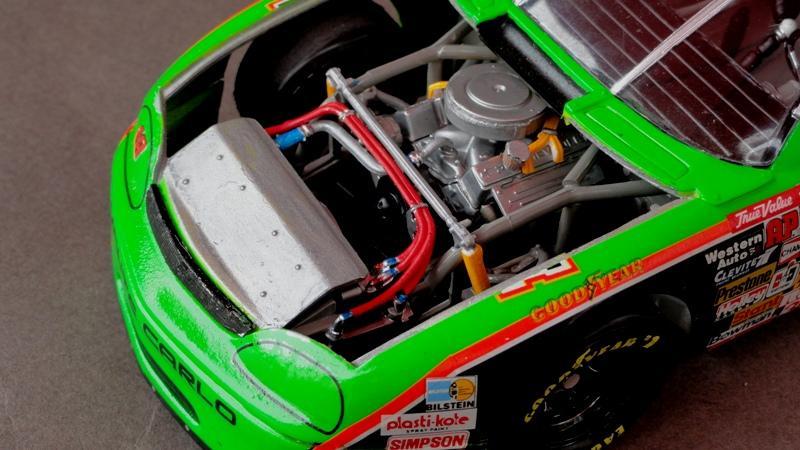

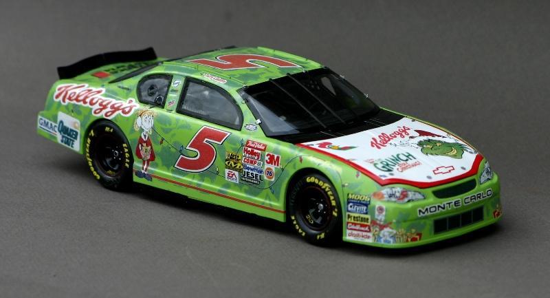

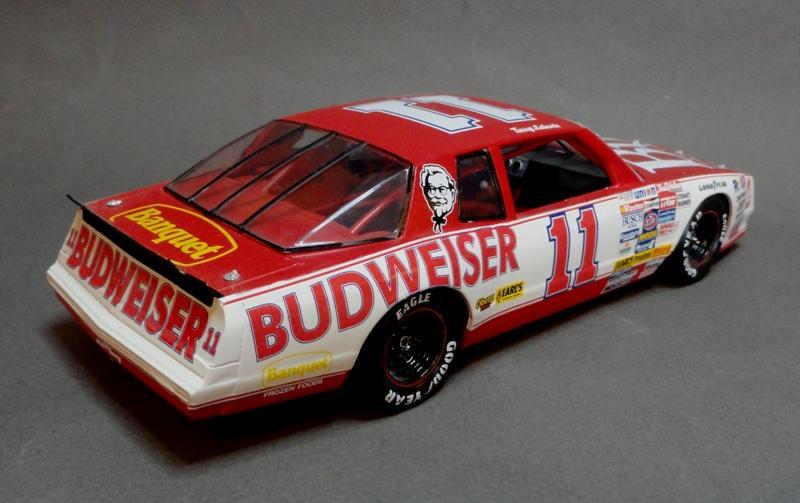

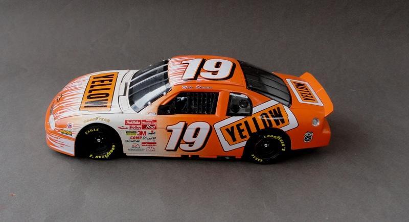

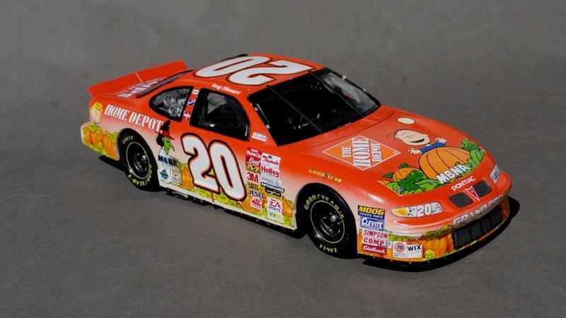

Lacquers can be used on Nascar models as long as a suitable primer is laid down beforehand. I use Duplicolor primer, have never used the Testors primer you purchased. The metalizers can be used without primer.
Here are a few examples of what can be done with lacquers ........ metalizers work great on engine parts
Thanks Old Coyote, I appreciate the reply and pics. These are the things that are kind of confusing as what can be used with or over what. I guess when I was a kid i just slobbed whatever I could find on them. Those pics are great! I love the Yellow Mike Skinner car, Can't even imagine how hard that must have been to paint. I painted my first model in a long time the other night (Testors dark blue gloss spray can) and had to completely sand it down because it looked like crinkle paint. Thanks again for taking the time to respond and sharing those awesome pics. Hopefully I will be able to build one of that quality at some point.
