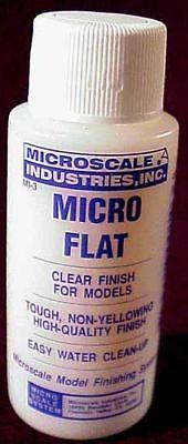

Tommy Isbister Posted January 28, 2016 Posted January 28, 2016 If I need a super flat finish I use micro-scale flat. Less than $4.00 a bottle.
retired & glad Posted January 28, 2016 Author Posted January 28, 2016 If I need a super flat finish I use micro-scale flat. Less than $4.00 a bottle. Thanks Tommy I'll see if I can find some of that. Where do you get yours?
Tommy Isbister Posted January 28, 2016 Posted January 28, 2016 Thanks TommyI'll see if I can find some of that. Where do you get yours?I usually order from ebay or amazon which ever I find with the best price at the time.
