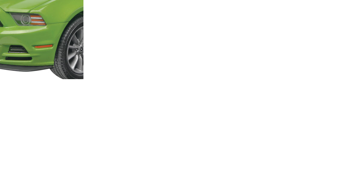

buildnething Posted January 28, 2016 Posted January 28, 2016 What are everyone's tips on how to achieve an accurate side marker, where an actual clear part is not provided! Like many of the 70s muscle car kits, the body has the side marker molded in the fenders. Just wondering how people go about doing this.Examples!
